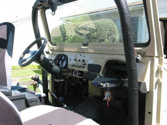

You have any pictures you can post up?
Here's Some Pics, Hopefully You Can See The Rollbar Somewhat..
