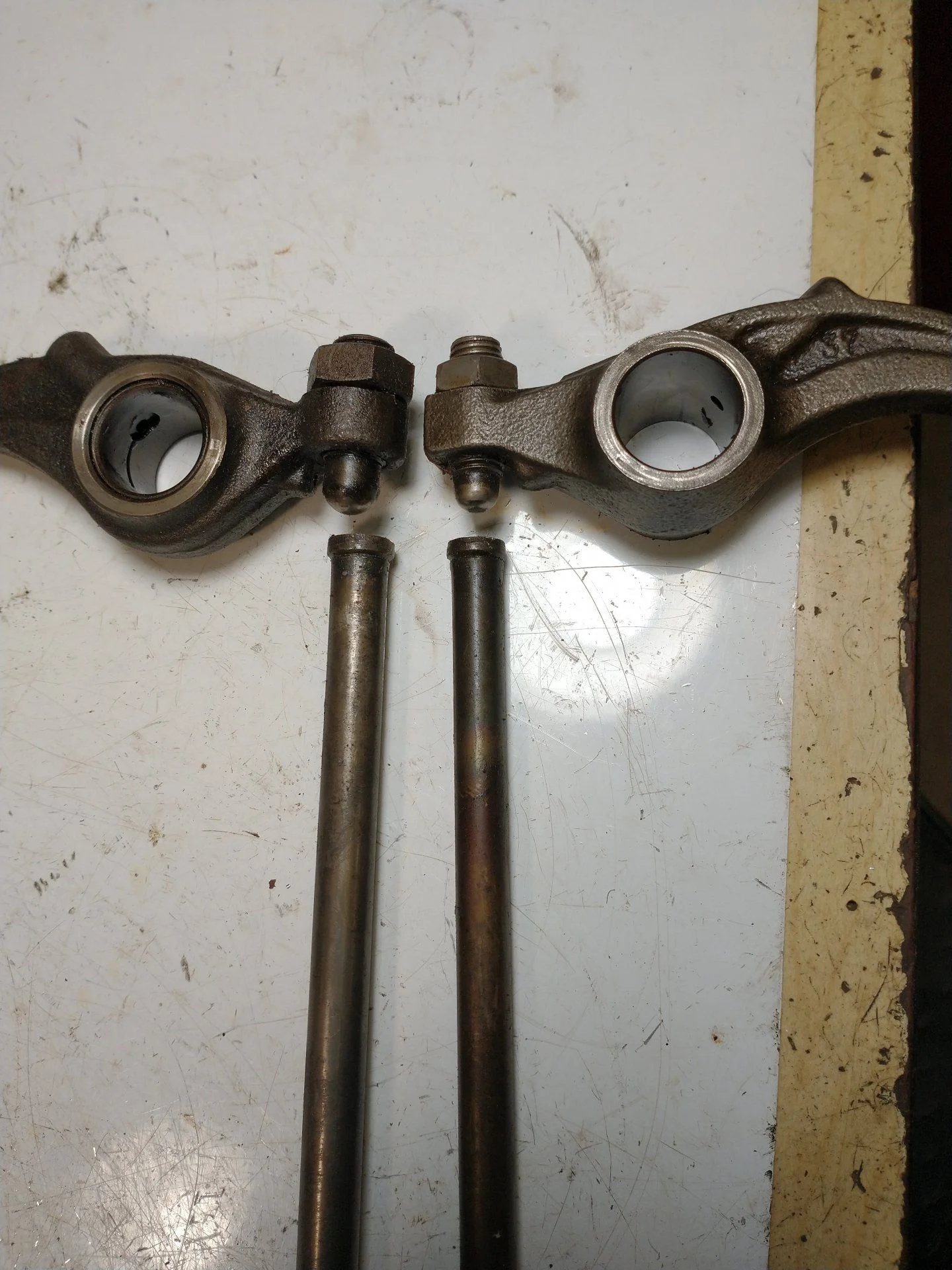

Yes, they can be interchanged. No difference in rocker ratio. The only catch is the pushrods change, because the adjuster "ball" gets smaller and the pushrods cup gets smaller in 198x?.
Pic shows 1976 rocker & pushrod and early 80s parts.

The later rocker arms (on the right in pic) are cast steel, without a bronze bushing. They are lighter, stronger, quieter. Best of all, they finally got the metallurgy right, so even without a bushing inside, they don't seem to wear.
Get a used later model rocker assembly and pushrods, install on early 2F, enjoy the quieter & more accurate valve train.
