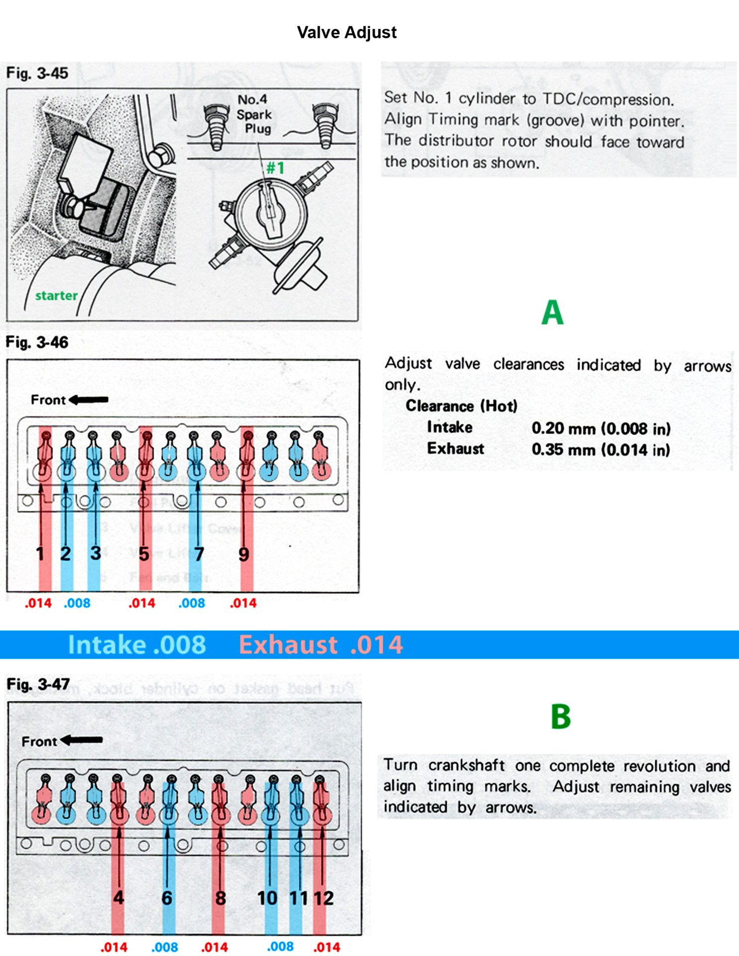

Are you adjusting the valves hot?
they need to be

@Beehanger
they need to be
forgot who originally posted this.... maybe pinhead or fj40jim
View attachment 3927938View attachment 3927938

Set the clearance cold.
Run it to bring it up to temp.
Set the clearances again to spec.
Then check everything again.
Rinse, repeat.
Enjoy.
Rinse, repeat.
Enjoy.
This. Cold setting won't be far off from a hot setting, and close enough that the 2F will run good enough. Set them cold, drive it for 20-30 minuted to get it hot, then recheck and reset the valves.

Redid valves after a 30 minute drive, did them hot. Almost every rocker arm had loosened, two of them stayed the same, none tightened. two of them loosened as much as .005, and one loosening a whopping .01! I had them all right so wasn’t user error. I had the screws very tight too.

Did the valves again, this time hot. Only 2 valves were off this time, so my prior theory that that the engine was accepting the new rocker seems to be correct, and things were wearing in.
Number 12 and number 9 are still stinkers. 12 was off .004, was loose and 9 was off .003.

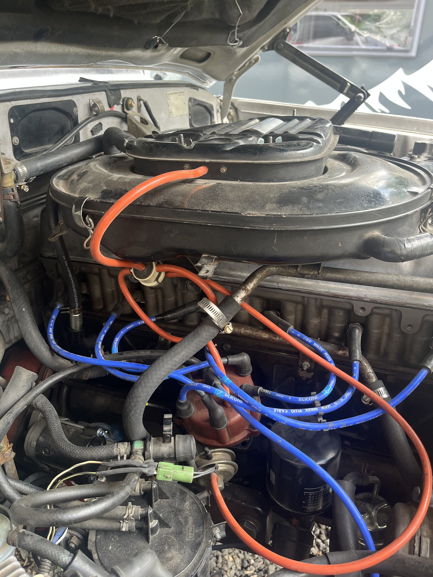

I took a video of my current setup so you can see. The dizzy I have came with the truck. Like I said it’s not hooked up to the manifold vacuum (see video)
I’ll advance it a bit once my leak is fixed, my biggest goal is to get compression up right now. I just don’t want to cause detonation on my drive home today with the intake leak. I’ve got the JToutfitters header and I can’t get it to seal after 4 tries, may try the copper RTV trick as a last ditch or tinker with the stock manifold (which I have tried before, and it leaked, so will need machining for sure, PITA)
