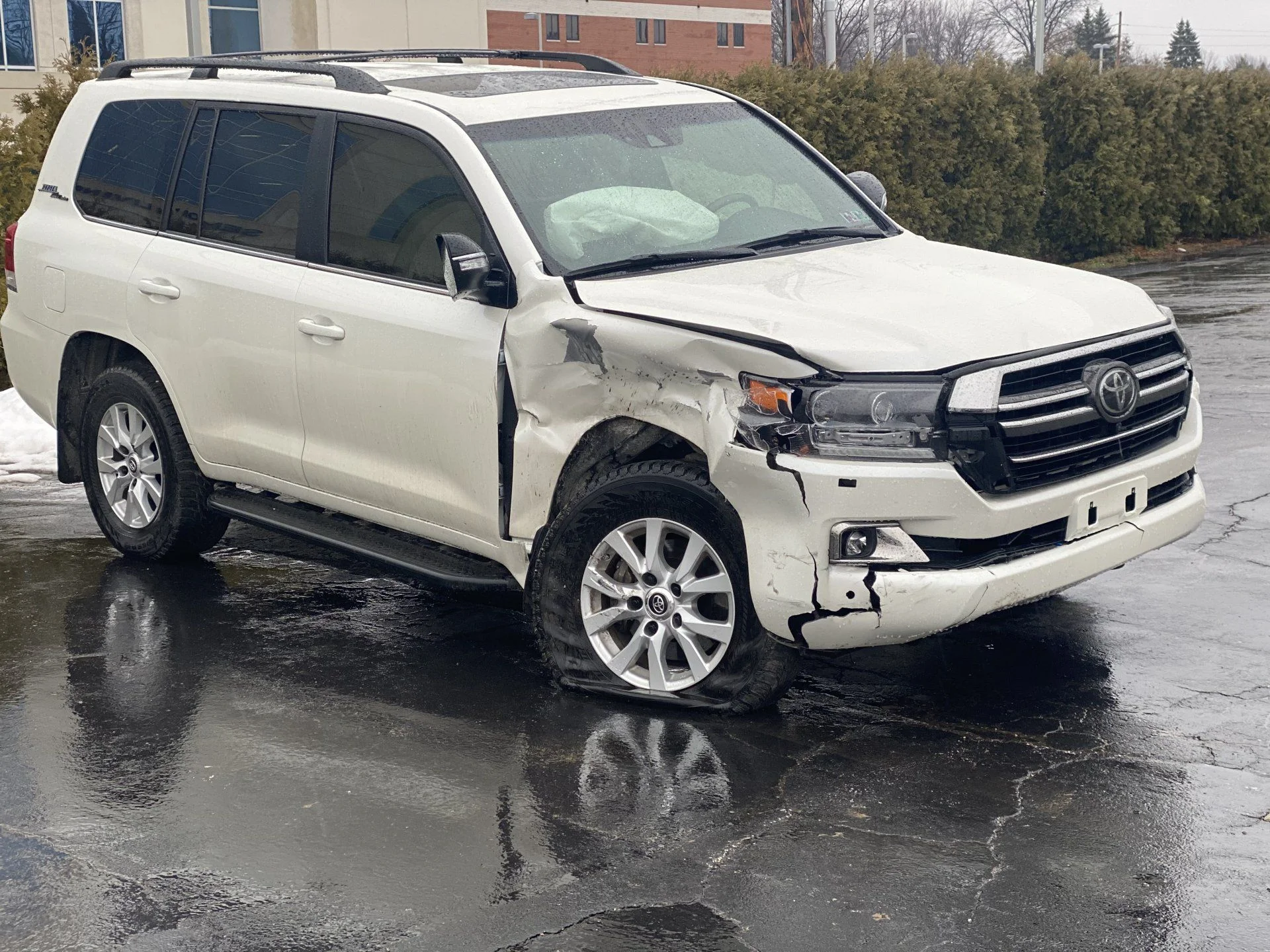

I was hit by a drunk driver a few days ago. They missed the bud built sliders so I can’t speak on if they would have helped or not. All airbags went off and car was totaled but my whole family including 3 little ones were fine except for a few bruises here and there. Hunting for a grey heritage now, and will definitely purchase another set of sliders from Buds.

I was hit by a drunk driver a few days ago. They missed the bud built sliders so I can’t speak on if they would have helped or not. All airbags went off and car was totaled but my whole family including 3 little ones were fine except for a few bruises here and there. Hunting for a grey heritage now, and will definitely purchase another set of sliders from Buds.View attachment 2546311
Glad your ok!! That’s what’s most important!
Did insurance pay out for the sliders or can you take the ones you had off and use them on the new ride?
Yeah it was quite the experience, and let me be perfectly clear in this. Watching a car smash into yours, feeling the hit and the pop of airbags, followed by disbelief of what happened, straight sucks. This being followed by the fear with having to turn and check on your wife and kids. But that relief of seeing that no one is hurt and people that matter most are perfectly fine, is breathtaking.
I bought our land cruiser for reliability and safety, and am happy to share that I made a good choice. Hug your kids, take care of your vehicles and carry on bravely.
The insurance paid $150 towards them, even though I explained that they do not normally come with the vehicle and offered receipts. I was told that I could remove them but there were unable to move it into a garage and onto a lift. I suppose I could squeeze under there and take the time to remove them, but they are so secured to the frame that it would have taken quite some time to do so. I figured I can take the loss and order new ones. I have already reached out to Bud's and spoke with Rob who has been incredibly helpful in getting me set up for a new pair. I was lucky and was able to order a new grey heritage from Toyota of Erie and will have it in February.
