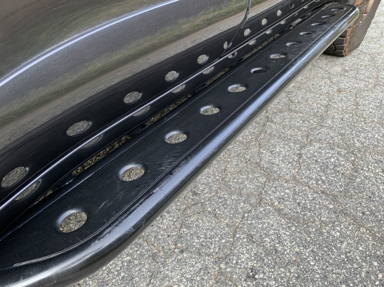

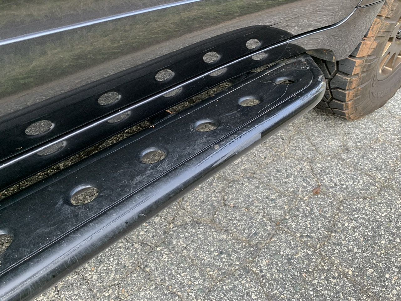

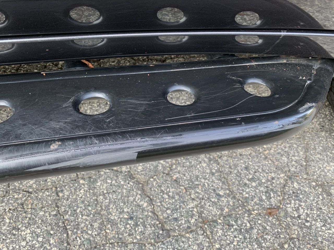

My truck has BudBuilt rock sliders on it and I put myself in precisely the type of situation you’re referring to. I was squeezing between 2 dump trucks and, well, I ran out of room. But hey, sometimes when you’re chasing down overnight parts from Japan for Race Wars you gotta take chances 😆
I ran nearly the entire length of the slider against either the corner of the stop bar under the bed or potentially a protruding wheel stud, I’m not sure. Point being, other than it making some horrific noise, the truck came out unscathed and the slider no real worse for the wear other than a gouge that removed the powder coating and a minuscule amount of metal. I touched up the slider with some Rustoleum in a satin black, which is a close match for BB powder coat.
I have little doubt that BudBuilt sliders assist in protecting from body damage for the type situation you’re describing assuming we're talking about dent, dings, bumps and not Jimmy Spencer levels of NASCAR destruction.
My sliders saw a lot of use on the trail (helps if you open your eyes while you drive as opposed to pointing and praying, oh well) so you can see other imperfections from trail fun. Here you can see the initial hit on the scuff on top of the radius of the tube’s bend. The partially painted rub mark is from an off-road adventure but it also shows how the Rustoleum paint is a close match to the powder’s color.
If you have any other questions, let me know. I’ll freely admit that I’m a biased BudBuilt supporter... because they’ve earned that support.

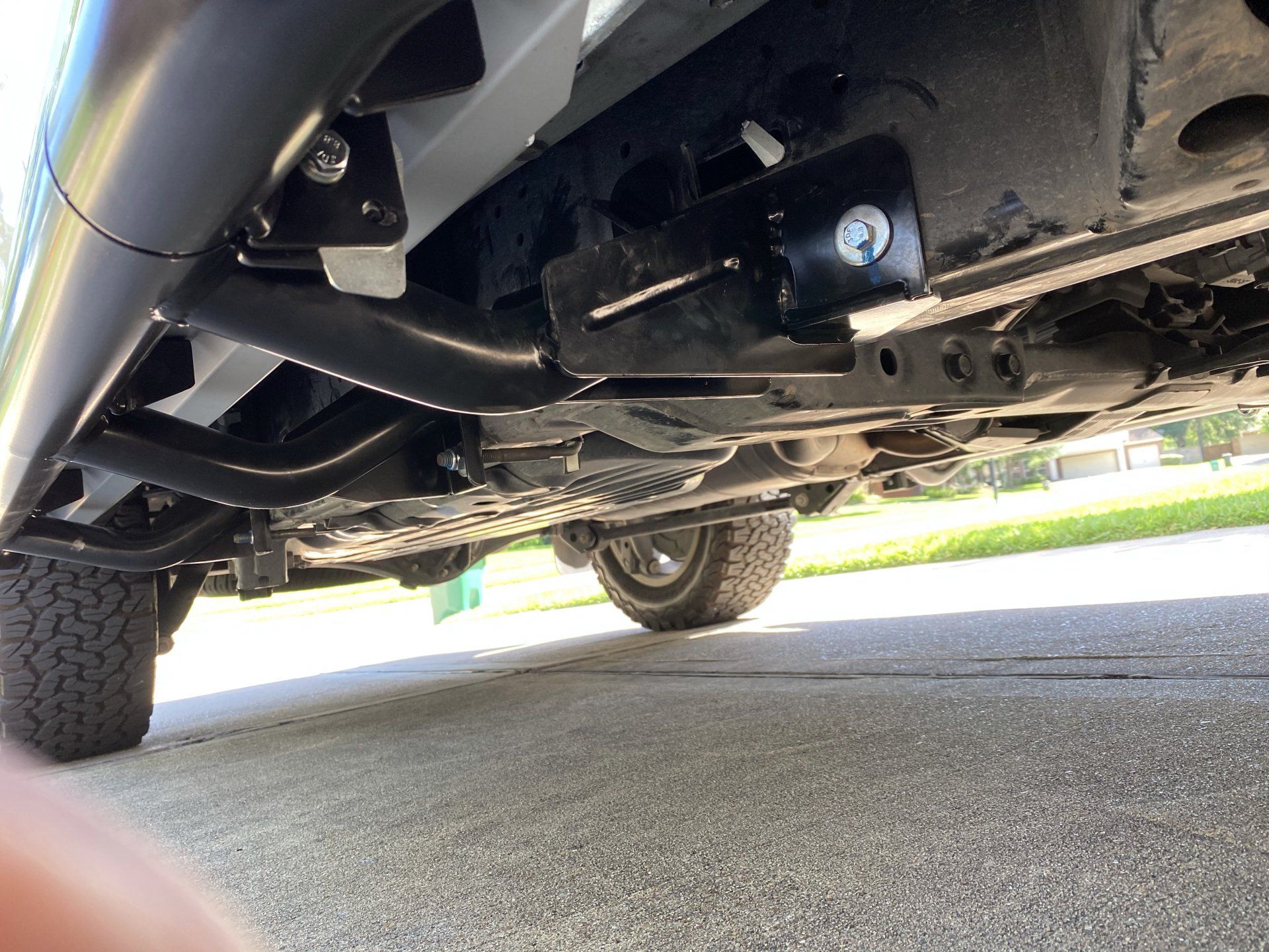

Unless White Knuckle changed the design of their sliders, you do have to drill. I run White Knuckle sliders and had to drill at least 6 holes on each side for the bottom side of the L bracket to bolt into the frame. Price point of the White Knuckle sliders is great, and they've done me well so far.

I highly doubt it, it’s most likely ARBs very common design style of giving a ton of space between things. That way it can be produced much faster, with looser tolerances, and not having customers complain of rubbing.
But, let’s say that was their intent. As we all can agree, and legit T-Bone at 40 mph will take out any truck, regardless of sliders. But if those ARB sliders took a straight on side hit from a backing up truck or a concrete barrier that someone got too close to, the ARB rails are shaped to bend into the doors. Then with that front mount only half way up the frame rail, the top edge of that mount is what will press inward. They should of put that mount to the top of the frame rail, where there is a 90° bend that offers an incredible increase in strength.
This was super common when the FJ Cruiser came out. Lots of people where making sliders with frame plates that when half way, or 3/4 the way up the frame rail. Then under modest hits, the frame rails would bend inward (the sliders never bent though), and companies started going to the top of the frame rail real fast.
