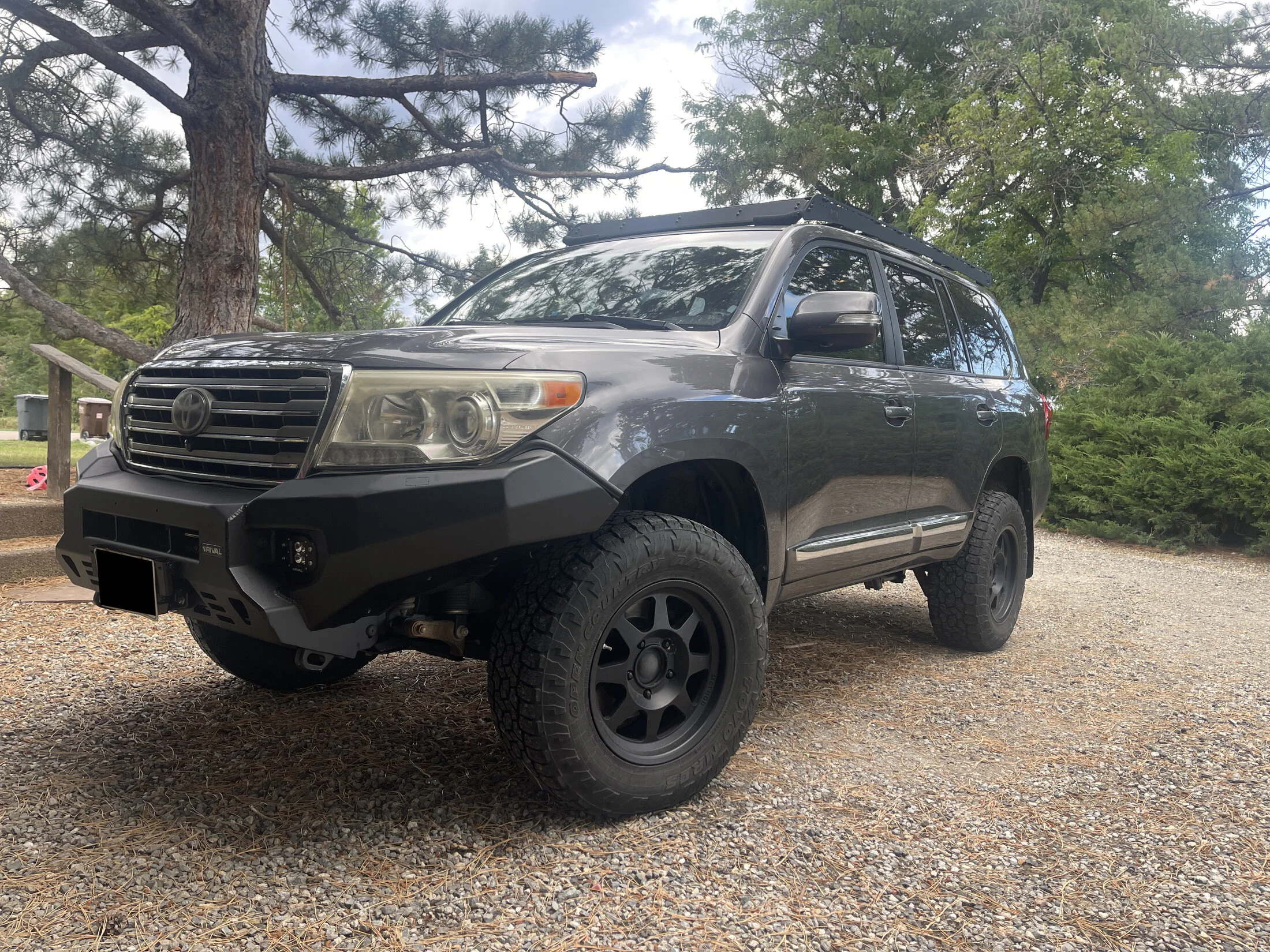

I have now had the bumper for 3mo. So far so good. I had it installed at ToyCrawlers in Broomfield. They did a great job. Overall very happy with it. The aesthetic is great and the truck feels lighter than the piece of **** Viper Bumper I bought it with. My only gripe was the rubber seal that sits on the top edge. That is crap. It does not fit well and does not want to stay on. I used some black liquid silicone to tack down the corners. The seal that came with my bumper was warped and the company would not replace it. I am working on a better solution for the gap between the bumper and the grill. For half the price of the Slee bumper it is very good.
