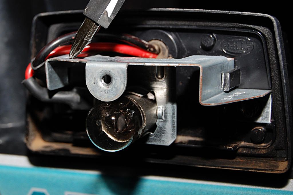

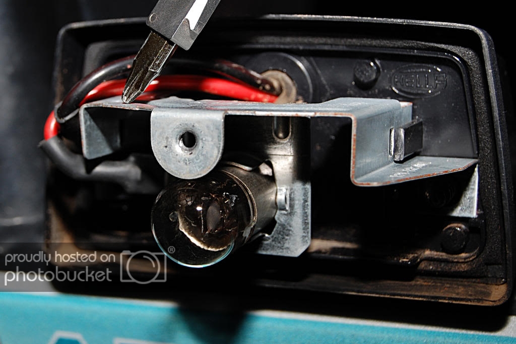

Pulled the license plate light housing off as if replacing the bulb, and found that the power lead had gradually worn through the insulation on a steel mount, probably exacerbated by action of the flexible nature of the Slee spare carrier - every time it's opened or closed, it places stress on the wires headed into the license plate frame. I used some shrink wrap to better insulate it, and reran the wire around the side of the metal frame, so no chance of it happening again.
This picture shows new wires routed around the side of the metal frame. Screw driver points at where the short was.
