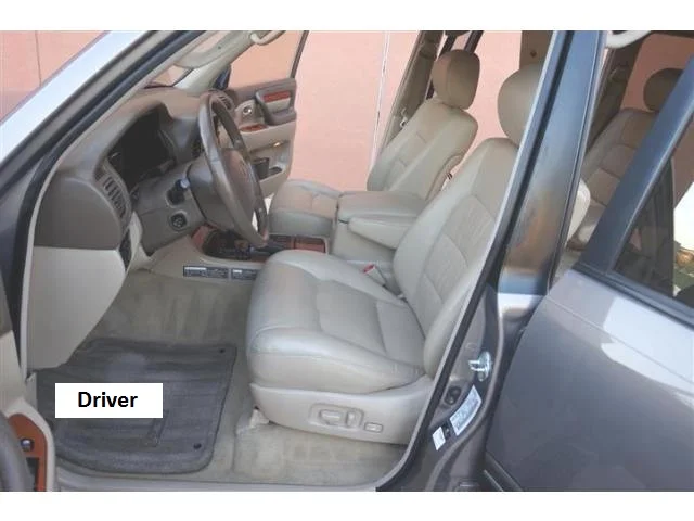

I have a 99 LX470 with front seats that I want to recover before they get any worse.
Those of you who have used the 'Ridies' product for either a Land Cruiser or LX470 with IVORY interior. (If another manufacturer is better I am open to that).
Which leather color did you settle on (to best duplicate the OEM)? I have samples....but I am undecided on which is the closest match. Often times a small swatch/sample looks completely different than a large amount of leather (full seat).
Any suggestions or pics of the color you used would be greatly appreciated. I am ready to order and need to decide.
Thank You in advance.

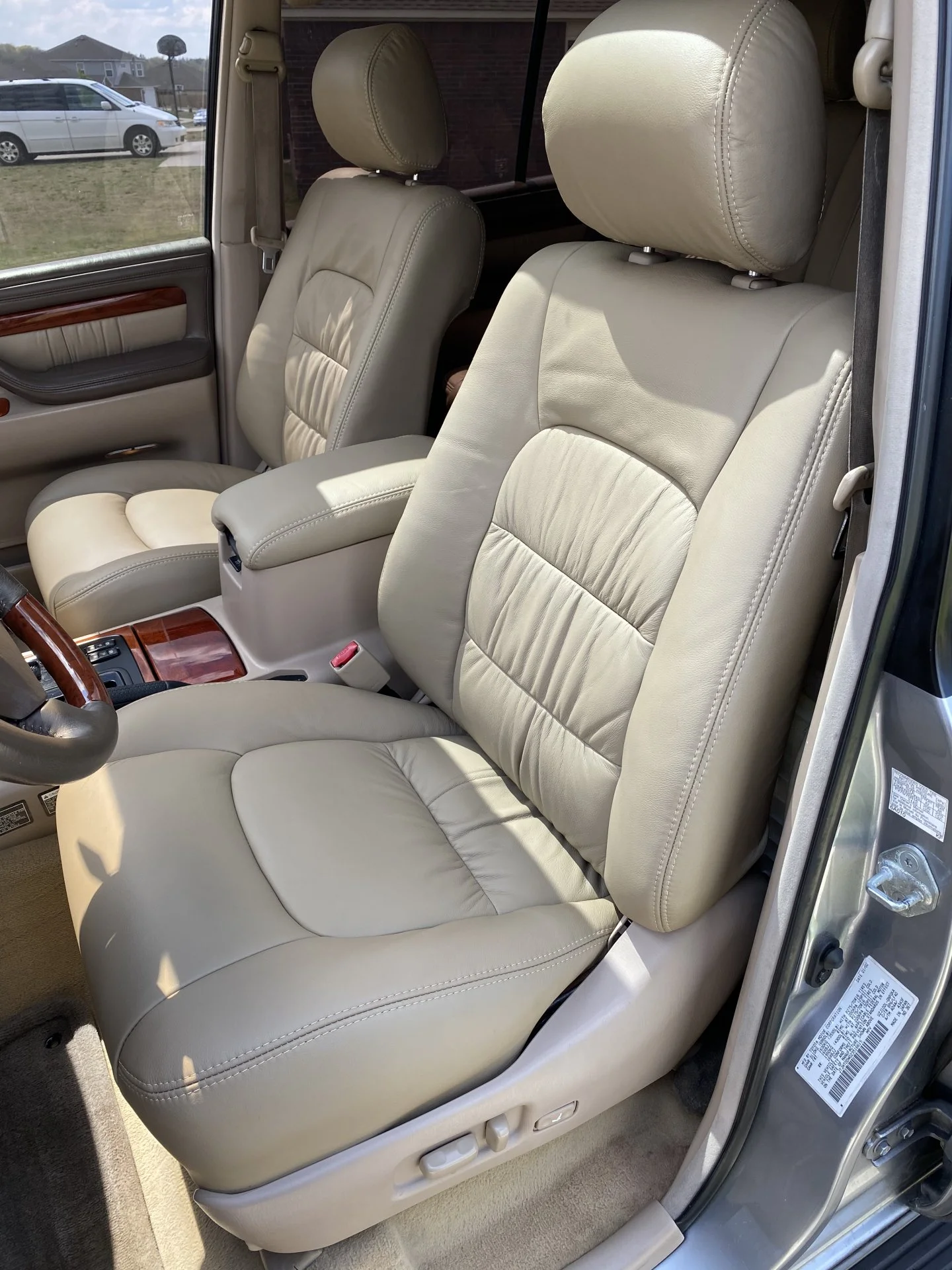

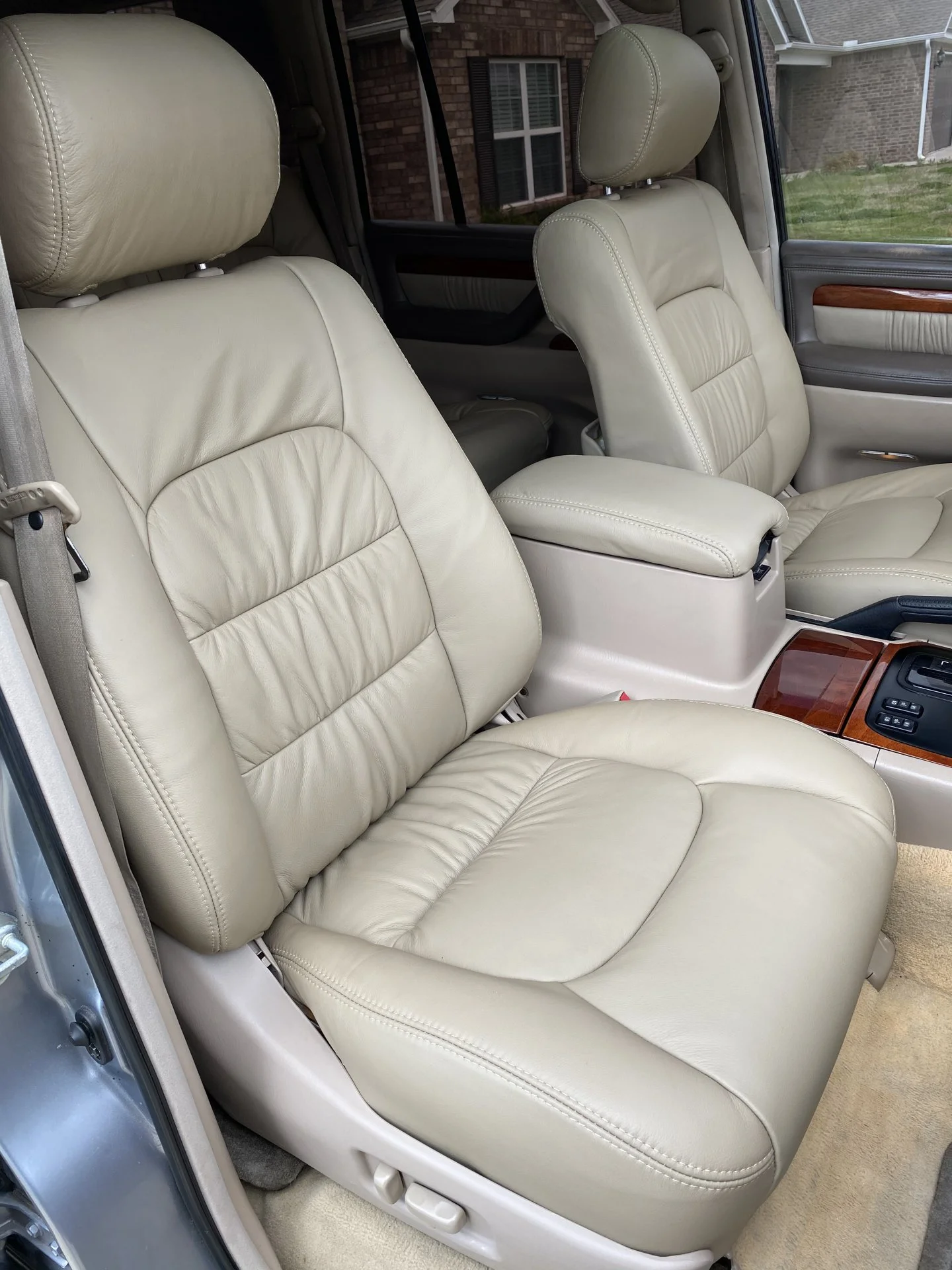

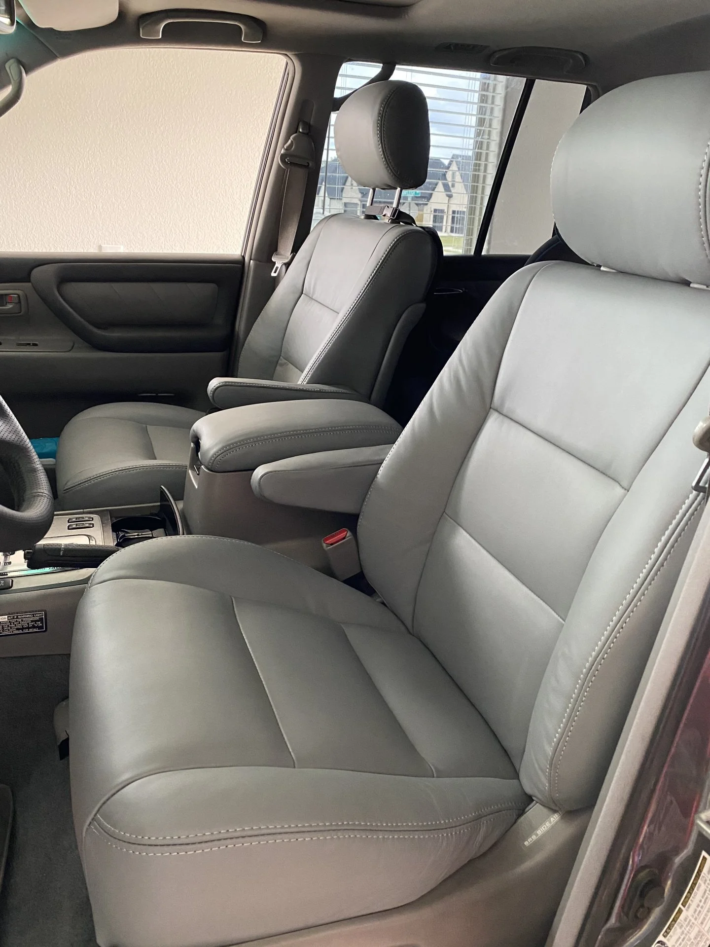

Closest match to OEM is “Light Tan”.
Very nice! Did you install yourself or had a shop handle that? How much did the shop charge, if you went that route? Does @Ridies still have the issue with the plastic clamp thingy at the back of front seat being too short?
I let the shop install seat leathers and mass backed carpet. About $500 for the seats.
I’m not sure about the J channel this time around. It’s pretty easy to swap from your current seats.
Excellent. That is what I had pretty much settled on as well (light tan) and it looks to be a decent match. Thank You for taking the time to post the pics and confirm the color. It is a big help to me and others. Now I can go ahead and order....confident what I thought was the closest.... is in fact correct. 👍 Looks like you went with the 'wrinkled' option?

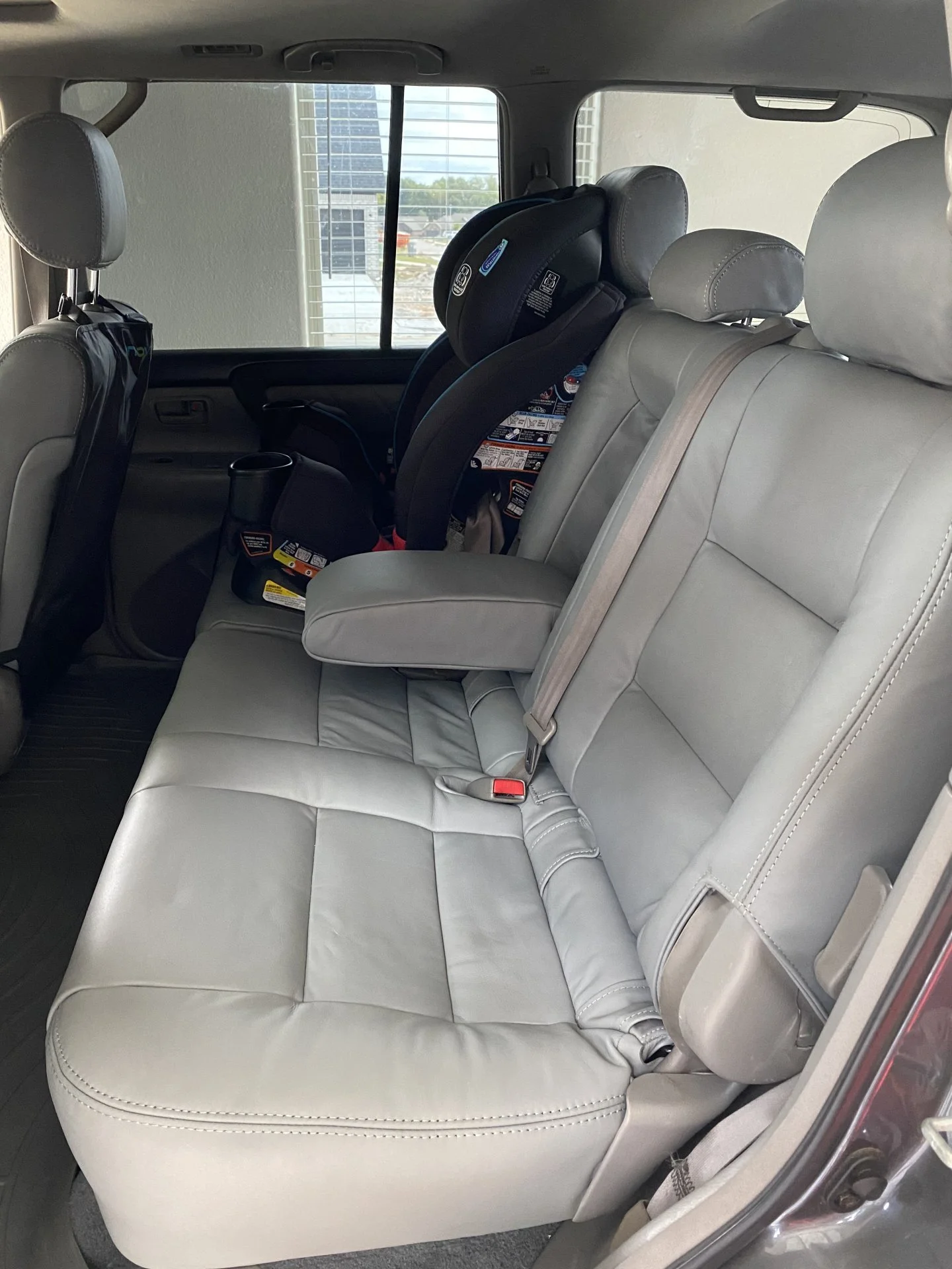

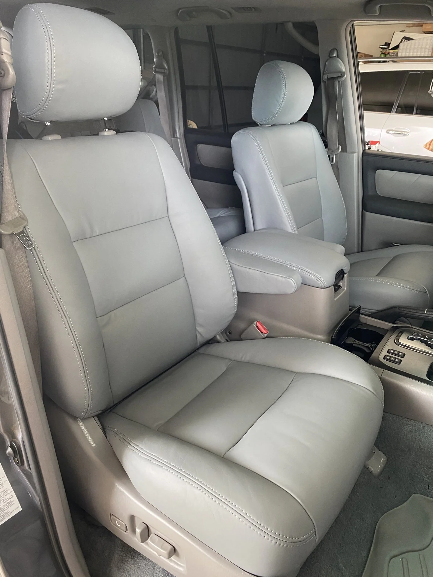

Yes, I went with “wrinkles” and genuine leather for my previous LX but wasn’t too happy with how it turned out. So with my current LC, decided to go with Nappa and no wrinkles. Love it!
PS: Ridies leather quality is great but their service sucks. I hope y’all don’t have to deal with them and get a good and complete set of leathers to begin with.
The picture you included is wrinkles in the LX version right?
How is the durability between the Genuine and Nappa leather? I have a dog so slightly concerned with the wear.
LX had the genuine leather in Light tan with wrinkles. Unfortunately, I sold it not long after I had the covers installed but I believe Genuine is more durable than Napa.

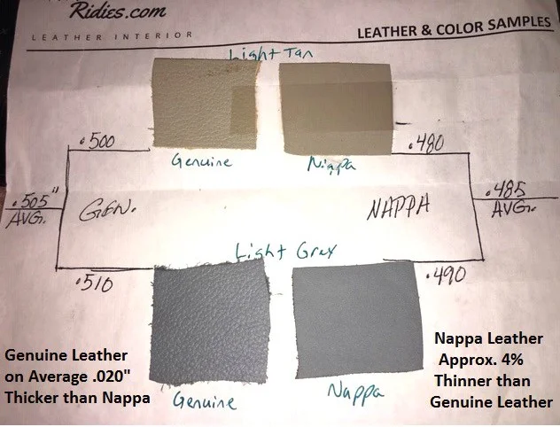

I am going to measure each later on and report back. I have a few samples of each and can take an average. Just looking at them...the Nappa appears to be thinner leather. What I am most concerned with is the quality of the leather and the stitching. My OEM is not cracked but is starting to pull apart at the seams.
Oddly...on my 80 Series the opposite is true, the seams have held but the leather has dried out and is cracking. It doesn't help that I live in the Sun Belt. We don't have rust here....but we pay a 'Sun Tax' in the form of faded paint, degraded plastic parts, dry leather upholstery.
Edit to add:
Measured the two Ridies samples I have of 'Genuine and Nappa' leather for thickness.
Not a lot of difference.....but the Nappa is clearly thinner. On average .020" thinner than 'Genuine' or roughly 4% for those that like it that way. I don't know what (if anything) that means in terms of durability due to thickness.
But apparently 'Nappa' leather (if that is really what you get from Ridies) is 'Top Grain' leather, supposedly more supple and durable due to the hide selected and the tanning process.

Your front seat looks pretty good. Are you looking to put a cover over it to protect OEM seat leather or looking to replace it because it’s starting to pull apart at the seams? A good upholstery shop should be able to stitch it back like new and I would highly recommend going that route instead or replacing it. TBH, your seat leathers look too nice to be replaced with aftermarket leather.

Ahh, I'm an idiot. I missed the fact that you posted both the pictures in this thread. Makes so much more sense now. Thanks for clarifying.
Going to replace. The stitching at the seams of the bottom of the seat are starting to separate. The leather now has a semi-dry, hard feel to it. It's time for replacement.
They appear nicer than they are....but they've seen the end of their useful life IMO. I'll just replace them...then routinely 'condition' the replacement leather. My second row and rear seats ARE in excellent shape and do not require anything at this time. But the fronts need to be done.
