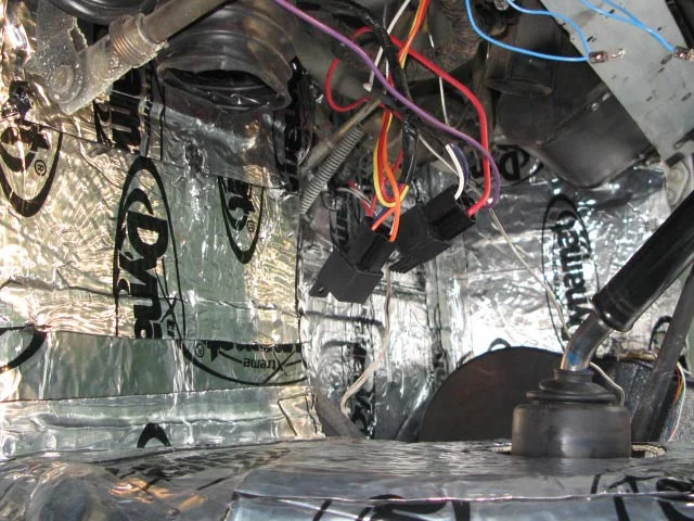

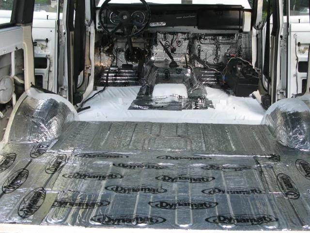

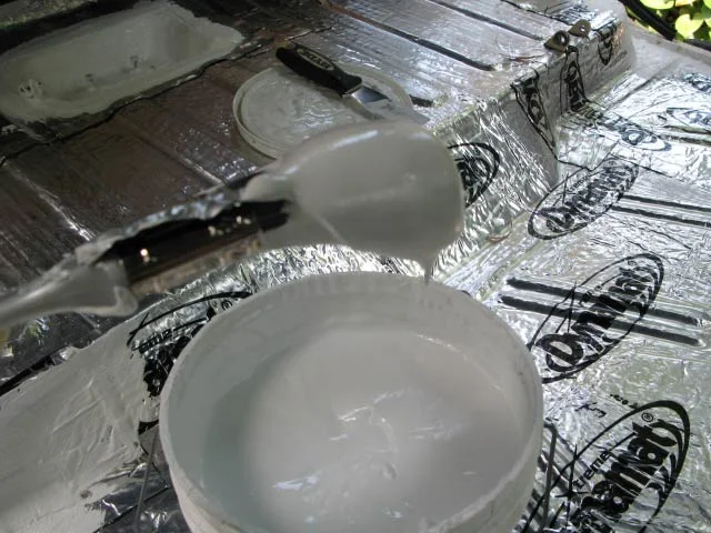

But before you line it have a game plan for the interior... sound deadening, heat shield carpet etc. I had my 55's interior and engine compartment Speedlined but you could still feel the heat. So I covered the Speedline with Dynamat, Second Skin Firewall Ceramic Sludge and then shot Second Skin Spectrum Sound Deadening over that. And have considered have it re-lined for a finished look. So game plan before you spend the money.
Lou
Messy!
The sludge wasn't that bad, because it was brushed on, now the Spectrum was really messy, it was shot on with a undercoating gun. This coating will except a bed liner.

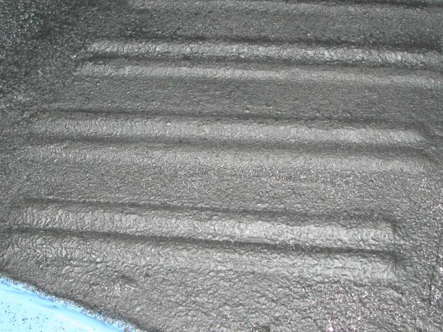

I will not have it Speedlined, speedliner retains a very strong and wierd ordor and was shot Dec 2006 so I may just go with Durabak and shoot it myself.
Anybody know if Durabak has a odor after it drys?

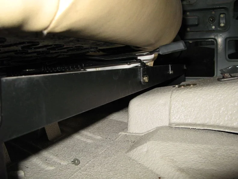

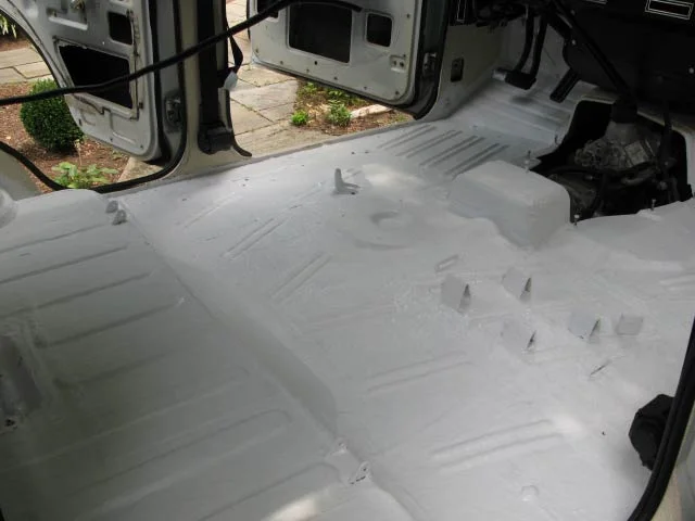

Here's some LINE-X pics.
Before: This is special LINE-X XPM primer:
After:
Before:
After:
Before:
After:
Before:
After:

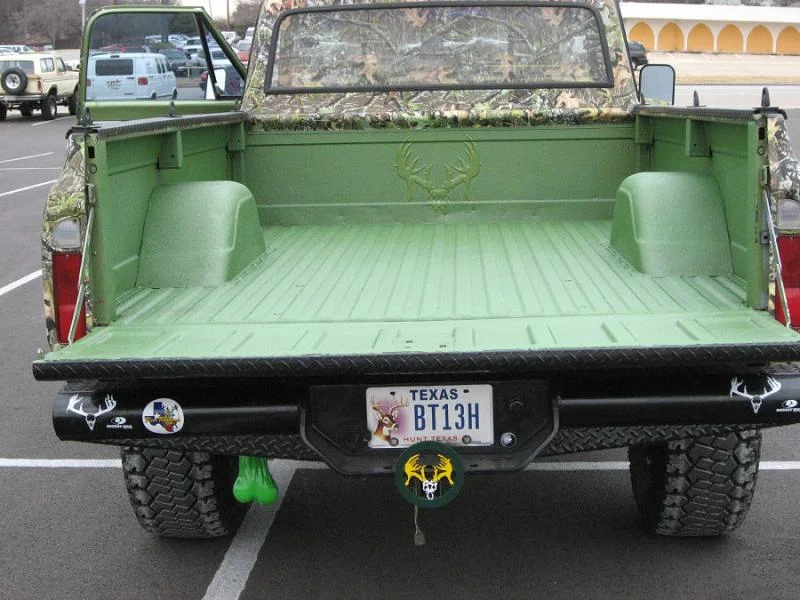

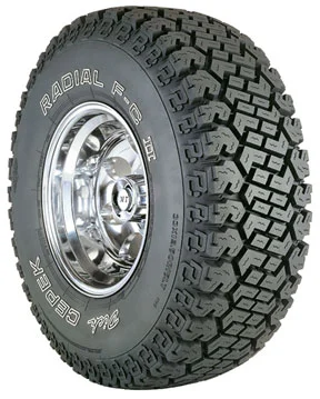

Cruzin90, I have a crazy question, just visited your site, you guys do great work. There is a picture of a pickup Hunting truck with a Green bed, do you or anybody know what brand of tire he's running. Looks like a good combo, on and offroad,
Lou
Luke111 knows his tires!
Here are some before pics of that green truck. The owner picked the bedliner color.
