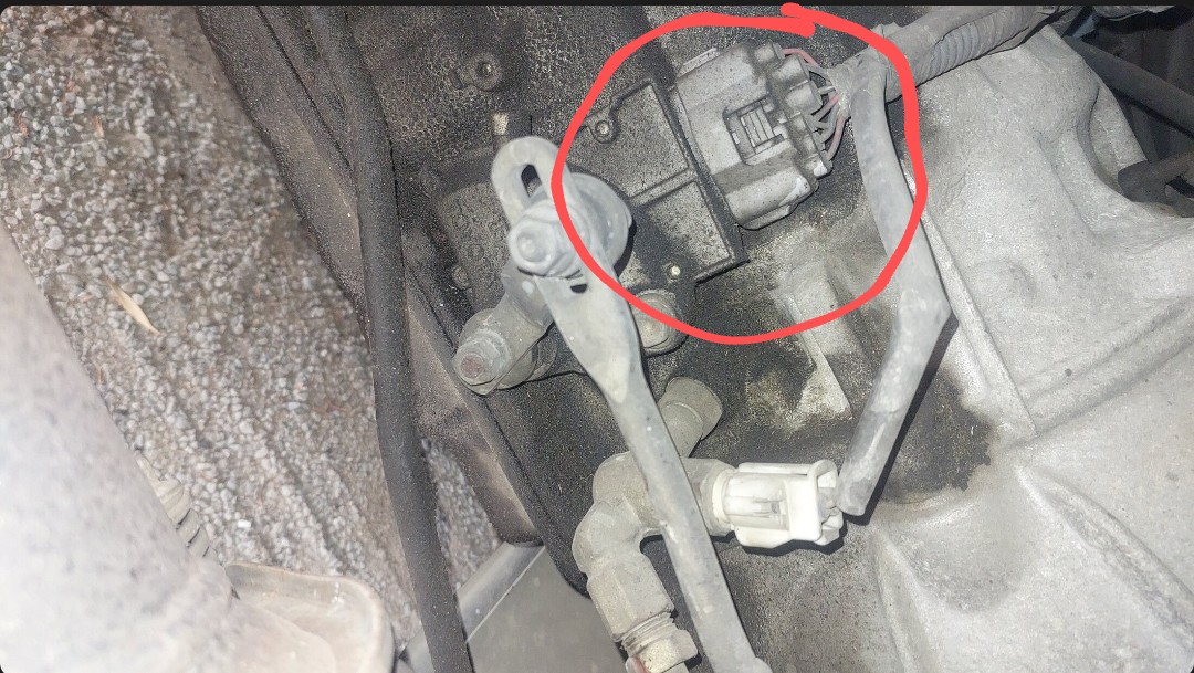

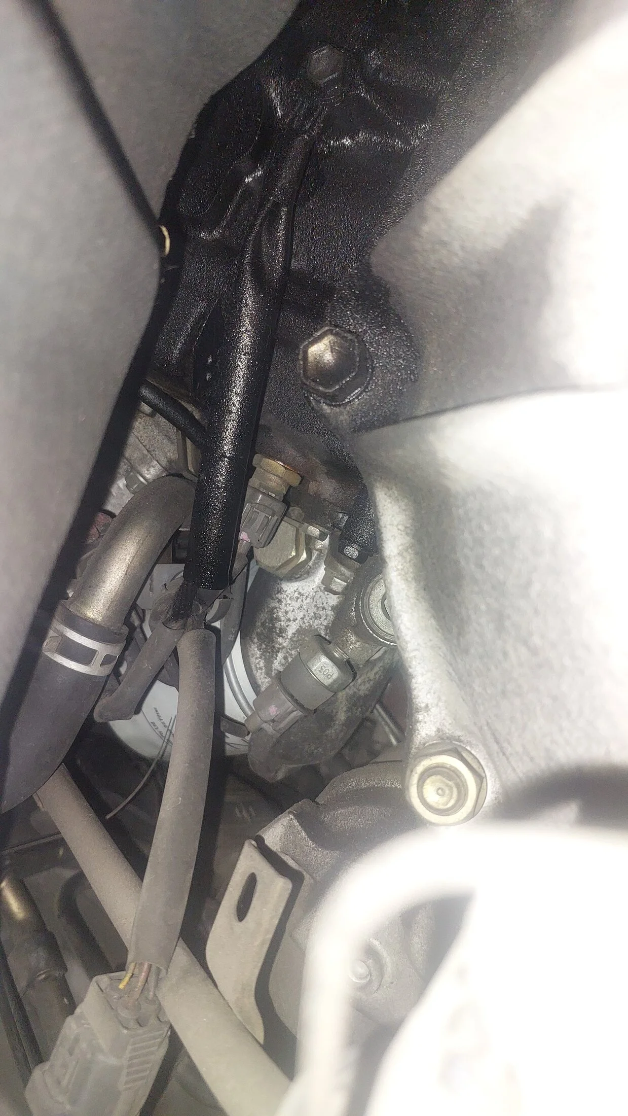

I've removed some trim and had a look under the shifter but there doesn't seem to be any switches or relays under there. I might be missing something, will have a better look . I should ad that I've blown the same fuse in the past and fixed it with replacing the reverse bulbs. Not so lucky this time.
Any of these look promising? I do now realise I have an oil leak to tend to🤣.
this is the the PRNDL.
typically the reverse wires are the red ones.
unplug it. remove the reverse bulbs and check the wires for short to ground.
Oh ok so there is no screw in type switch on the gearbox, that is making a lot more sense now 😅. Thanks so much man, I'm going to do what you suggested and hopefully get some result 👍.
