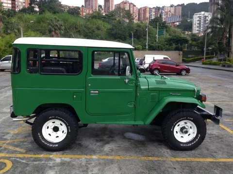

Let's set aside the roasting in cartagena sun trying to get papers for shipping and post some final photos of Esmeralda. The Colombians who have seen have been amazed. I feel very proud to have achieved this here. I can't wait to see what the gringos say back home.

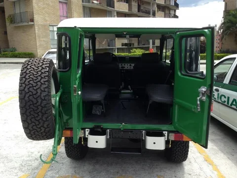

I ended up paying a specialist to lower the front suspension a bit. she sits perfectly level now.
we fixed the bad float in the carb. she starts right up and idles quietly. had a valve job too. radiator was recored but had a small leak. we fixed it.
plenty of small items i need to order back in the USA but she is 99% done.
Motor is detailed. everything under the hood is new or rebuilt. everything polished.
I blew the budget on mechanical. I think I was a little naive about the costs.
FYI battery gets replaced with new.
all new belts. all new accessories water pump etc.

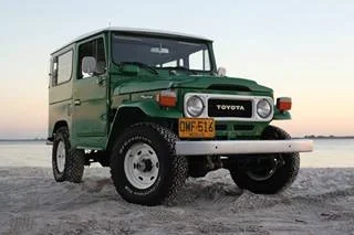

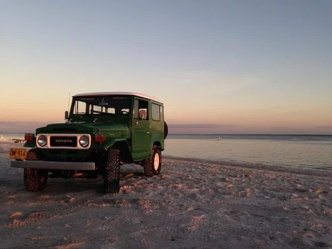

Esmeralda's first trip to the beach I think ever.
I have owned some fancy cars before but this truck gets more attention than anything I have ever driven. People are falling all over themselves to talk to me about it.
I think they are pretty rare in Florida.
