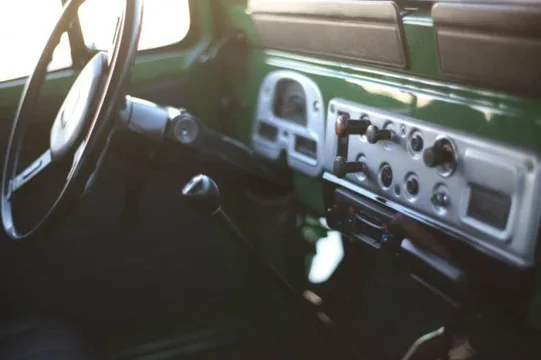

FYI thanks to the guys that recommended the smitty built console. fits tight but fits very well. I had the interior guy cover the smitty yucky armest with the same nice vinyl we used for the interior.
for a tall husky driver the twin buckets and the arm rest is really comfortable.
so if anyone is thinking about saving a few bucks and going with the smitty built it works perfectly. Plus I was able to just pick it up at a 4wheelparts.com store.
How badly I want to install a 1980s looking CB in the radio slot!!!
FYI the cupholders are nice too.

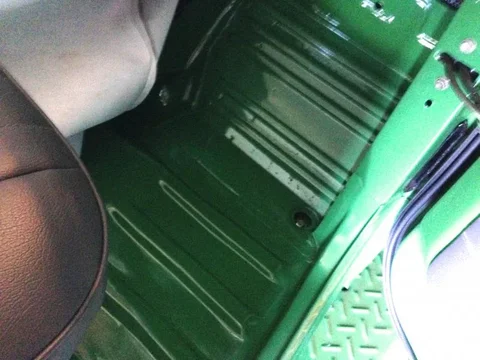

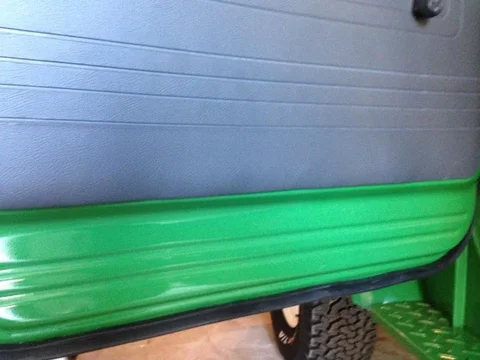

Left footwell repaired. The doors never had rust but dents were repaired and then primed and painted inside and out.
For those guys looking to buy a unrestored Cruiser the weak areas prone to rust seem to be the door bottoms, the front footwells and the rear sill of the tub. I looked at over 25 cruisers and saw ONE unrestored one without rust. This one was a medium to above average quality one before we started. seat frames were cleaned up and repainted too.

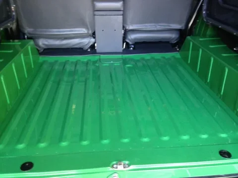

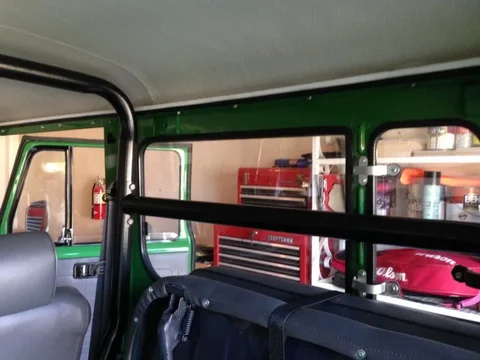

My favorites so far are the interior in general and the headliner install in particular and the custom roll bar. The rear four passenger set up is great. Took nephews and family to the beach and took 5 people on a ride during Thanksgiving.
Funny bec I have plans to do an FJ43 but this FJ40 with the 6 passenger set up is really growing on me and my brother. I like how you can park it easily at the beach yet in a pinch pile in 5 passengers for a short trip.
