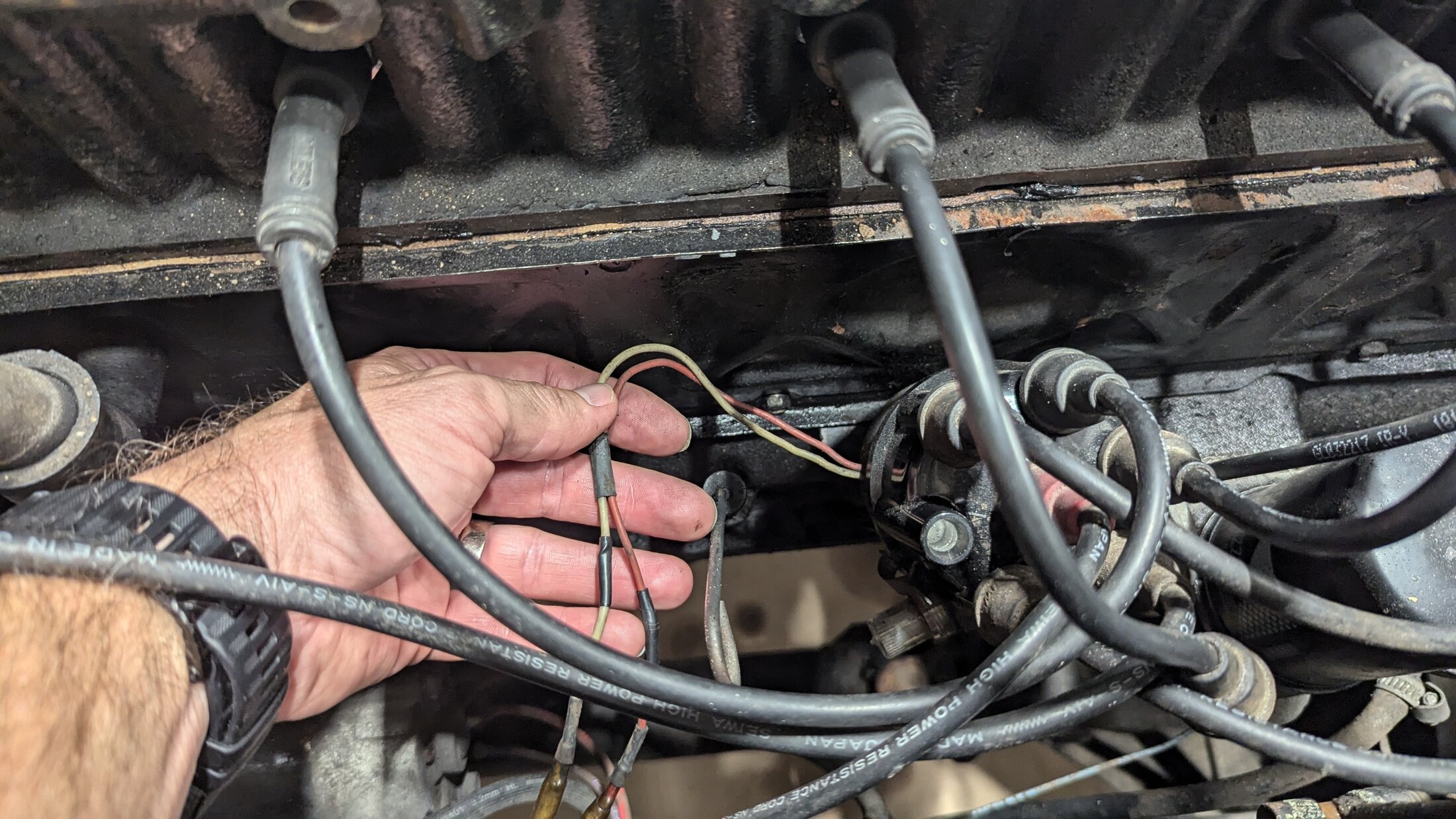

Spark plug issue and "fire-up" identified. FJ Patrons, after some patience, reading your helpful guidance, and doing some due diligence (along with several trips to Advanced Auto and O-O'Reilly) I traced back my steps once again. Both of these wires were bare and crossed. I cleaned them and rewrapped them. F2 engine fired right up. More testing tomorrow to make sure all is good.
