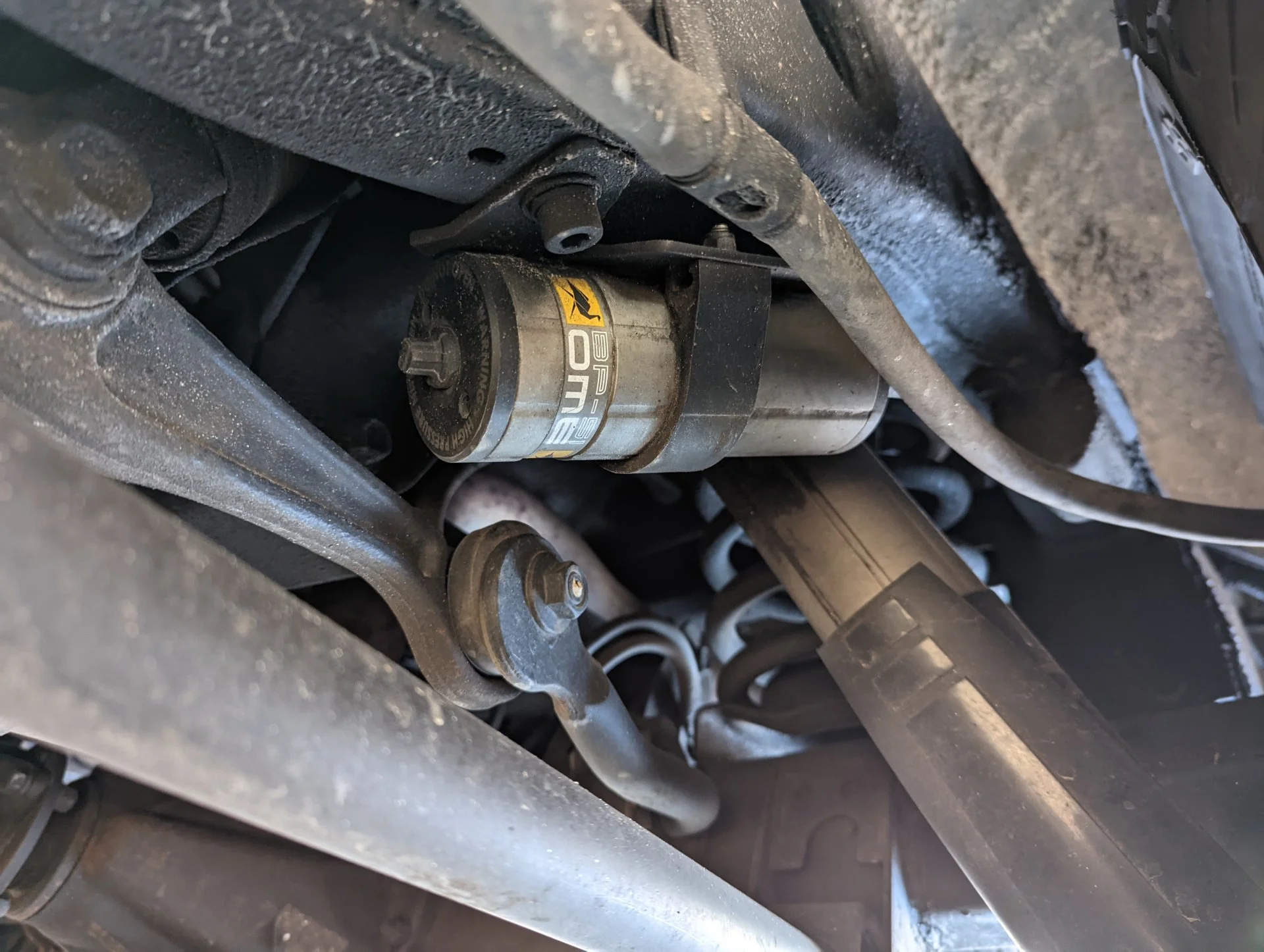

Hmm... OK, thanks. Mine are pretty much dialed in now, but I'll definitely try that next time I want to change them. I just crawled under and looked, I assume you came in from the front?
Snapped these today
Drivers front:
Drivers rear:
