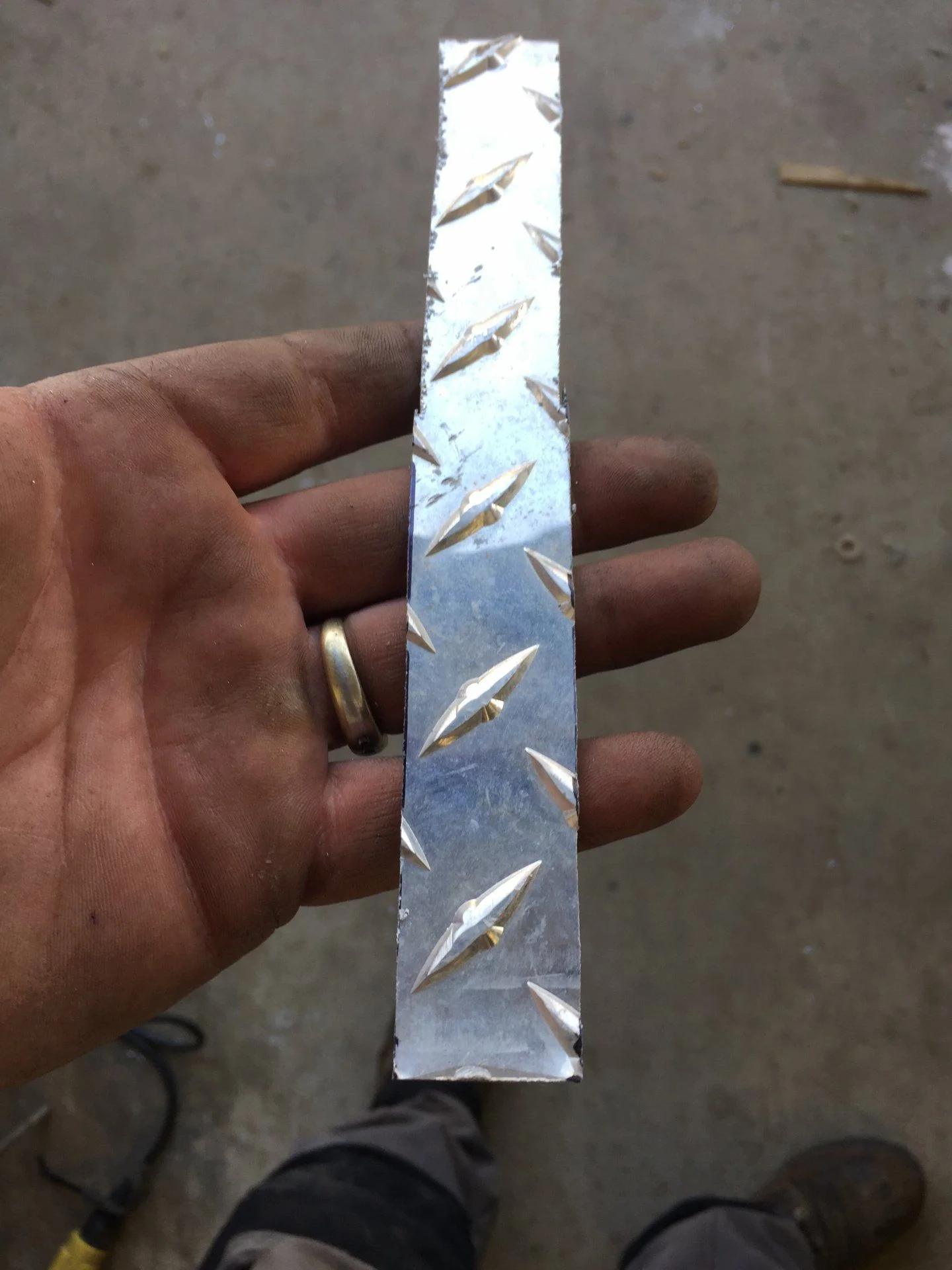

Used aluminum diamond tread for “cleats” to hold the ends together.

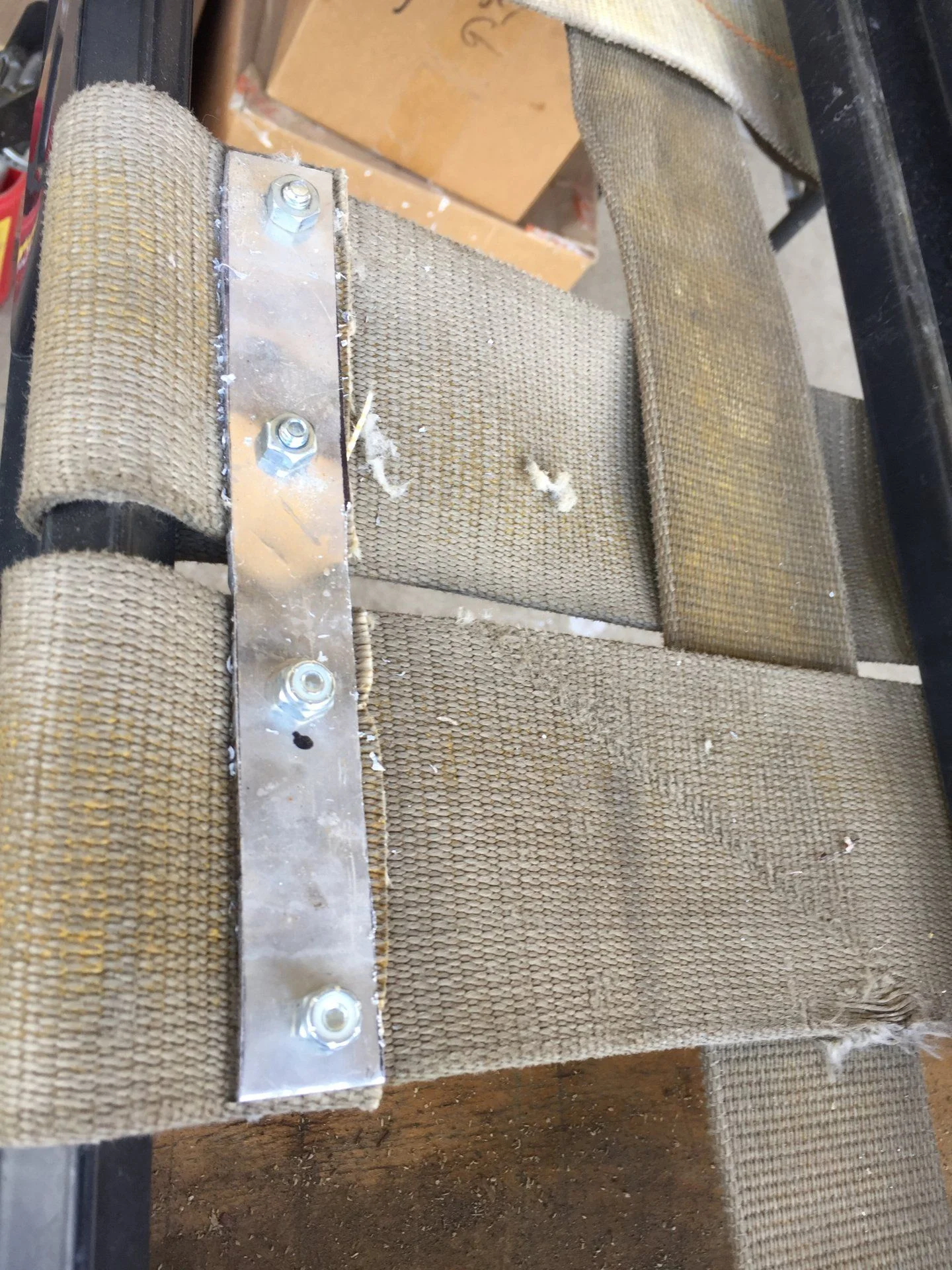

How the cleats secure the ends.

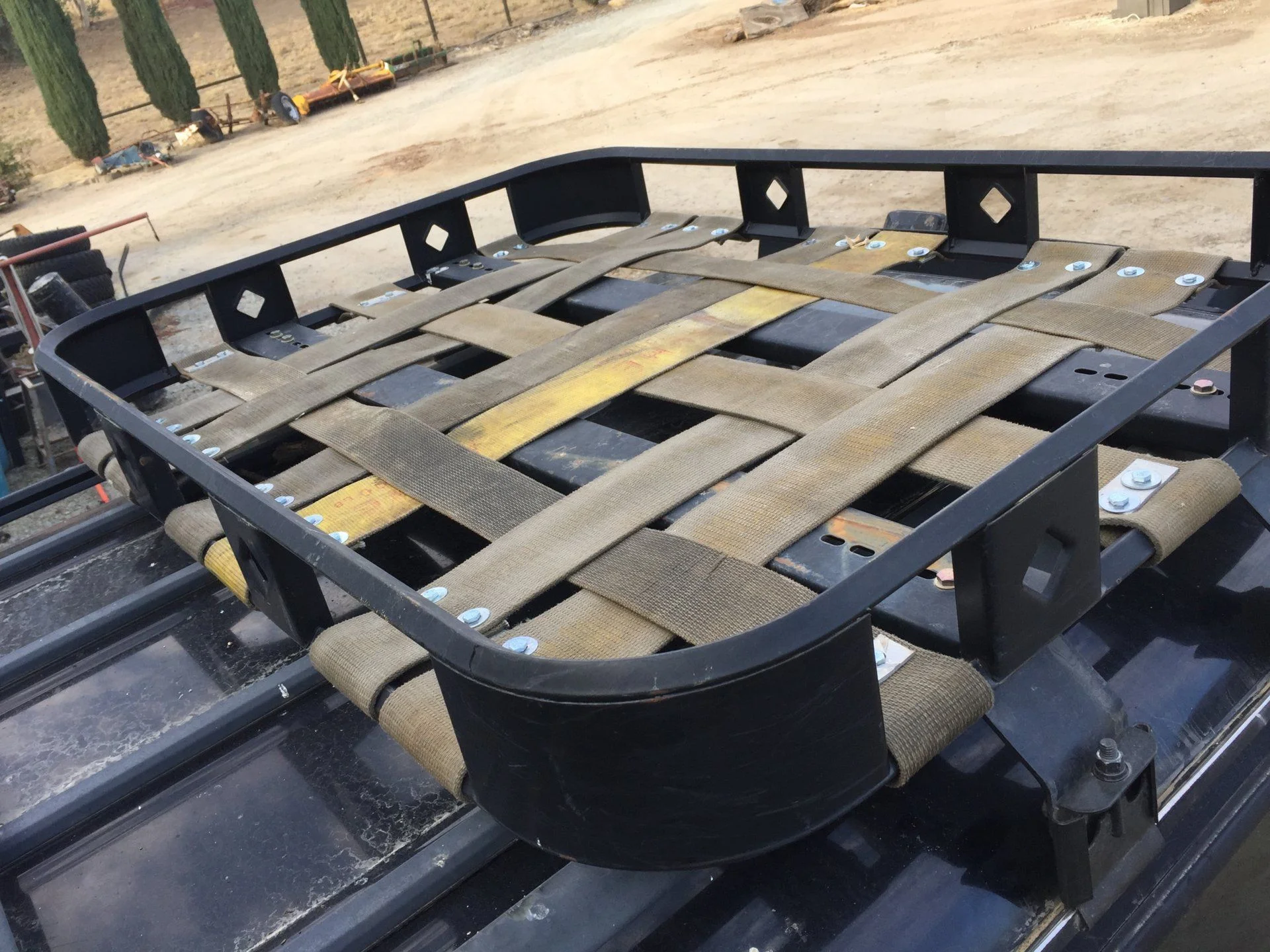

Finished roof rack with “cargo webbing” floor.
Simply brilliant! Old fire hose is also suitable for this... reminds me of a macrame camping chair!
I slept on something that looked like that once...
Load straps that truckers use also have an expiry date and would work just as well.
I threw out two 50' rolls last summer. I'm kicking my ass now.
