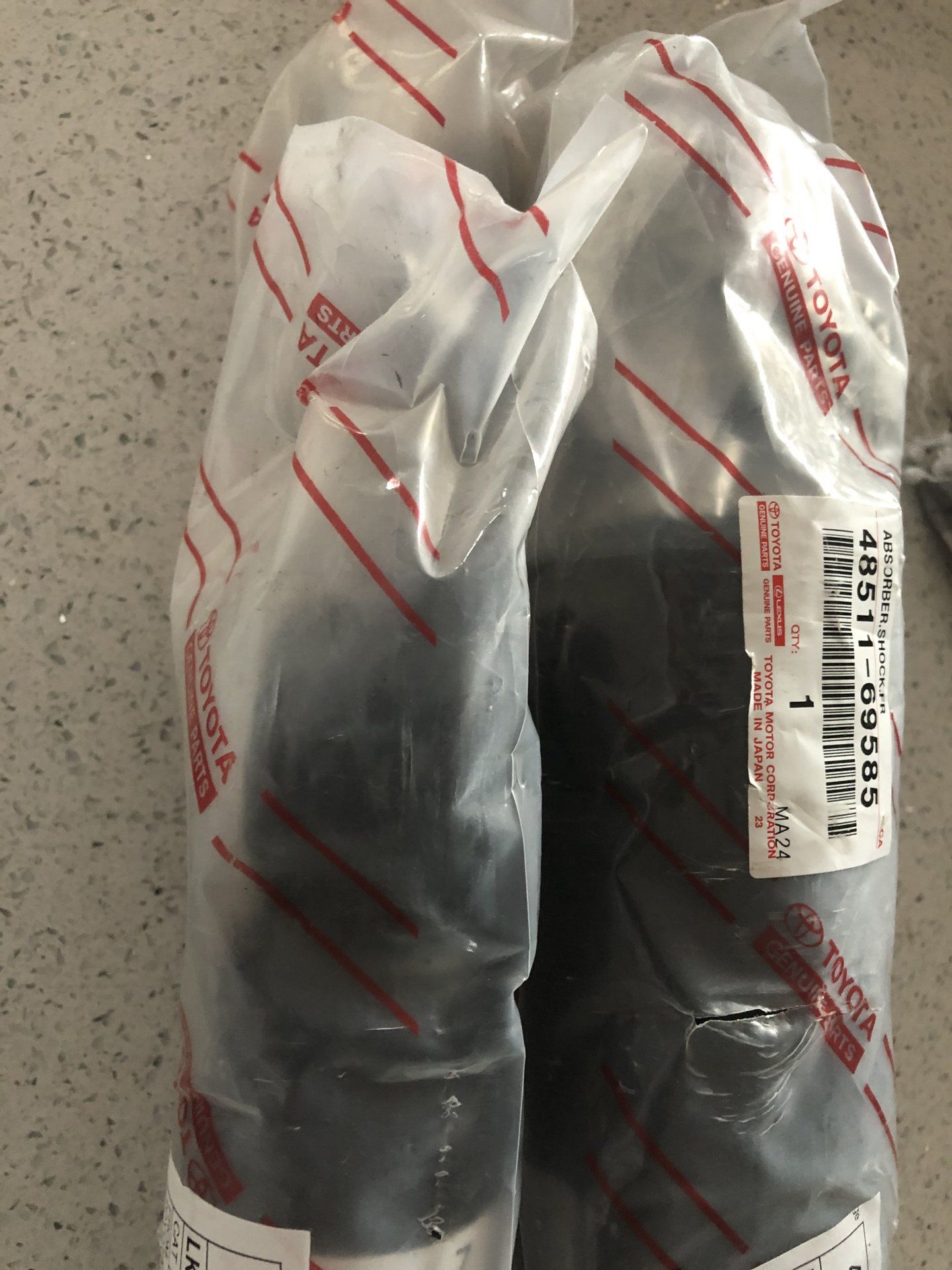

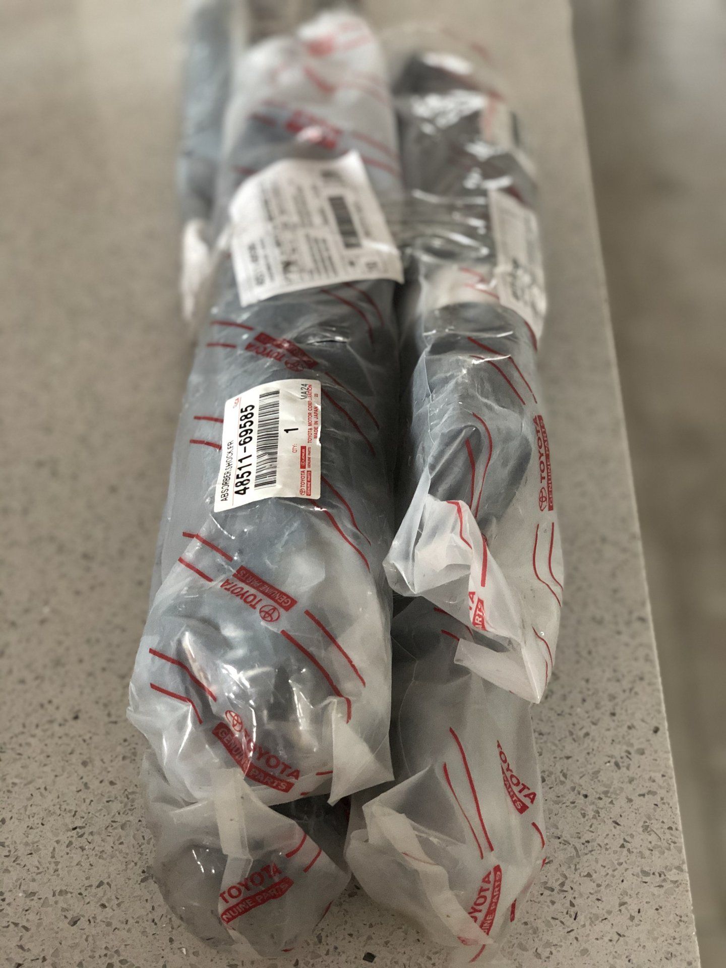

Front and Rear OEM for about $225, including shipping? Really? Seems like a fun weekend project...
I pulled the trigger. I'll post a review and maybe some pictures...
Ordered them Tuesday, arrived today.
