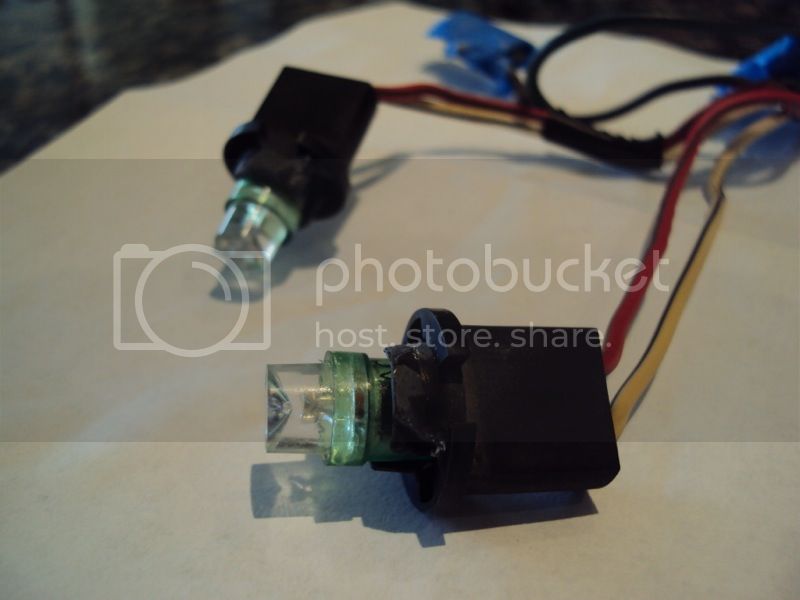

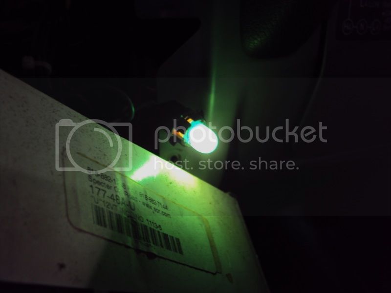

I used 6 of these (1 for multi-cluster, 1 for tach, 2 for speedometer, 1 for inclinometer, 1 for 4WD light)

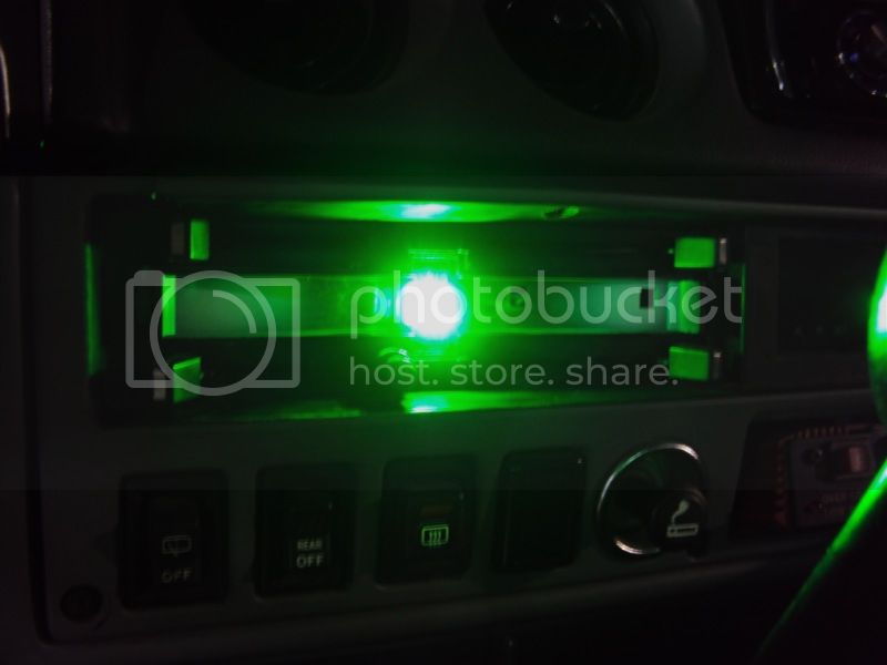

One 9 LED green brick for the heater controls
One BA9 LED for Sunpro Vacuum Gauge (no picture)
All of those bulbs are in the baggies in the next photo with part numbers :D

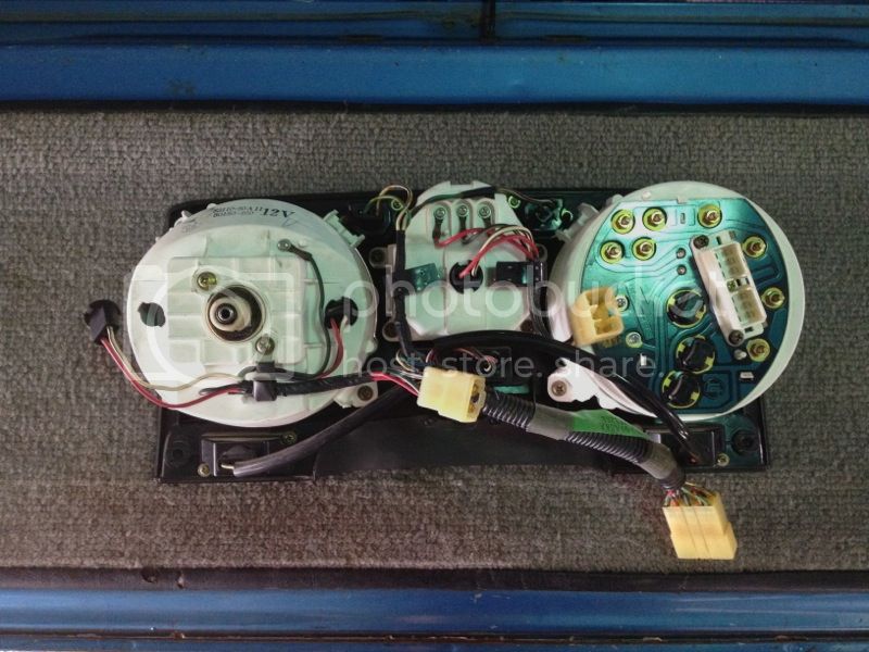

They are very easy to change. Undo the five screws for the instrument cluster, undo three wiring connectors and speedometer cable then it should be loose to pull out. Black light holders twist or snap into the white plastic housing.
Inclinometer is the most tedious. Gotta pull the trim off and pull the inclinometer. Same style light bulb holder as gauges.
HVAC controls even easier. Push inward on the left side and kind of pull backward. Cover should come off. White diffuser over bulb can be used or discarded. I left it out and put the brick in backwards to avoid a "hot spot."

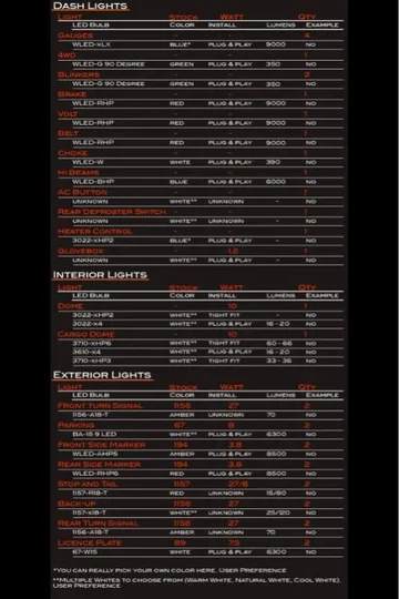

Also, klinetime: How many wled-g-120 should I buy? Six or seven? I'll be replacing the entire dash/heater lights.

https://forum.ih8mud.com/60-series-wagons/261572-led-light-swap-lots-pics-dial-up-bad.html
Green WLED-G-120 LED's you would need 5. It's really how you want to set it up though. Read the thread I linked. Hopefully it works. I'm posting from my phone :D
