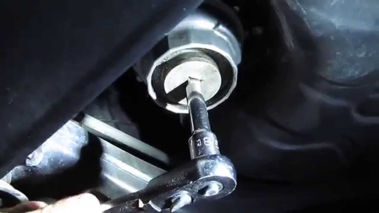

This plug was left out, this is a stupid design that's annoying as hell to do oil changes on. At least on my IS350, the filter sits at an angle so you can just loosen the whole unit and oil will drain out, on Siennas and Camry's, it's straight down like this, if you open the whole unit, you'll get an oil bath.
