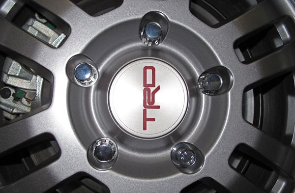

You will need to use different lug nuts, however, with conical seating surfaces and small diameter:
Recommended tire size from Toyota is LT285/70R17E for a 32.8" diameter tire.
