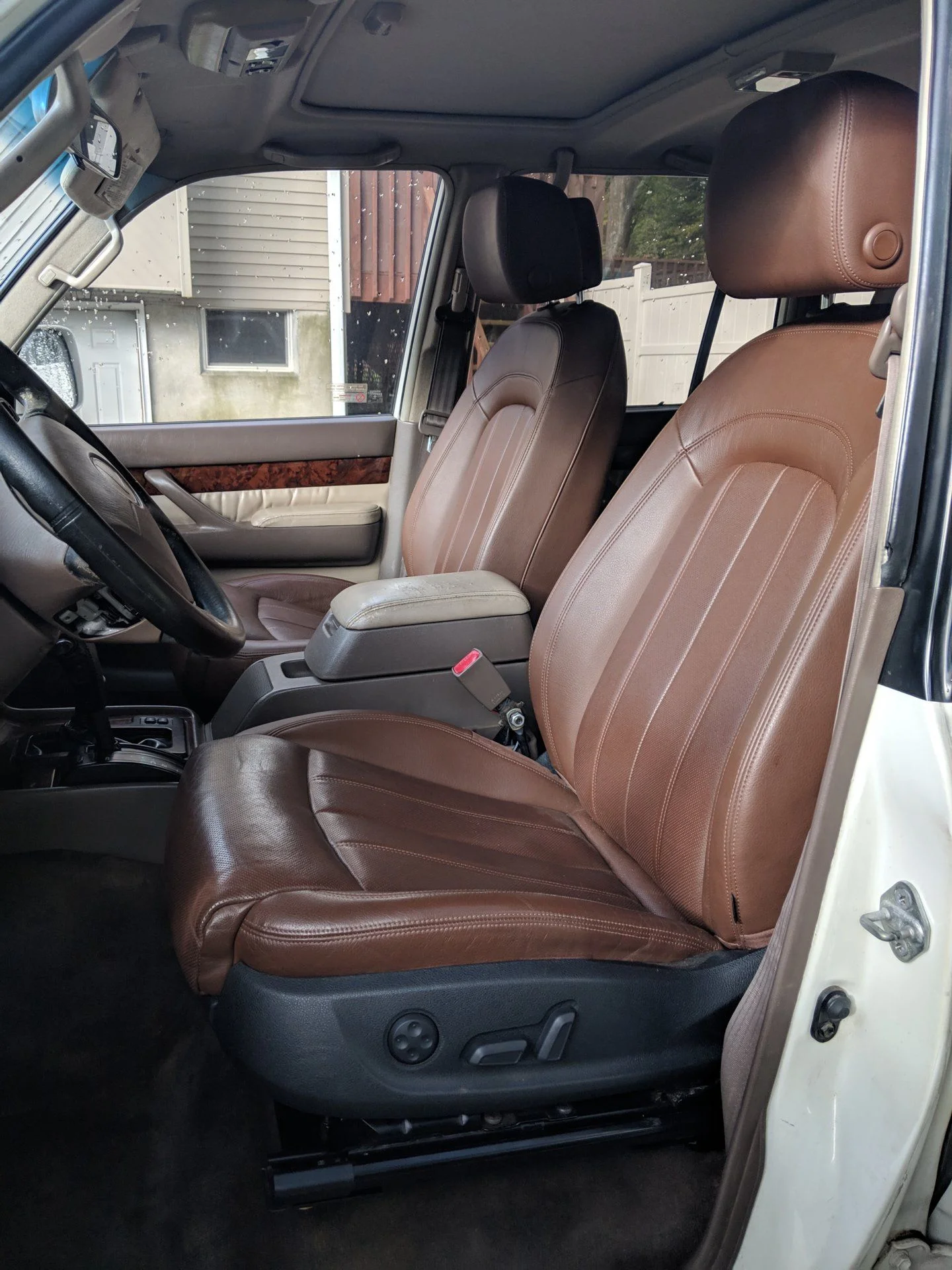

Today I completed the installation of the Audi seats in my LX450. You can read the whole process here.
Cheers
Well done! Is there an armrest on your new seats? That's on my new seat wishlist.
Clean! How do they feel over stock? Ride height any different?
No, these don't have armrests on them. I'll be replacing the center console eventually, I'll tackle the armrest situation there.
Those look great.
Thanks
They're slightly higher up than stock. Consequently, they're much more comfortable for my legs. I'm 6'2" and sit in them with plenty of head room. If I raised the rear of the seats all the way, my head would touch the ceiling, but there is a lot of adjustment in the Audi seats. These are the Audi "Comfort" Seats, and the name is apt, they feel great.
I finished up with the work that the PO started with a similar set of Audi seats in my LX. The 6" buckle extension seems like a better solution than trimming down the buckle like I did. ProjectsNmotion do you have a part number for the extension you ordered from seat belt planet? I'm not coming up with anything in a search.
Also, maybe I did a poor job installing them but as a word of caution for anyone else looking to do this mod, my new seats contact the door pocket. It's enough that it seems to prevent the door close button from being fully engaged and the dome light flickers on when the door is leaned on by the passenger. Regardless, there is very little room between the seat and the door both for reaching the seat controls or reaching into the door pockets. However there was a huge improvement in ride comfort. We just took a 12 hour trip and between the look and feel, it's like a new car.
EDIT: The dome light flickering was unrelated to the seats. It turns out, the striker was loose on the door pillar.
I'm in the process of fitting the same seats. I have the passenger seat in and haven't found this to be a problem.
I have the seats as tight to the trans tunnel as possible. I cut away part of the stiffening rib from the floor pan to make more room for the rails.
Will have the driver side in today
6 Inch Cable Extension | Seat Belt Hardware for Sale
Are you able to run the Factory Rear Heater or did you remove it when you put the Audi Seats in ?
The rear heater is still in place and still functions. But I'll eventually remove it, I'm not sure how well the heat from the heater will treat the electronics on the underside of the new passenger seat, they're fairly close to each other.
