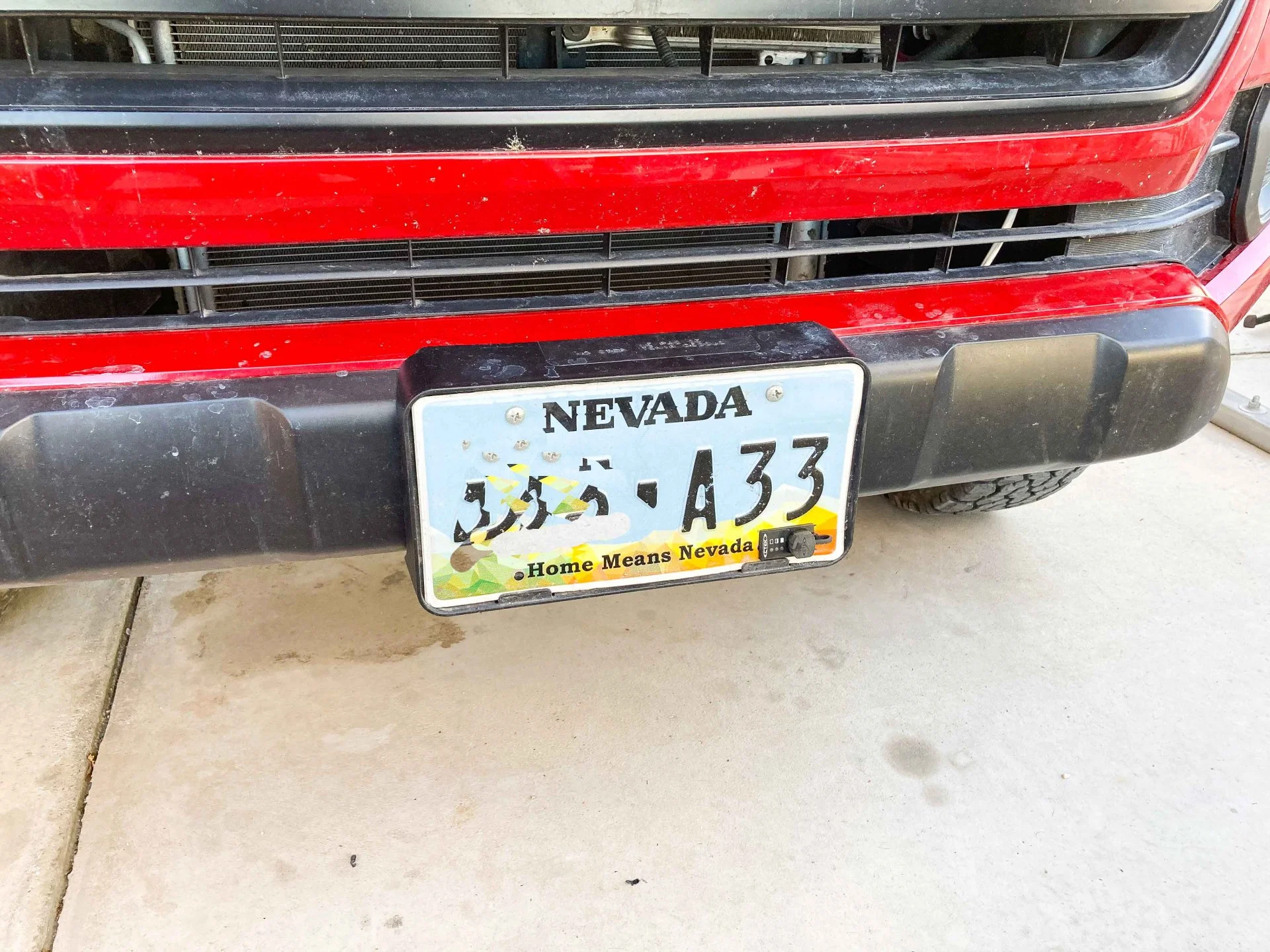

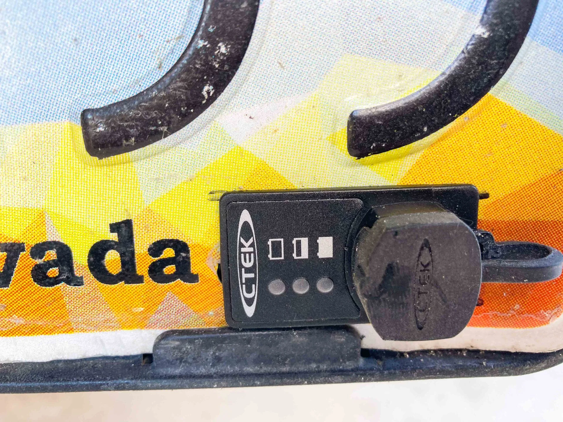

For now I installed the jack I spoke of.

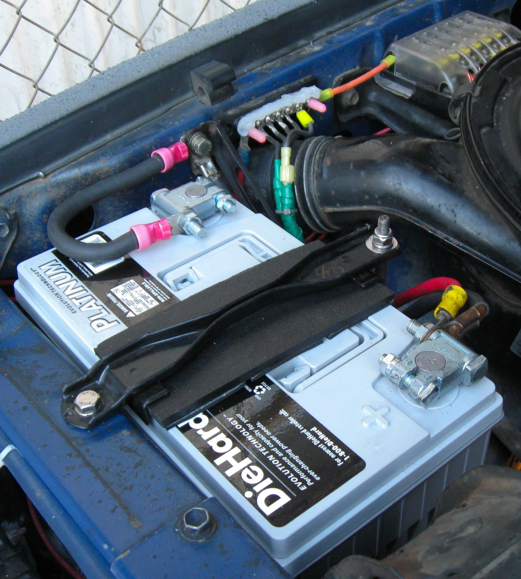

The Sears Die Hard Platinum (Odyssey) that I bought in 2007 for my 2004 Taco also died in 2021. I replaced it with an ODYSSEY Extreme Battery ODX-AGM34R (34R-PC1500T). I made a base for the shorter battery out of a piece of shaped wood, painted it and stuck it under the battery to lift it close to stock height.
Yes, Battery Tenders are the norm for me for each of my vehicles. Battery manufacturers are paramount. The OG Red Top in my '40 that I bought in 2002 (before Mexican mfgr) just crapped out in 2021. It's limping along, but will be replaced with an ODYSSEY Extreme Battery ODX-AGM34 78, (34/78-PC1500DT) this spring.

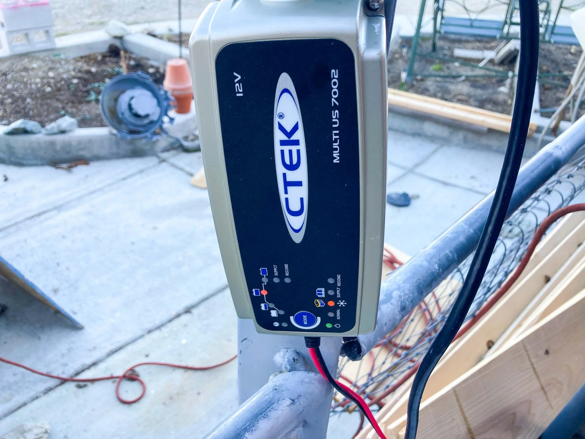

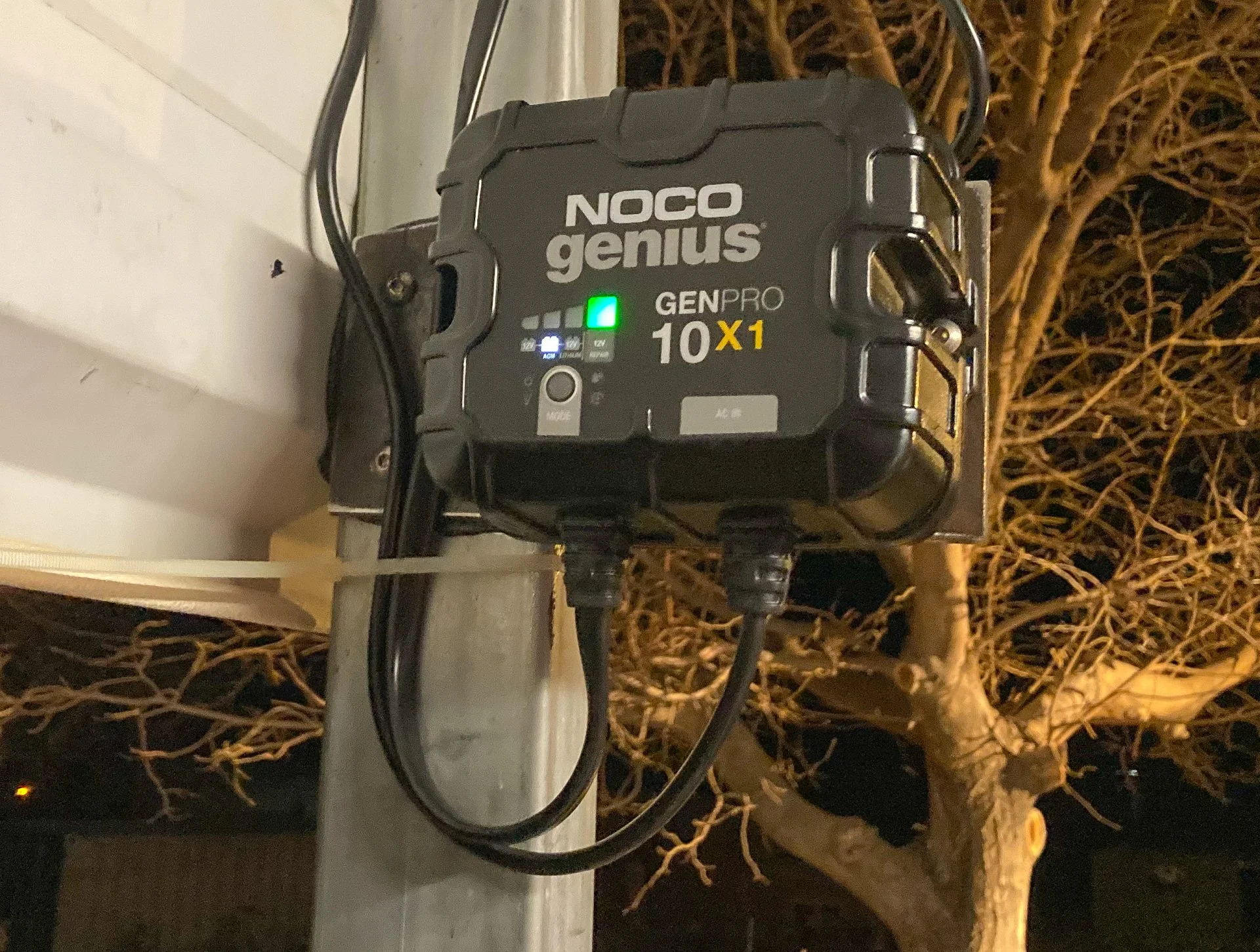

My Ctek died. opened it up and it was full of moisture. I ended up with a 100% waterproof Noco.

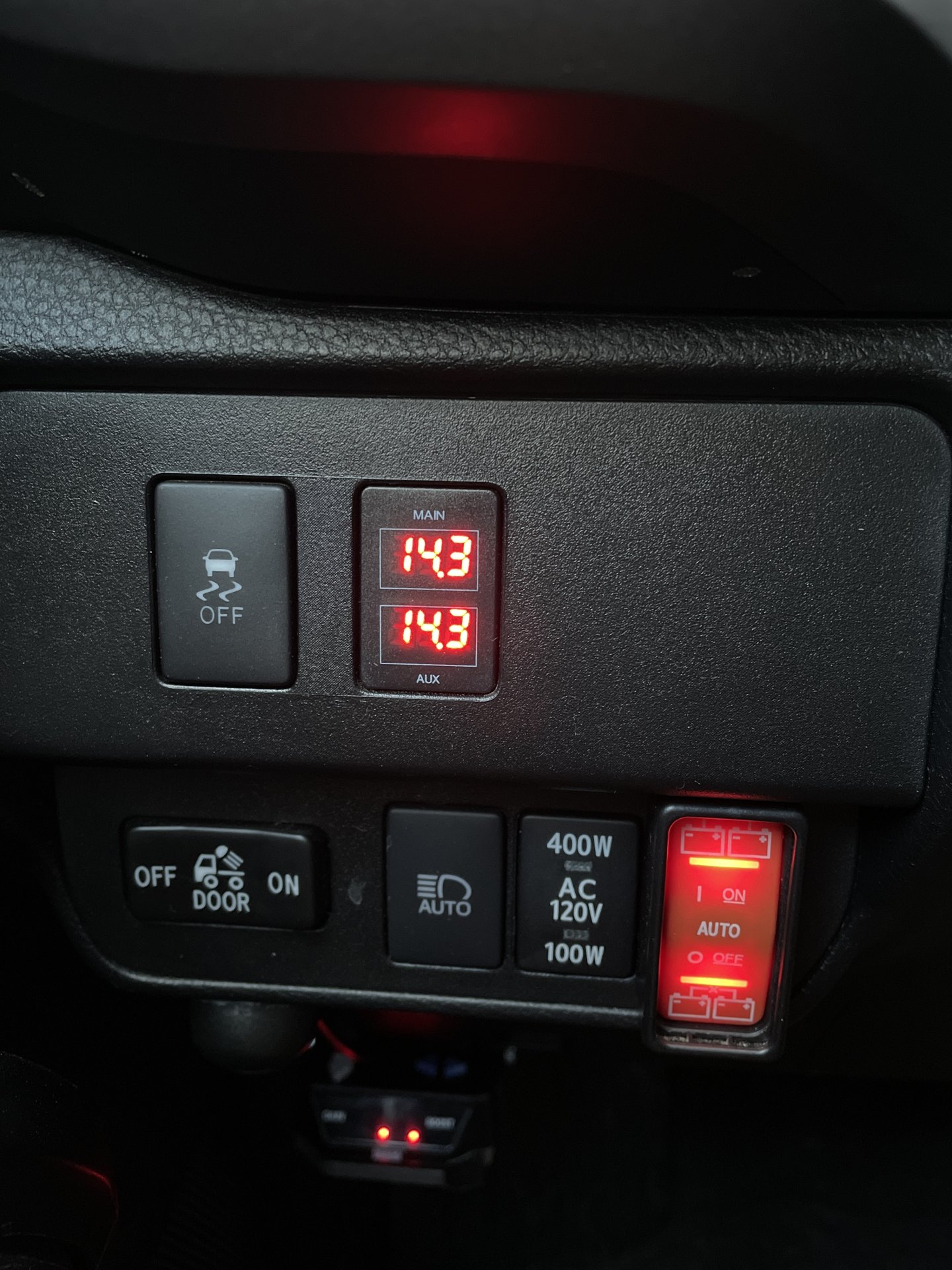

I got it done and I read around 14.3 volts all the time.
