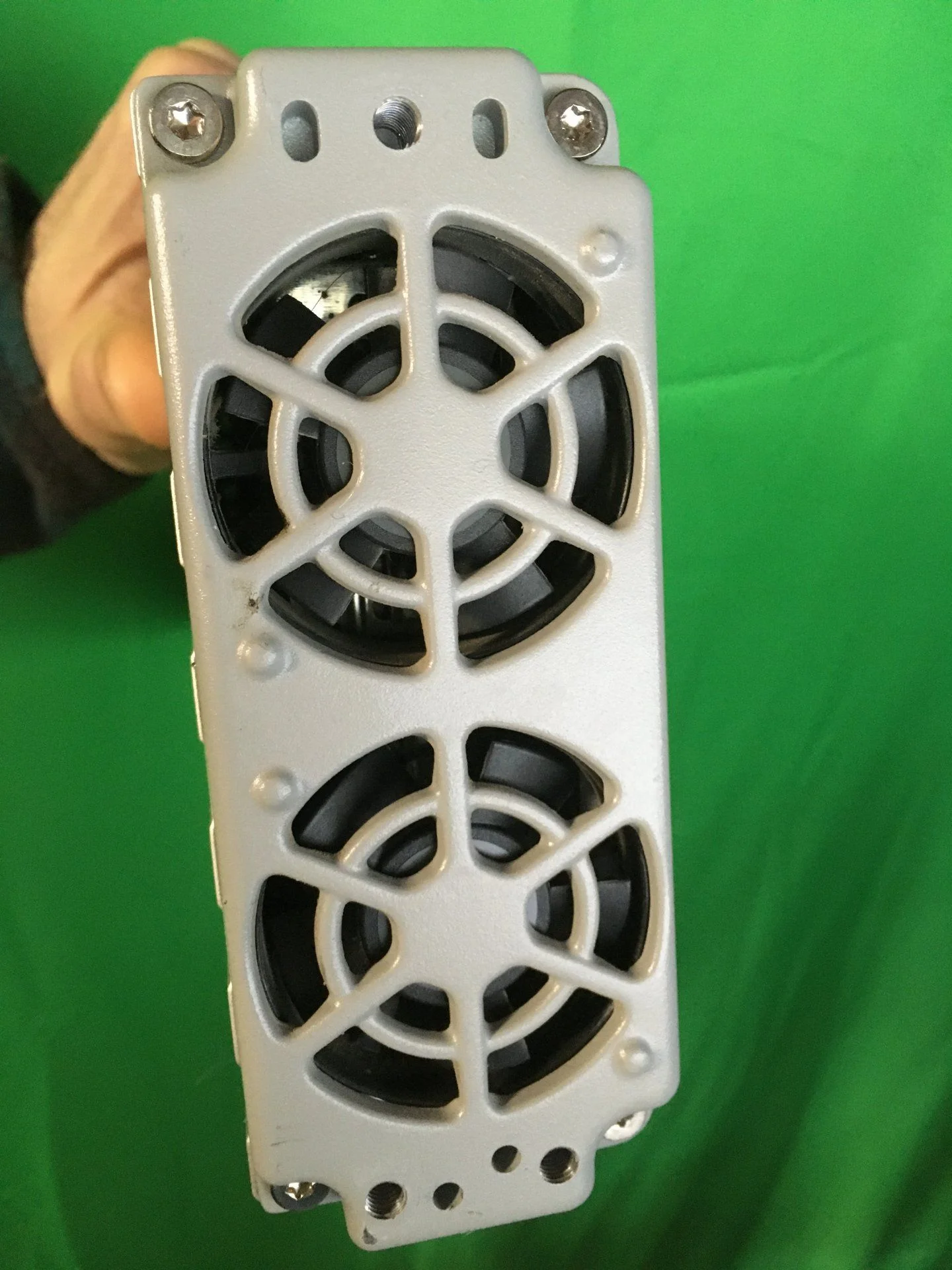

The Mark Levinson amp is under that seat. IIRC it does have a fan. Try turning off the audio system completely (not just lower the volume). Does the noise persist?

The fans are near the center of car (console side)

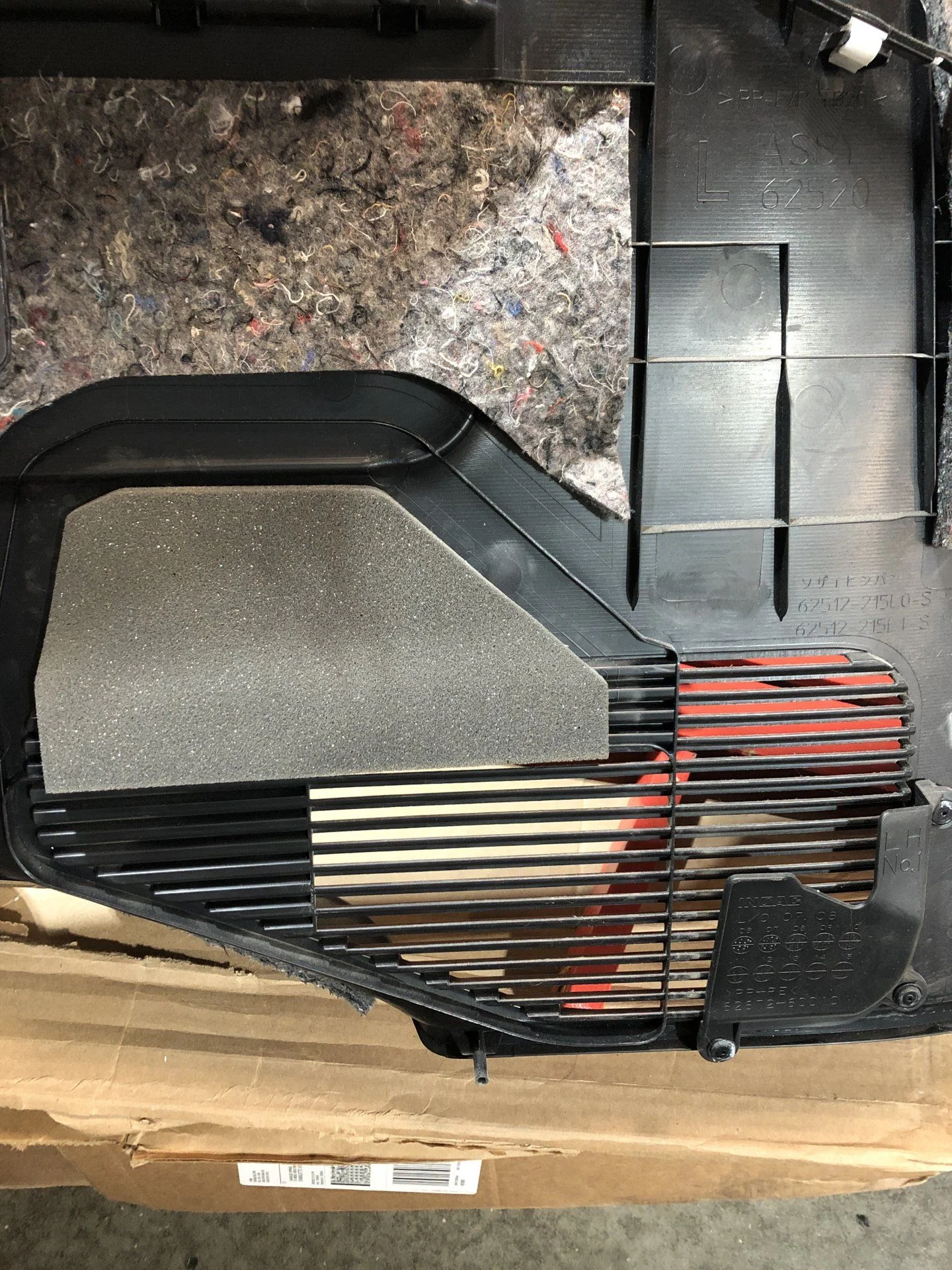

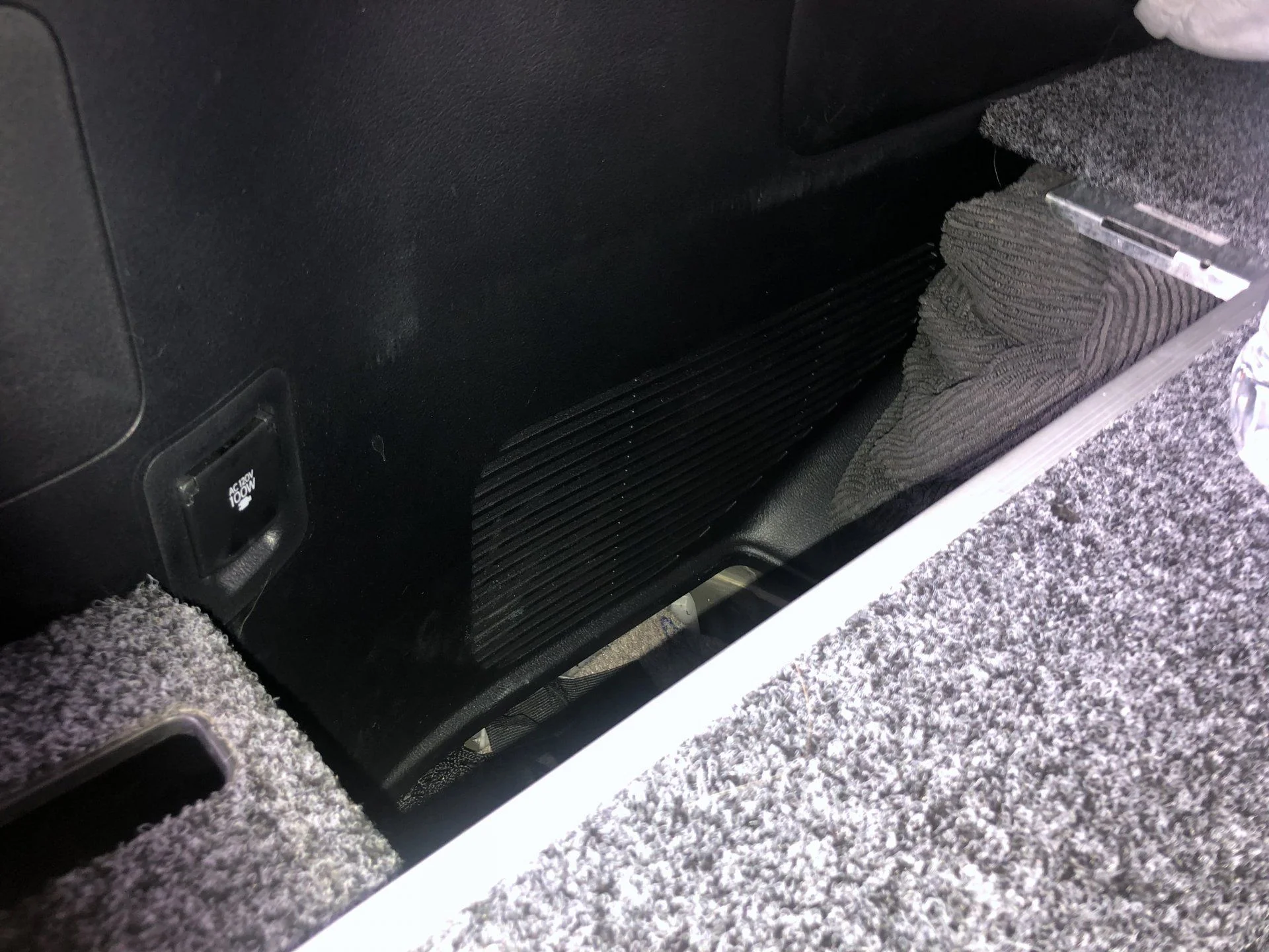

Check and make sure the far rear large Vent isn't blocked. I believe its an Intake Vent.
The one on the left hand side near the outlet in the rear of the rig.

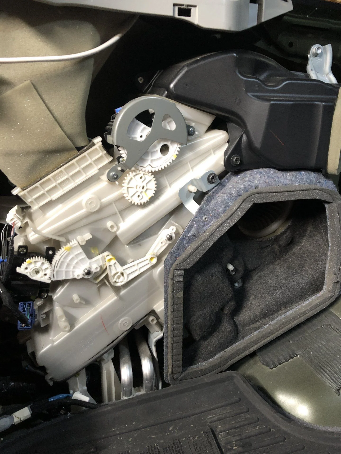

The amount of acoustic damping for a simple intake is impressive.
The one on the left hand side near the outlet in the rear of the rig.View attachment 2338495
I do have a lot of soft-bag gear right there in front of this vent. I don't think my gear is fully blocking the vent, but I suppose it might be possible as things shift around.
No kidding. I wish the ducts in my home HVAC system had that level of noise dampening!
