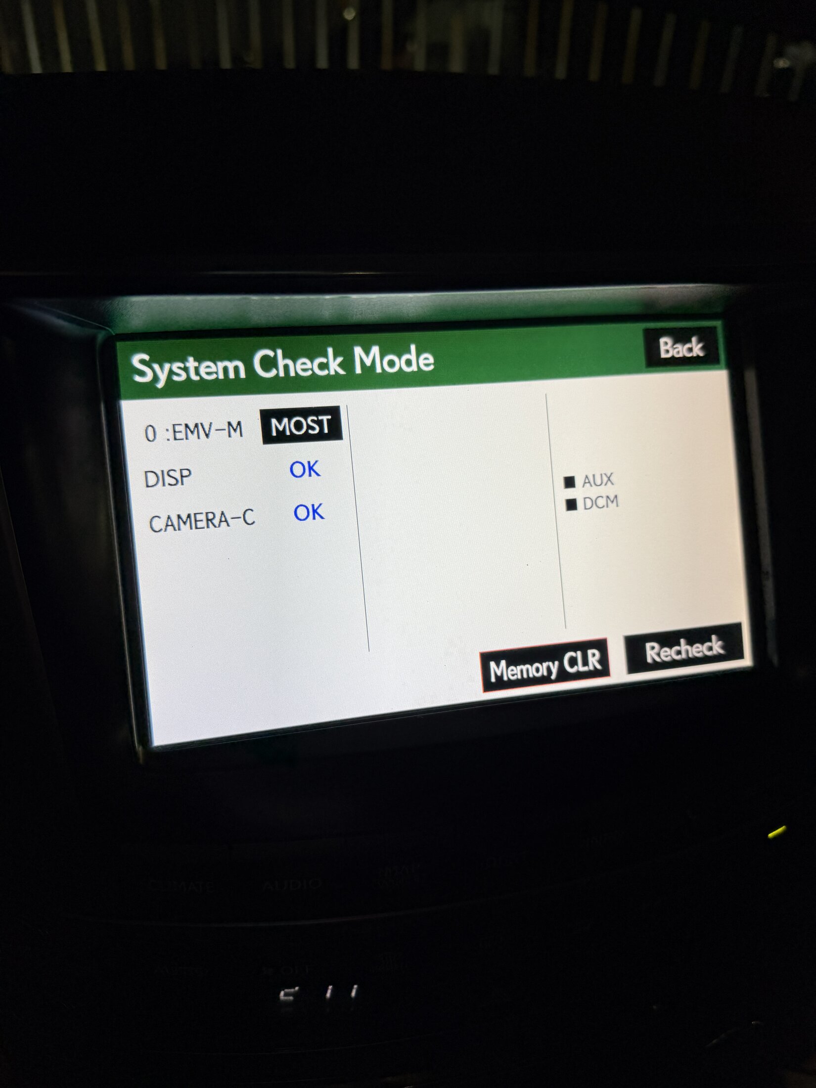

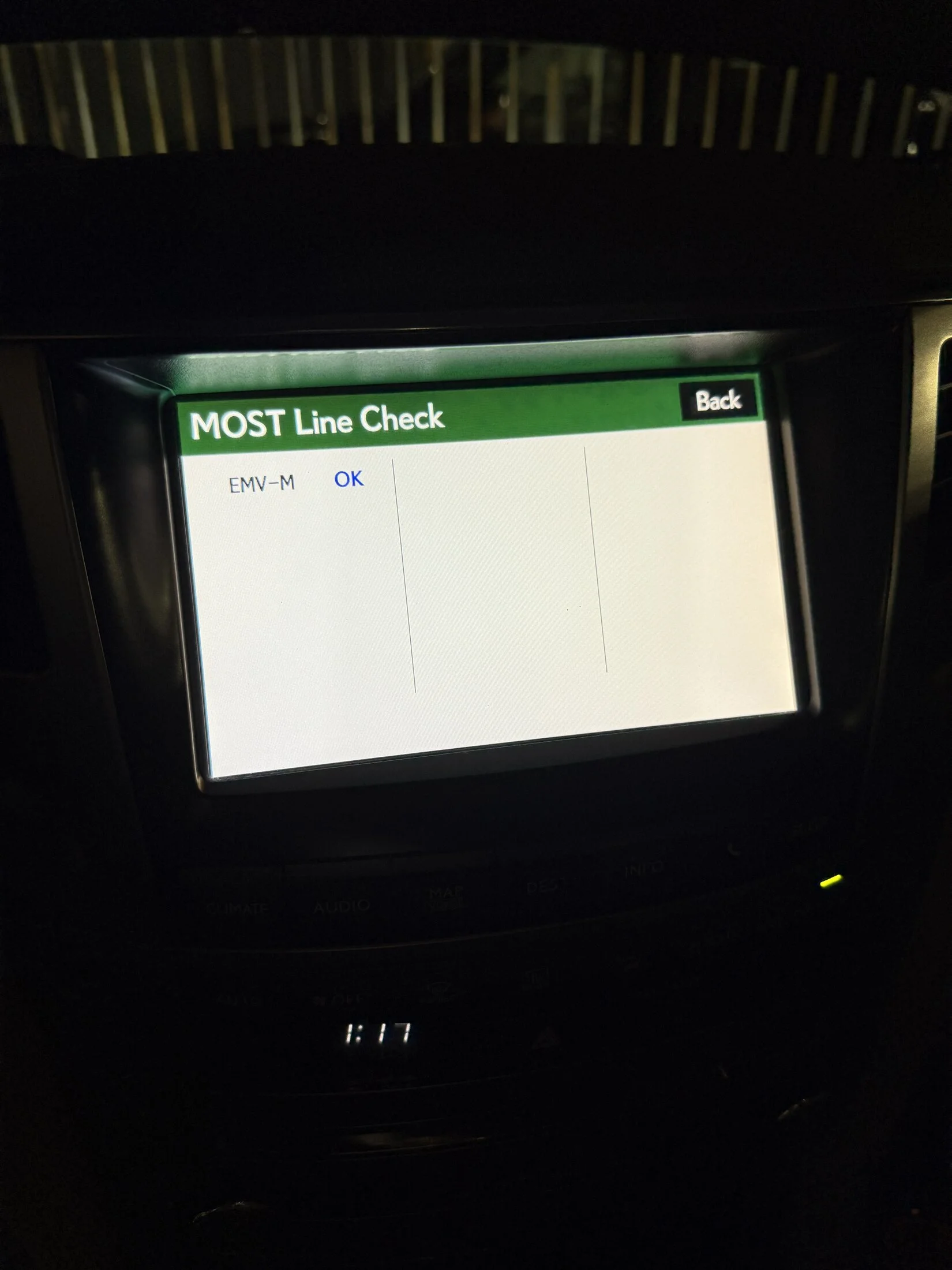

On MOST bus test car can’t see amp and rear screen module (I did not check before I start doing my stuff

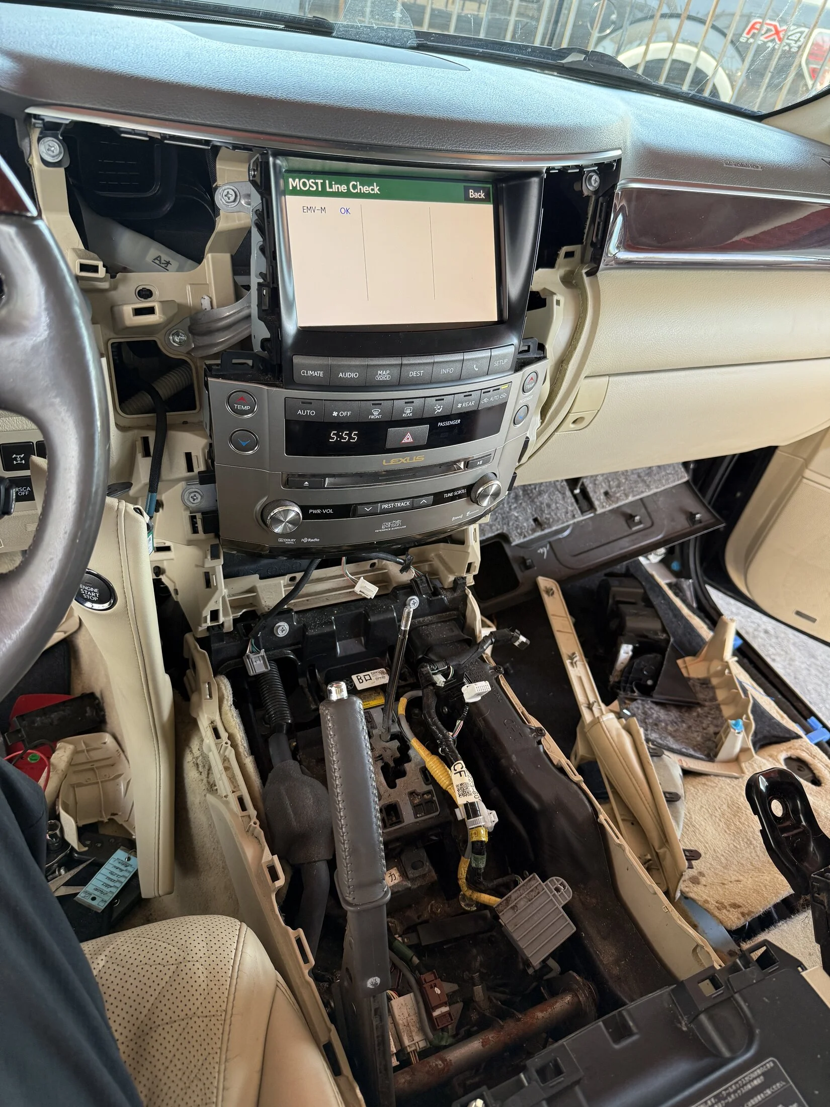

Pulled out screen with head unit, same thing, everything is super clean

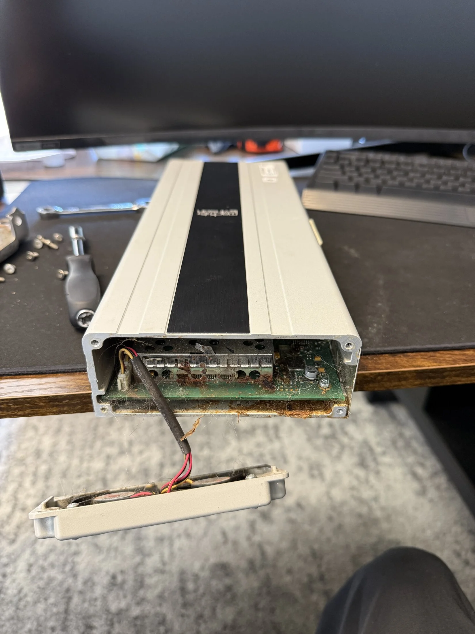

Then pulled out ml amp, there was some dirt glued on it, cleaned with wd40 electrical (dirt was only on fans side)
Tried to clean all MOST connectors under central console (actually found 2, first for usb and aux, second is closer to driver seat and looks like it goes to module under passenger seat)

Amp cleaned (it’s been working for million % before I started doing something)

I’m stuck now, why it doesn’t show on test amp and rear module???
Even if bad it must show some error
Looks like car don’t know he has a amp rear module
