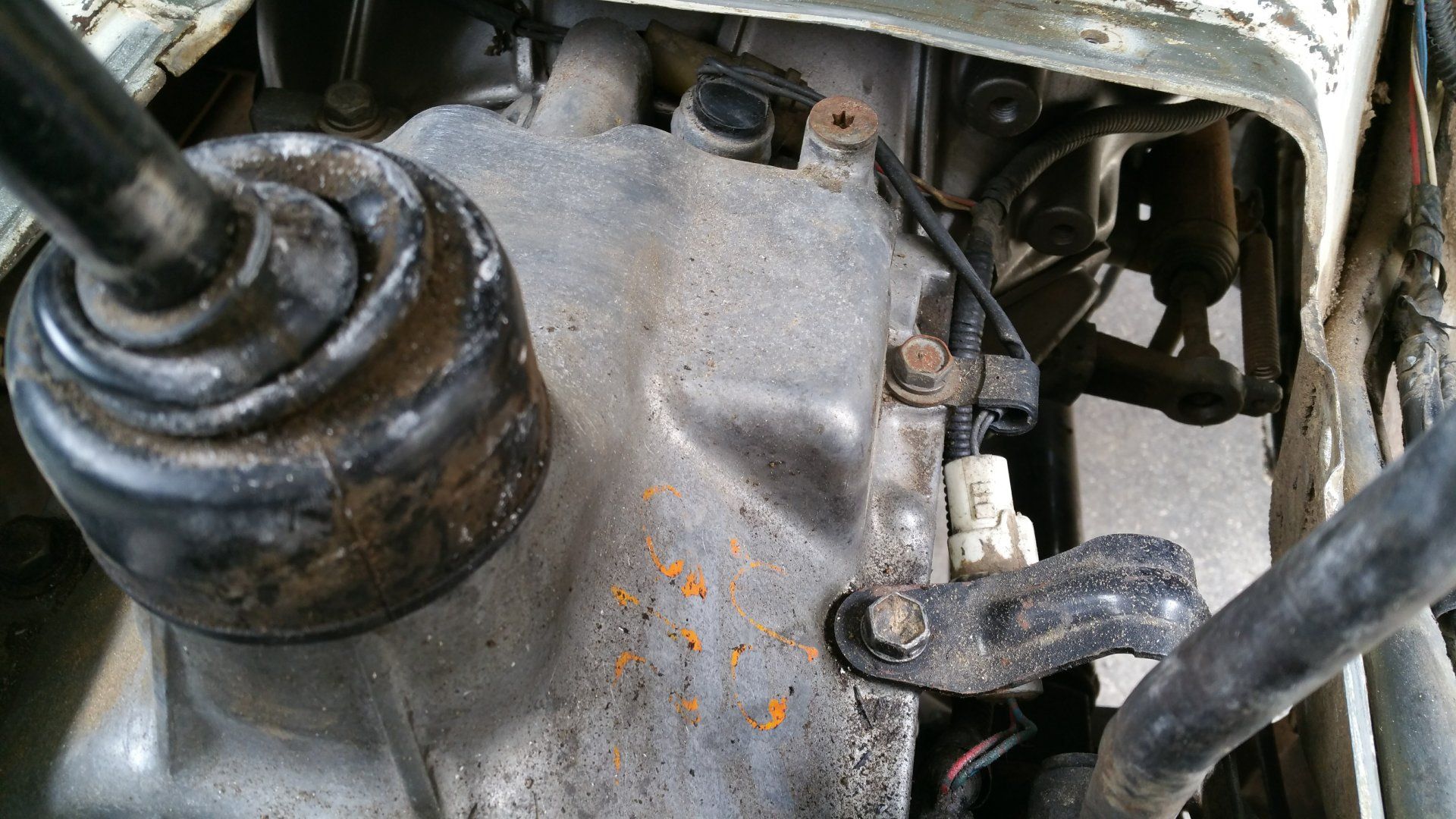

Also, while I'm at it, I had a 5-speed tranny put in and so the tranny cover needs replacement. I'm replacing it with a fiberglass one w/o cutouts from City Racer. When I took off the old cover, I saw this electrica line and connection. What does it go to and how do you separate the connection to clean the ends? My tach works intermittingly (usually after 15 minutes of driving and then can stop all of a sudden) so just wondering if these wires might have anything to do with it--bad connection, dirty, etc.).

the tach has three wires and the rpm sensor is located at the bellhousing.
What you see on your box is the reverse light sensor. You might need to get your tach calibration checked if you think its not running accurately or check the sensor at the left side of the bellhouse at 3 o'clock.
