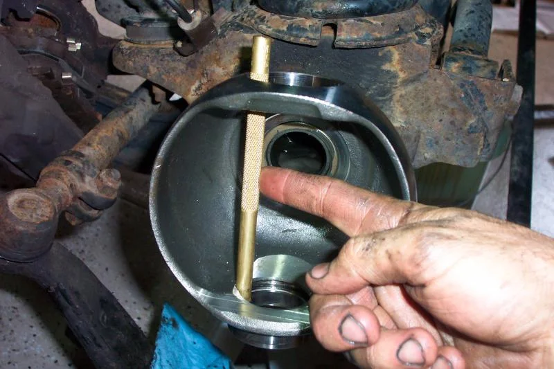

So, is it this race? Maybe I got lucky, but tapping alternate sides kept the race from cocking and jambing as it came out. There are open spots on each side of the housing for access to the back, probably you already found them. Heat is of course your friend, and patience.
If you don't have a torch, try using a dremmel tool and a cut off wheel. It will heat the race up fairly well. On one of those 1 am wrenching sessions I started a race in upside down. I used the dremmel to cut into the race to create a groove to put a flat head on to pound it out. You could even cut throught most of the race with one if it gets down to it.
