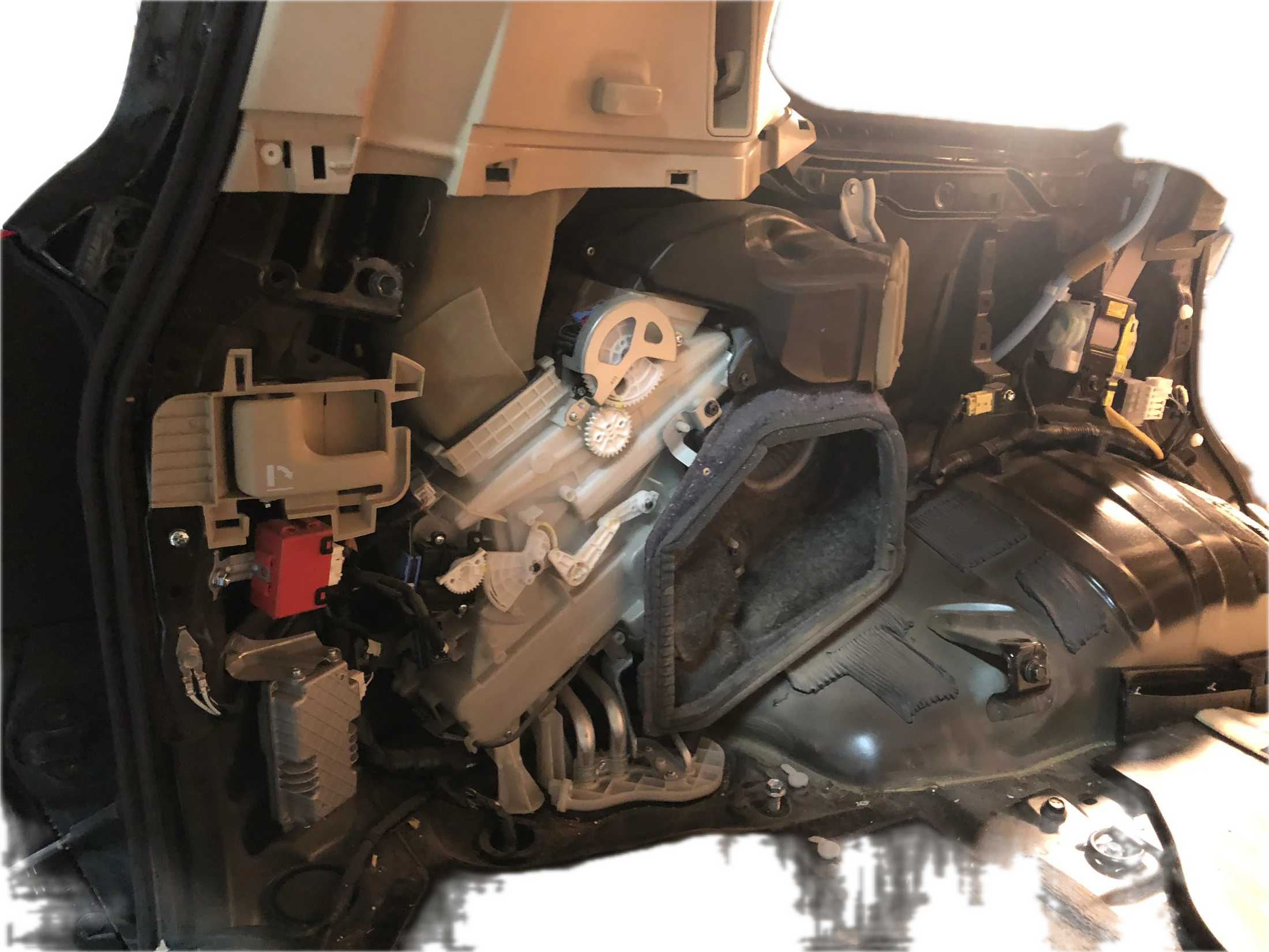

I pulled mine and it's relatively straightforward. You will need to remove the cargo area side panels to get access to everything. There's only 3 bolts per belt, one for the assembly, one for the upper guide, and one for the lower anchor point. This video from Victory 4x4 on molle panel installation covers the side panel removal. As for dog kennel installation, you could always put the bolts back in with some tie down rings so you won't have to worry about messing with the side panels again.

You can see in this pic below where the seat belt mechanism was.
