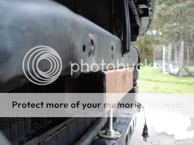

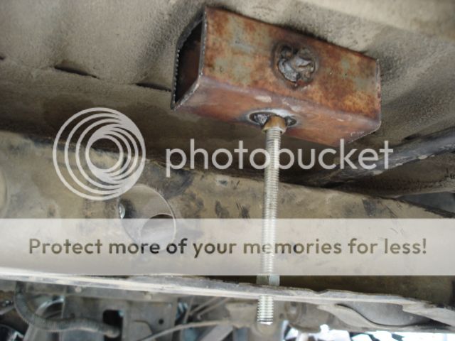

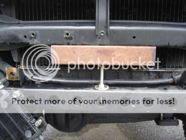

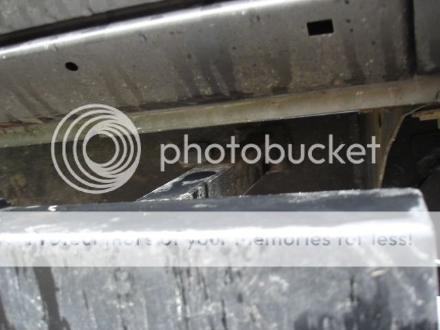

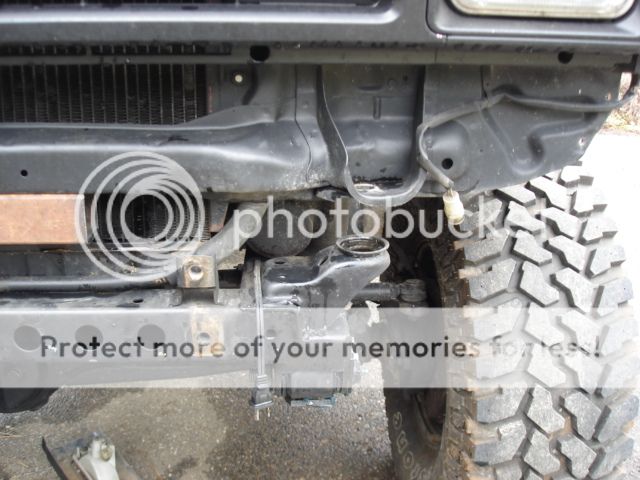

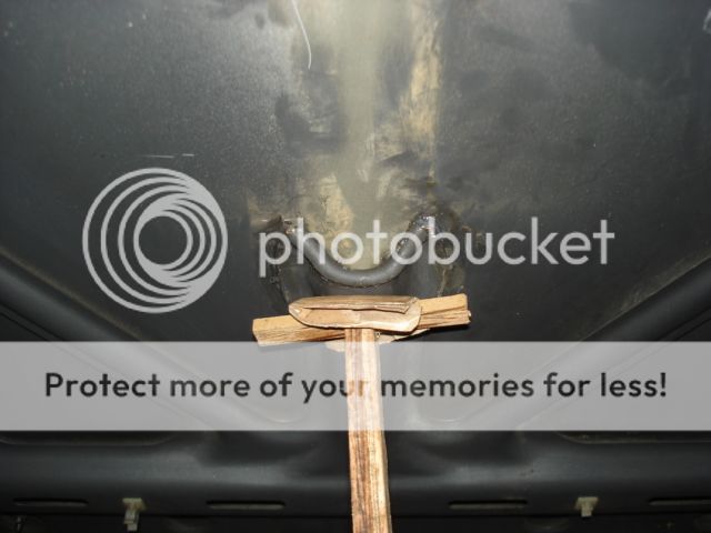

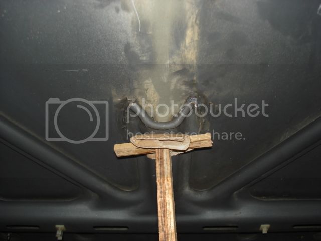

This is my solution to lift the body off the frame, and what I really want whoever reads this post to take from it because it’s more of a universal idea than taking a b/l off which probably isn’t happening that much. I took some 2x2 tube and some 3/8” all thread with some nuts and washers. I popped a hole in the tube and inserted the all thread with nut threaded on it and welded the nut in place then removed the all thread. The all thread needs to be made to be removed from the tube so you can slide it into place or you’ll get in a bind either up or down. I placed the rear jacks in the holes in which the OEM spare tire jacking mechanism was mounted, and the front one in the middle hole in the frame.
[URL="http://i677.photobucket.com/albums/vv136/chilldyl77/019.jpg"][URL="http://i677.photobucket.com/albums/vv136/chilldyl77/019.jpg"]
[/URL][/URL]
[URL="http://i677.photobucket.com/albums/vv136/chilldyl77/031-2.jpg"][URL="http://i677.photobucket.com/albums/vv136/chilldyl77/031-2.jpg"]
[/URL][/URL]
[URL="http://i677.photobucket.com/albums/vv136/chilldyl77/033-1.jpg"][URL="http://i677.photobucket.com/albums/vv136/chilldyl77/033-1.jpg"]
[/URL][/URL]
As seen in the front pic there is a nut spun onto the all thread that rests (with a washer) on the frame, when you turn that nut the “jack” goes up and down and lifts the body off the frame….worked well. By my observation there was no deflection in the body where the jacks were engaging, it’d be even better if there was a location for a center set. The whole system cost maybe 8 bucks and time. The metal b/l was from Trask Industries in Rogue River…

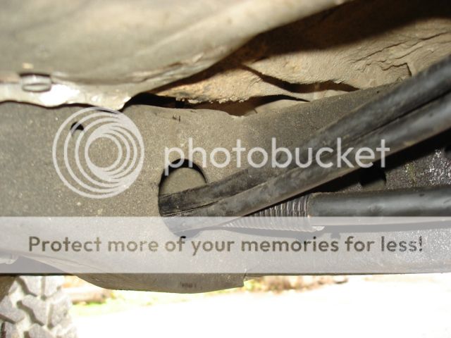

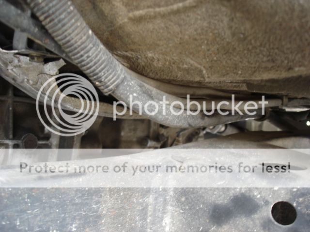

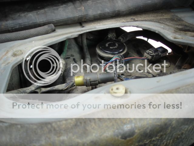

After I jacked the body and removed the b/l I began to lower the body back to the frame. My power inverter supply and EVAP lines got pinched and I had to re-route them through the frame....
[URL="http://i677.photobucket.com/albums/vv136/chilldyl77/046.jpg"][URL="http://i677.photobucket.com/albums/vv136/chilldyl77/046.jpg"]
[/URL][/URL]

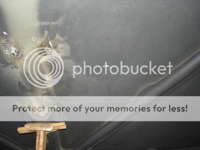

I also had to loosen my steering shaft at the body and chisel it open where the shaft splines meet the joint so there would be easy slippage inward. Upon lowering the body I realized that there wasn’t going to be enough clearance for the tank evap so I dropped the tank down ¾“ to make up the difference. Also had to pull up the sheet metal a bit for the tank stuff, ended up pressing it down a bit, the access panel fits and the seat latches properly...

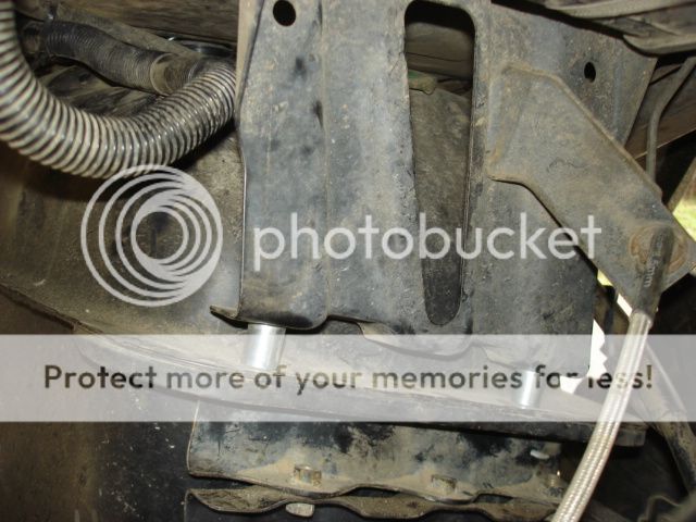

Shimmed up the hinge side with some 1/8 plate which seemed to do the trick until/if I shift the body, now I have more like 1/4 clearance...
[URL="http://i677.photobucket.com/albums/vv136/chilldyl77/031-3.jpg"][URL="http://i677.photobucket.com/albums/vv136/chilldyl77/031-3.jpg"]
[/URL][/URL]
That 1.5” makes a big diff, feels like it handles better, could be the lower center of gravity or the “I just washed my rig and topped off my tank and all of a sudden it feels peppier” illusion. Despite having to cut my side steps off, at least now I can tip-toe and only moderately rub my arse on the edge of the seat upon entry, but I think they’re going back on, probably same relation to the body which would make them 1.5” lower than the bottom of the frame this time.

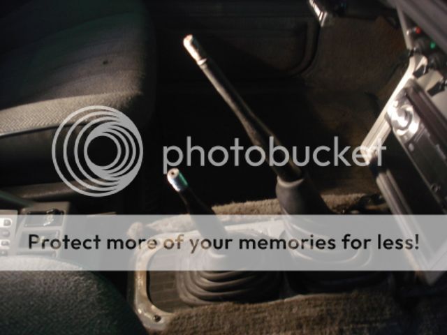

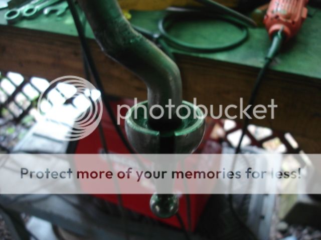

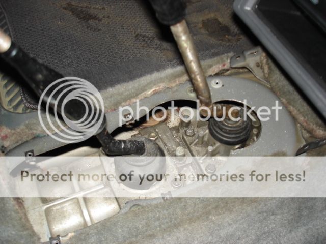

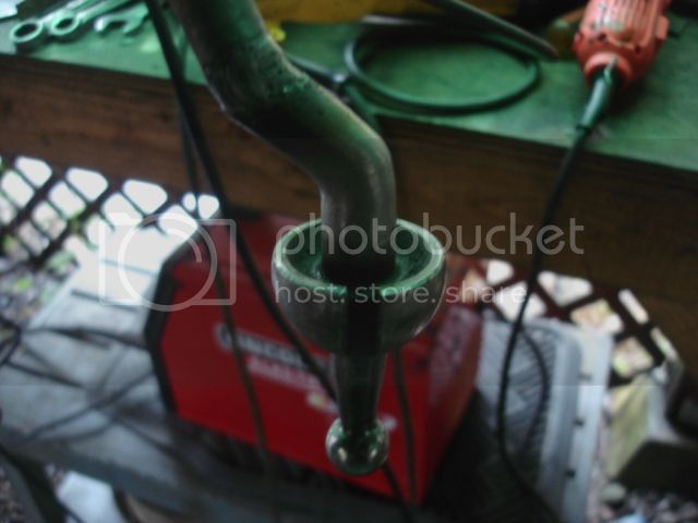

I had to mod my shifter sticks previously to stab them to work, look, and feel like OEM, but now there was going to be no lift so I had to remove part of the body for the sticks to fit. This is what happens when you use the v6 x-member in a 4cyl OE rig, you can see my new mounting holes with those screw clip things...
[URL="http://i677.photobucket.com/albums/vv136/chilldyl77/003-7.jpg"][URL="http://i677.photobucket.com/albums/vv136/chilldyl77/003-7.jpg"]
[/URL][/URL]

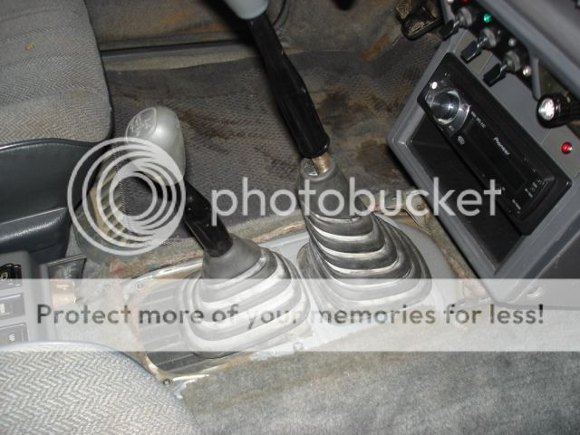

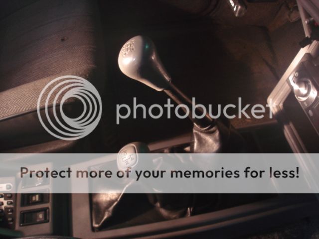

I also permanently located and mounted my boots with ring (my original ring from w56, boot from 89 r150) to work with the OEM w56 outer leatherette boot. This is a pic of the sticks before I cut them down to size...
[URL="http://i677.photobucket.com/albums/vv136/chilldyl77/002-8.jpg"][URL="http://i677.photobucket.com/albums/vv136/chilldyl77/002-8.jpg"]
[/URL][/URL]
I plugged the hole behind the tranny boot with light gauge rubber bed liner material. The way the shifter was previously modded there was contact where the plastic tray is molded into the front. After lots of cutting, tacking, fitting, bending, tacking, etc. I finally got the dog legs I needed in the sticks. The whole process took about 3 hours for both. The first bend off the cup is the finished product/look.
[URL="http://i677.photobucket.com/albums/vv136/chilldyl77/020-1.jpg"][URL="http://i677.photobucket.com/albums/vv136/chilldyl77/020-1.jpg"]
[/URL][/URL]
[URL="http://i677.photobucket.com/albums/vv136/chilldyl77/017-1.jpg"][URL="http://i677.photobucket.com/albums/vv136/chilldyl77/017-1.jpg"]
[/URL][/URL]
Finally got my sticks in a comfy position for the rubber boot and the outer boot with no stick interference or boot grab. What you see is Neutral / H2; I may lift my t-case shifter up a little....
