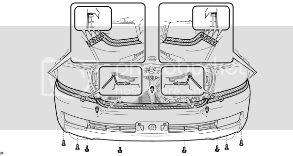

intersting so the hardest part of removing the headlight is the bottom bolts. I wonder if you have a picture of that .. i appriecate all the info.
Unfortunately I don't but they are right under the headlight which is why I removed the bumper skin. It's super easy even with bull bar:
  1. Remove bolts from fender liners
  2. Remove top screws and/or clips along the top of the grill. You may need to remove beauty covers if you still have them
  3. You should be able to pop out the grill at this point. My winch control pack was in the way so I had to remove it
  4. Disconnect headlight washers from behind the bumper, make sure you clamp them off or you'll drain fluid everywhere especially on driver's side
  5. Start popping off the bumper skin from one of the wheel wells. It will be tight but you can maneuver the headlight washers between the bumper edge
  6. Slide bumper skin out in front of the bumper uprights
  7. Two lower bolts per headlight will now be exposed

Headlight bolt pics I took a few months ago:
Normally there's a gray plastic thing that goes here, too, but was removed for my bumper:
