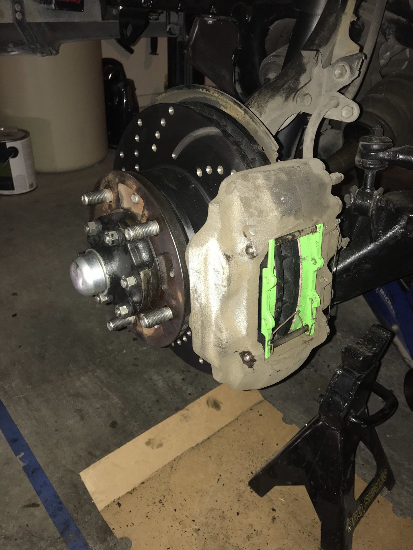

EBC Slotted & Dimpled rotors..
EBC HD brake pads..
Not that race brake you’d expect from a sports car, but better than OE (brake length distance and dust).
That black coating eventually came off when the pads made contact to the surface, but a good way to minimize or even prevent rust on the rotors -will find out in the years to come. Had it for around 1000 miles now.
