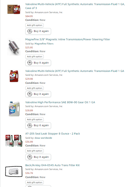

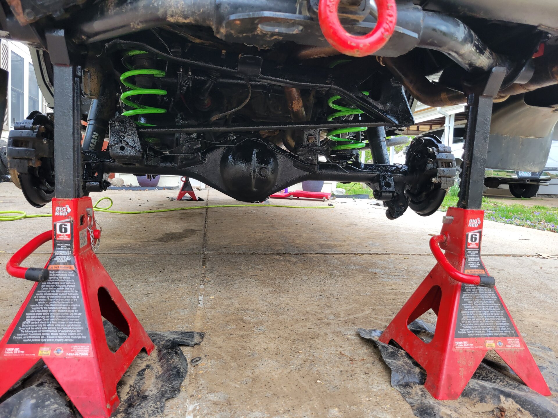

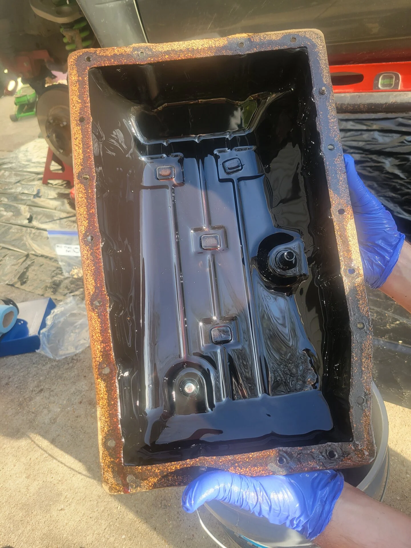

How often do you use AT-205?Time flies - hard to believe it's been over 3 years since I did a AT fluid exchange and pan drop. Going to also change fluids in the diffs, TC, and PS, then hit-up the underside of the rig with Woolwax while it's on jackstands. Normally I'd not order all of this stuff on Amazon but my local Wal Marts are chronically sold out of Max Life ATF and Bezos had the best price otherwise.

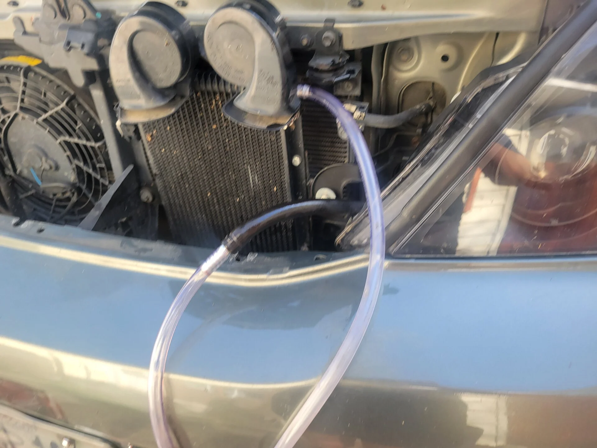

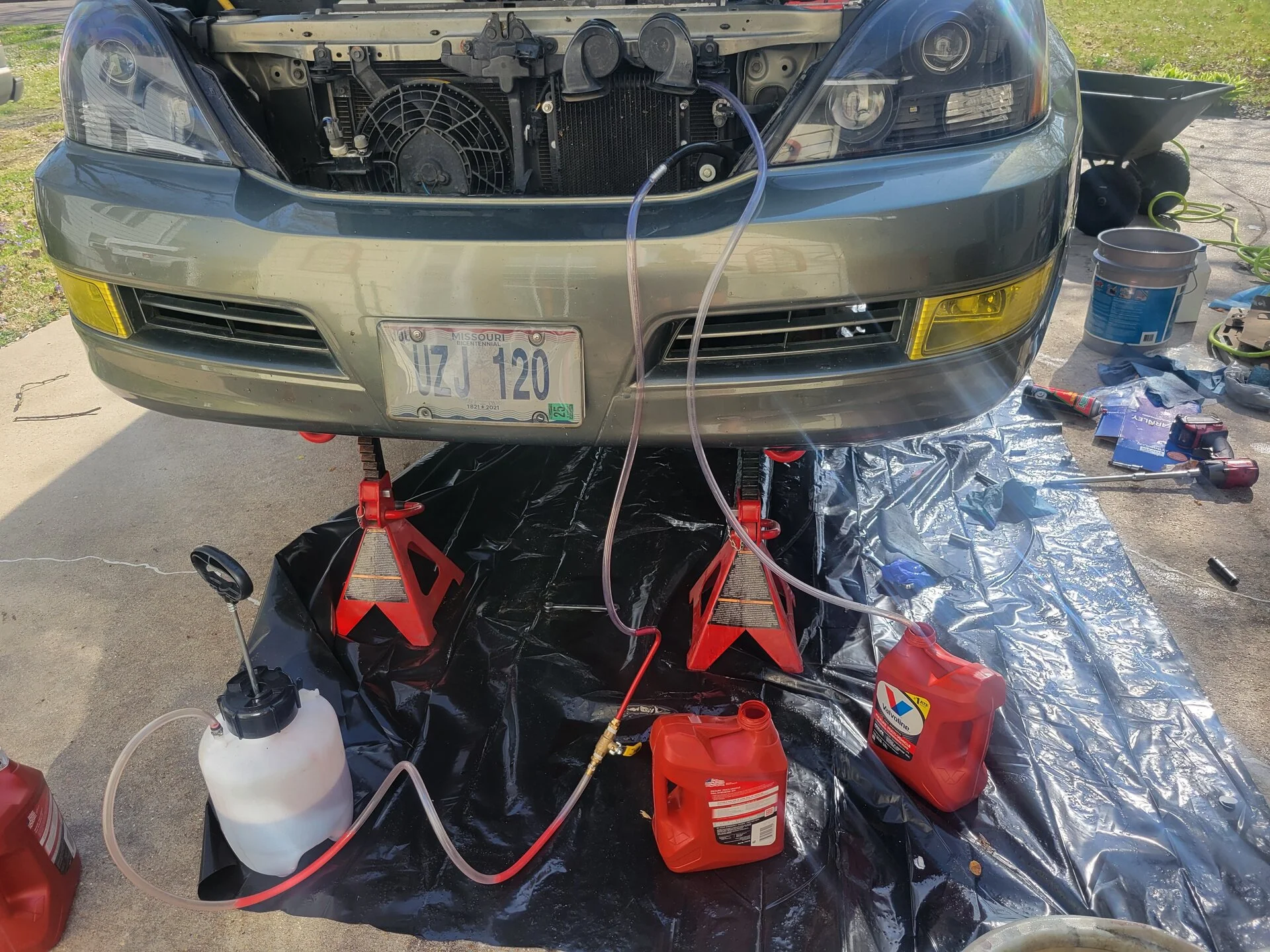

The original idea came from a YouTube video. I just modified it to add the Power Fill. In 2020 used a funnel plugged into the return line without air pressure, and it took foooorrrrrreeeeevvvvvveeeeerrrrrr for the ATF to make it's way back into the pan. I also tried a similar approach as the video (with air pressure) with a 1 quart bottle when I did the valve body, but ended up blowing the side of a bottle out! the Power Fill was pricey but worth it.That is a awesome transmission exchange setup. Mine is close to being due, might have to copy that!

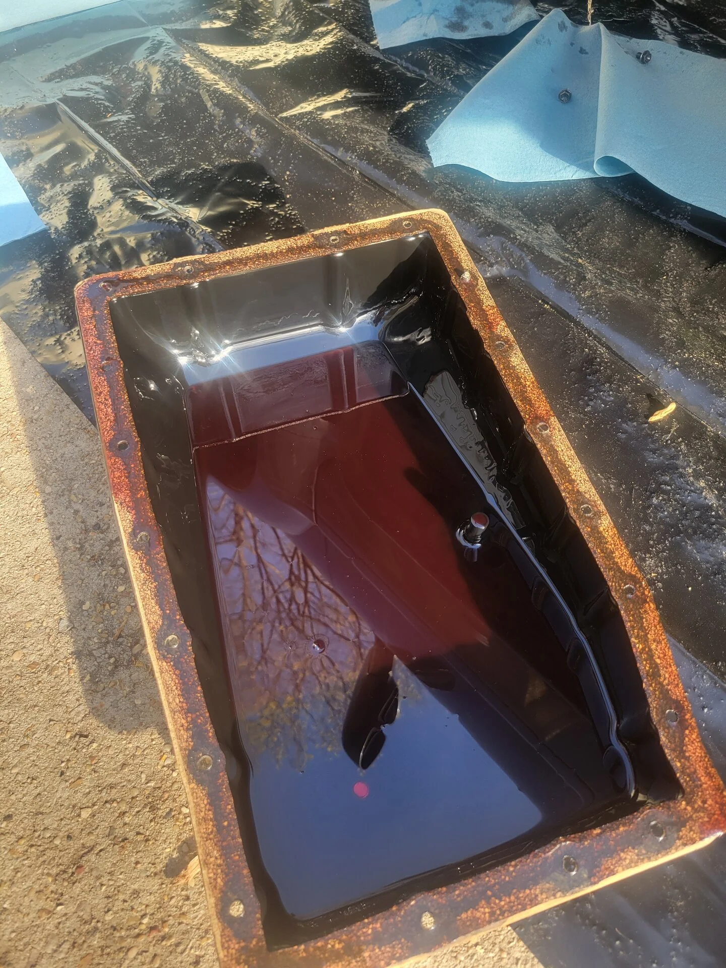

The first day or so after my fluid swap, my transmission was operating great. Over the next ~300 miles I first started to get kind of weird shifts (not as firm as previous - considering I have a Nomad valve body), then I started to get torque converter shudder at 35-40 mph when it locked up in 5th gear on city streets, then I started to get harsh engagement into reverse (not abnormal with my Nomad valve body, but harsher than before), then I started to get torque converter lock/unlock shudder on the highway. The latter appeared on Monday on our way home from viewing the solar eclipse (after I had pre-emptively flashed the ECU/TCU to clear learned values).
Needless to stay this was concerning, so on the way home I stopped off and picked up 4 jugs of MaxLife ATF ($20 post-rebate a jug at Menards) and did another fluid exchange on Monday evening evening. After that and another ECU/TCU flash, my trans is back to operating as it should, and better than it did prior to the flush ~2 weeks ago.
The MaxLife/AT-205/Lubegard fluid cocktail came out kind of light and watery. I'm 95% certain it was the AT-205 that messed things up. They say it's safe for transmission fluid, but it definitely is not. I think it modified the friction properties of the fluid enough to start causing shuddering and the other issues. I was stupid to add it - was hoping to prolong my seals - but I did not have any leaks and MaxLife ATF has seal conditioners anyway. Honestly the TCC lock/unlock is also smooth using straight MaxLife, so I don't even think Lubegard is necessary. The fluid was not burnt in any way and there was not metal in it - so I'm reasonably confident that it did not damage my A750F for the ~300 miles it was in there.
I've also contacted ATP and asked for a warranty claim on the AT-205 and requested that they clarify/update the advertising and usage recommendations in regards to transmission fluid. We'll see how amenable they are to that.
