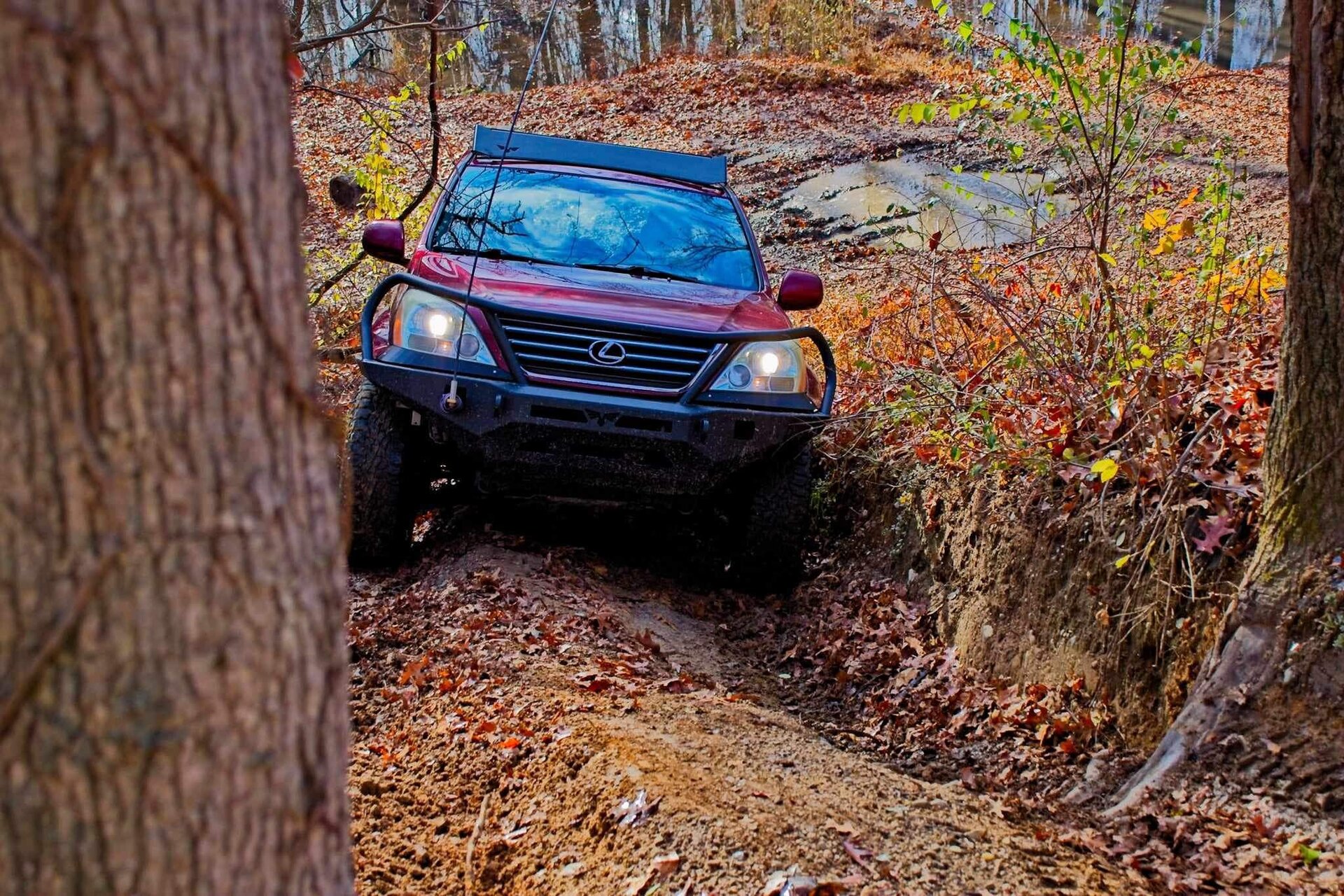

Didn’t get many pics but took it out to a local orv park with some buddies to see how it felt. Atrac is a riot!
Took it to a couple more trail runs and off-road parks to push it a little more, managed to kill a downstream O2 sensor so i have p0430 on 🤦‍♂️
(Tree branch impacted undercarriage on a hill climb)

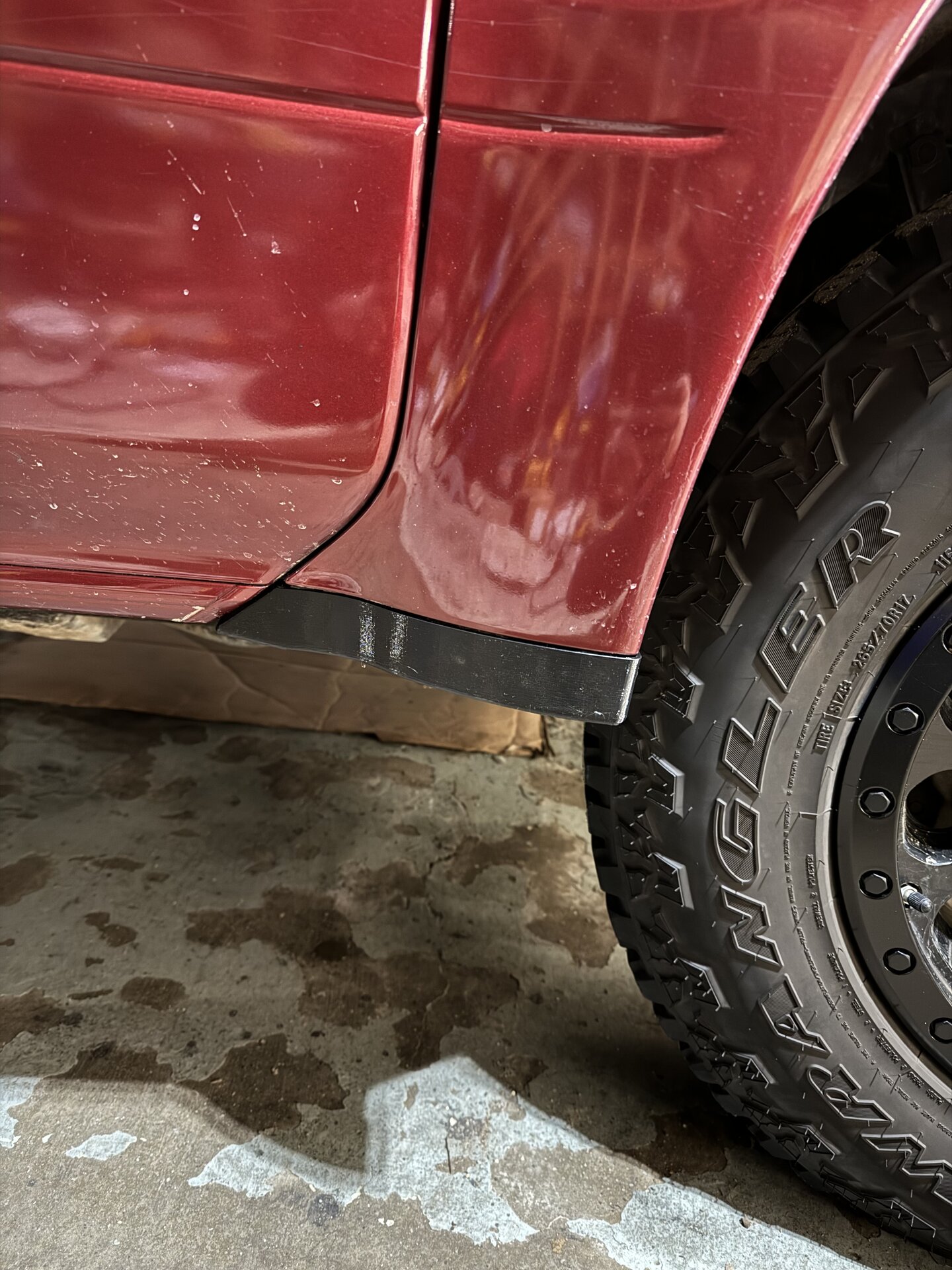

Added a blue dogs designworks filler piece for the ugly little gap after removing the running boards

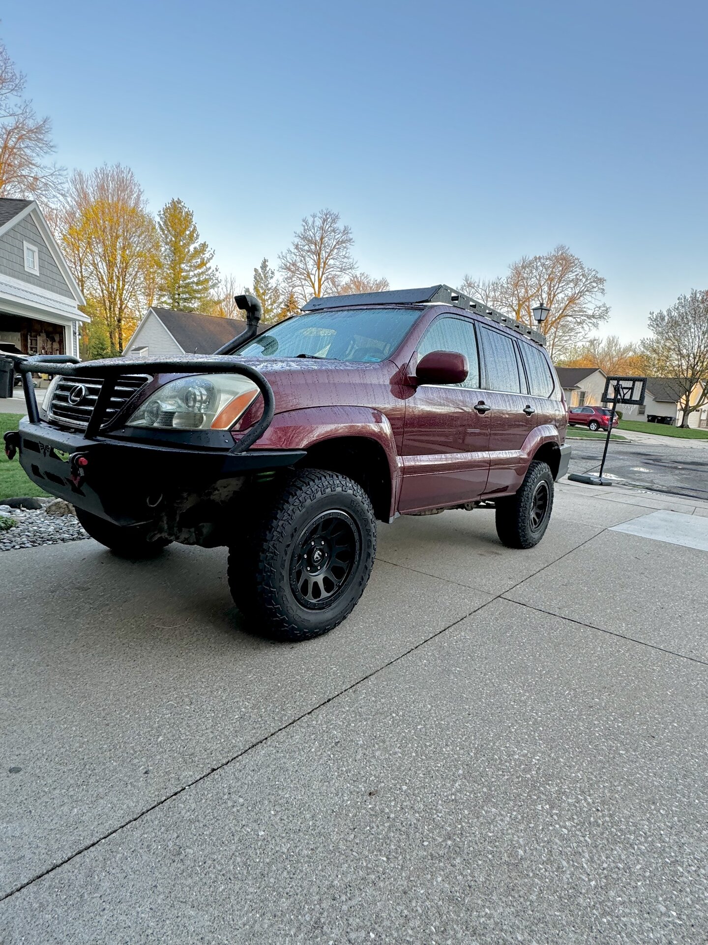

Lift is on.
Ironman FCP heavy front medium rear
SuperPro UCA
Extended brake lines
eBay dorkle
Perry parts bumps and coil conversion kit
Next i have to put the winch on, buy skids, put my breathers on, decide on my lighting set up, and build a table/sleeping platform.

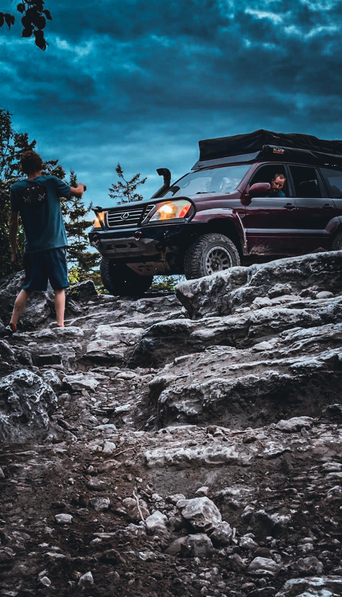

Took about 50 rigs up to Drummond island last weekend with my group. Got my okexpedition skids and diff breathers on just in time. Also added a draw system my buddy traded me for and a RTT.

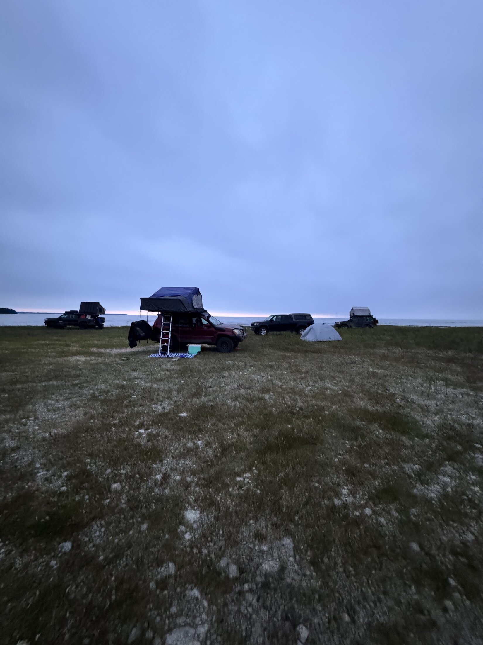

Wandered around the UP with some of the gang from mitten state tours

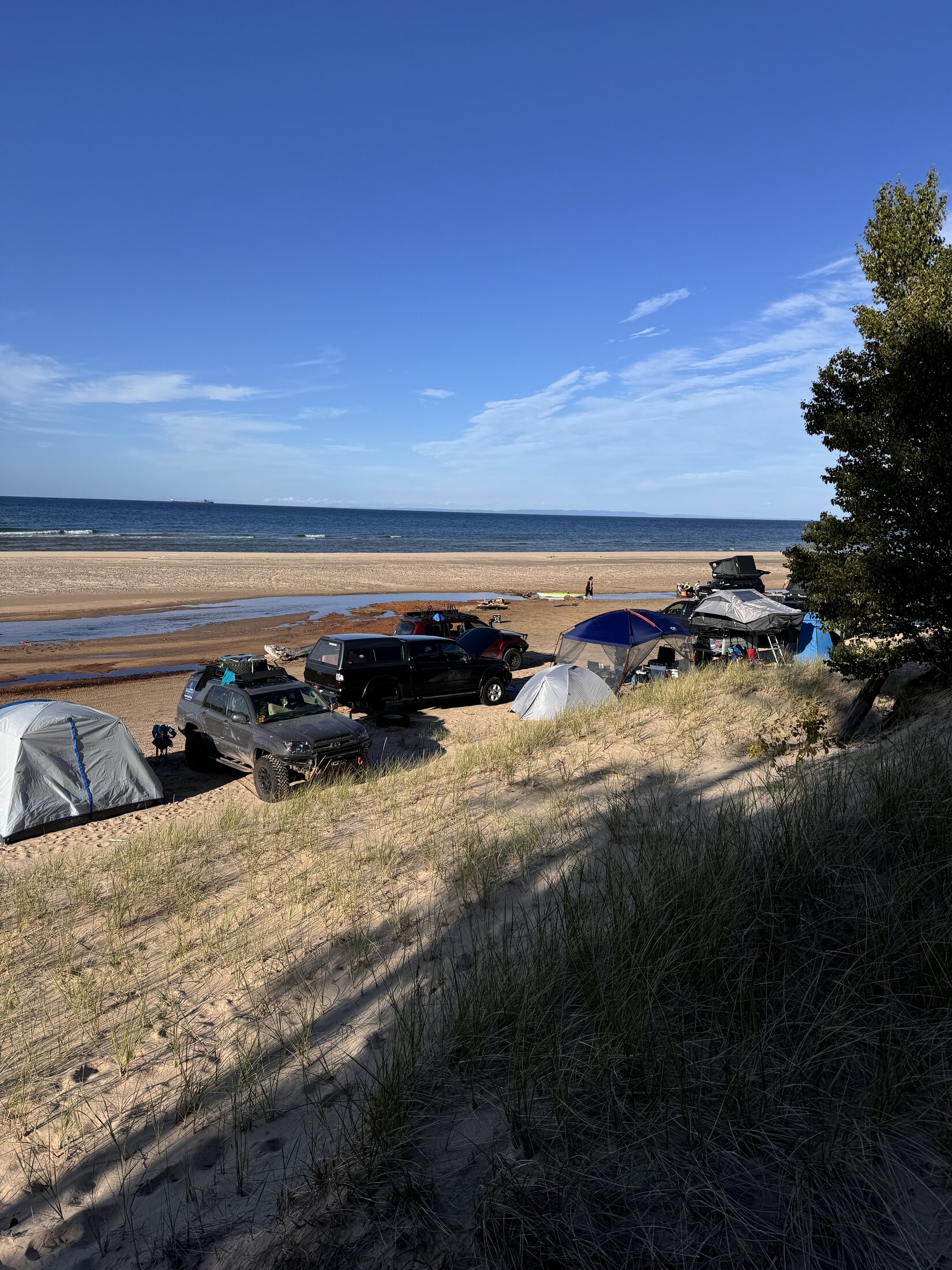

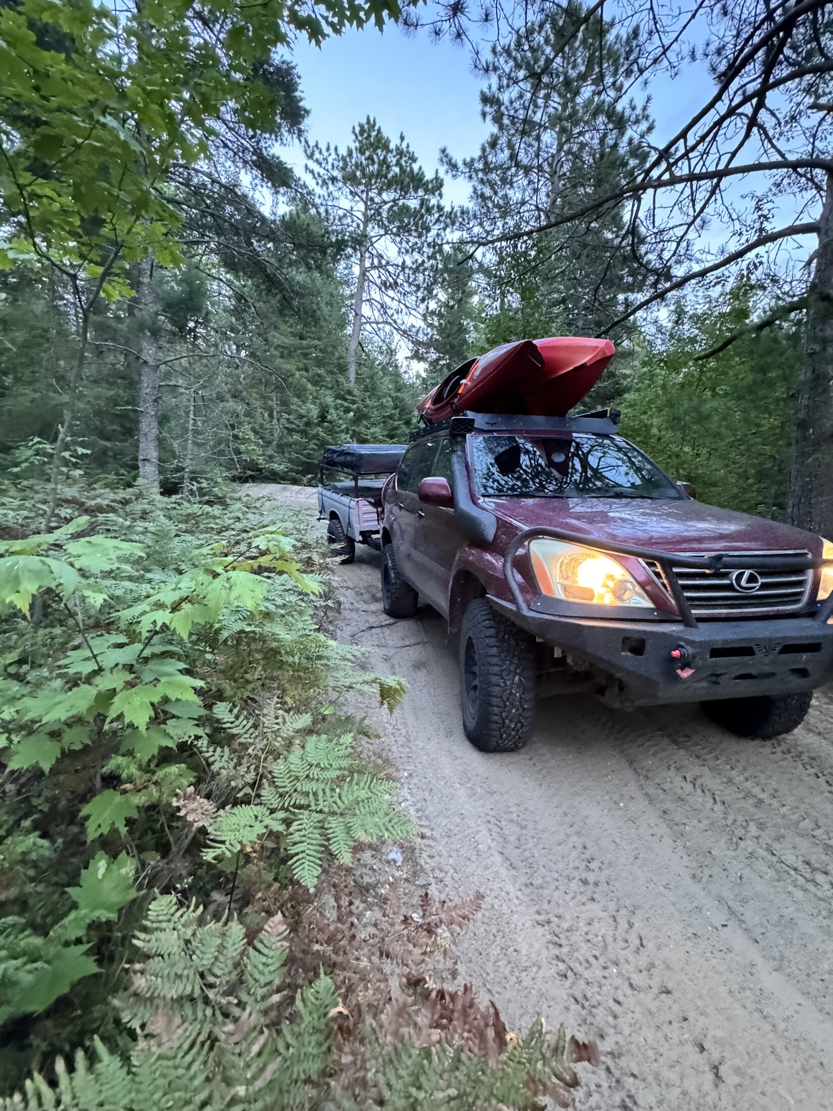

Moved the tent to the trailer to make room for kayaks. Spent Labor Day beach camping at a secret Michigan location 😉 trailer pulls like a dream off road!
Still have to install winch and lights 🤣

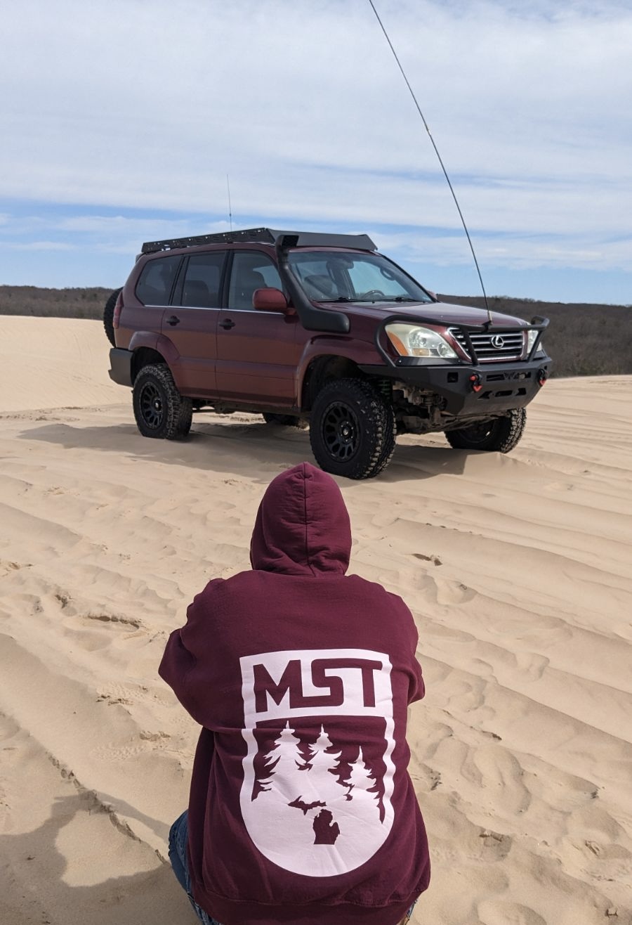

Finally finished front and rear lighting, got my winch on and got a new tent/extended my trailer over the winter.
Swapped out the horrible fuel wheels for some trd style. Still trying to trade for 5th gen trd off-road wheels in gunmetal if anyone around Michigan wants to swap.
