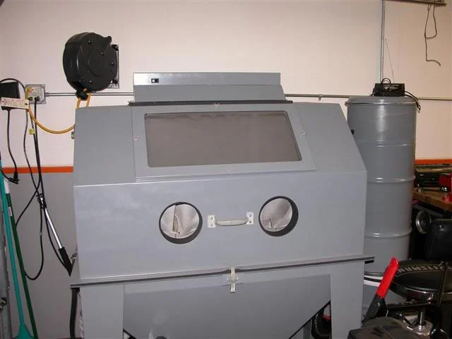

No experience with either. I picked up a used Econ-O-Line a number of years back. Put new gloves, seals, etc. on it. It came with the dust collector, which is a big plus.
What size air compressor do you have? A blast cabinet is a greedy sob. Mine is fed by a 7.5hp IR 24 cfm compressor, and it will cycle on/off when doing extended blasting.

That's a nice looking unit. Have not heard of that brand before but I will look into them. Can I ask what model that is and what it cost you?

Econoline is a Michigan company based in Grand Haven.
Econoline - Built to Blast - Built to Last It's similar to the 42x24 unit (mine is obviously older). IIRC, I paid around $400 for it used. They are substantially more new. It was only used as a soda blaster in an envelope mfg plant (to clean glue rollers), prior to me getting it. I cleaned it all up, replaced the hoses, gloves, seals. Rattle can paint job. Rebuilt the dust collector, light, and added tempered glass to the window and light assembly (I still use replaceable plastic to protect the glass). I also tidied up the plumbing, added a regultor/dryer, and plumbed an additional air line inside to use with a blow gun to clean off parts. Lastly, I added a mobile base. I run aluminum oxide media for everything I've done. It takes over 100 pounds to fill the hopper.
