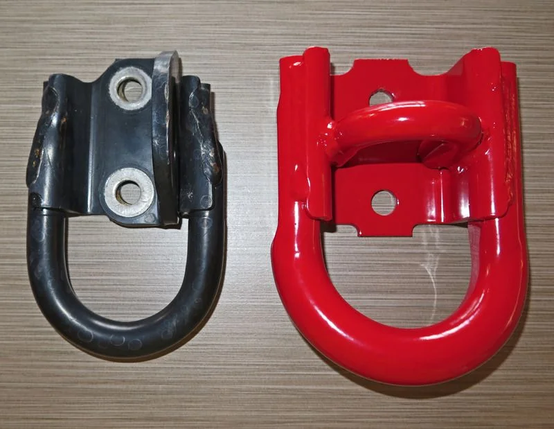

I think your estimated gains may be understated:
OEM LC200 left, OEM Tundra right - powder coated red, of course!
