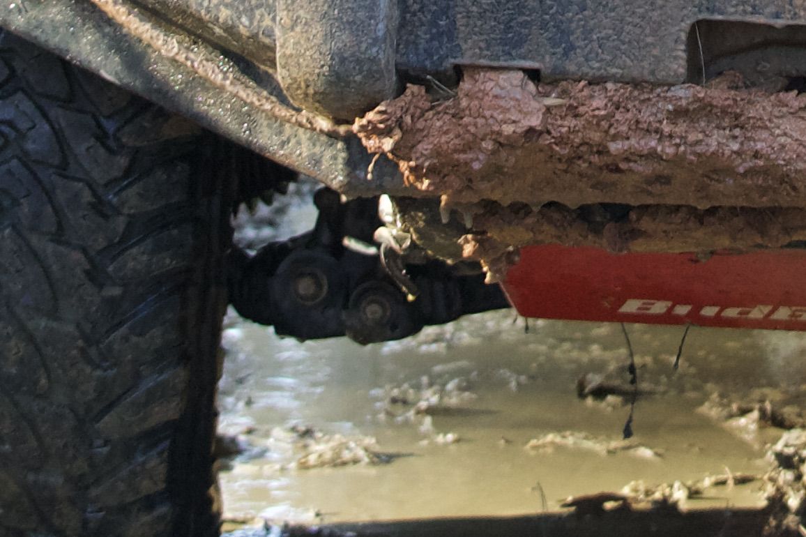

I'm a huge fan of the Factor 55 Hitchlink along with their strong hitch pin you linked to. I do not get the lockable kind because I only put the Hitchlink, shackles, and other recovery gear on when it's time for a recovery, otherwise it sits in the storage bag. Here was a recovery I did in Moab using the Factor 55 Hitchlink, their pin, and a nice dynamic strap (not sure on the brand but it was rated and top quality which I always verify before using). If you look closely, you will notice the places where my tires dug down to the dirt on prior attempts with no movement on the stuck vehicle. Always start a recovery with a slow and gentle attempt and increase the momentum slightly on subsequent attempts. This was our 3rd attempt which is why it looks pretty intense, but you can tell it was appropriate and worked.

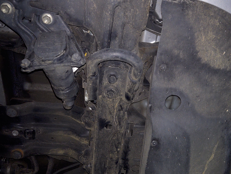

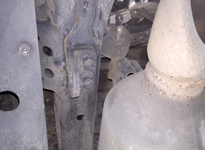

Here are some pictures on my LX ...
Rear left hand - 51968-60020, LX & LC 2008-2021
Rear right hand - 51095-60020 LX & LC 2008-2021
Front left hand - I'm going to replace the LX retainer with same tow hook as LC and LX right hand hook.
Tow hook 5196060020 (5196060010) LC 2008-2021 - missing on LX so not in the picture. Replaced by "retainer" see below. This is Toyota saving money on a $100k truck, go figure.
Tie down 51963-60060 LX & LC 2008-2021
Retainer 51962-60040 - the hat shaped piece only on LX 2010-2021
Front right hand
Tow hook 5196060020 (5196060010) LX & LC 2008-2021
Bolts are the same all around 91672-G1240.
Strange that Toyota designed and installed two different hooks in the rear.
The manual is confusing saying "Do not use the rear emergency towing hook." It does say towing hook. So I think that the right hand rear hook is actually the towing hook not the tie down for securing the truck to the bed. And I think Toyota manual (at least the LX) has an error when they shown the right hand hook instead of the left one. If you try towing from the left one you will indeed do "serious damage to your vehicle" - damage the bumper. Other than that in the worse case it might break the hook but for sure it will not be able to damage the frame.
So if the right hand one is the towing why did Toyota not use the same design as in the front of having the tow hook reinforced by installing the tie down over it. I'm not even sure the tie down hook would fit over inside the rear hook hat. Installing a front tow hook in the rear does not work as the hook will be under the bumper cover that will get damage if hooked.
I do have a hitch shackle for rear towing but I'm still baffled by Toyota design choices for towing points in the rear, especially compared to the front.

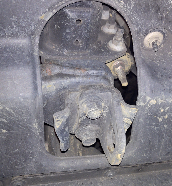

Does anyone know what the torque for the front recovery points bolts is?
I looked in the manuals but could not find the recovery points.
I would guess about all you got with a 1/2” drive ratchet
I spent a very long time digging through the manual trying to find that value but never could. IIRC it’s the same size bolt as for the front bearings and 08-15 front brake calipers, which are 73ft-lb.
And you won’t catch me going ham with an impact gun on any bolts that thread into irreplaceable inserts in the frame.
