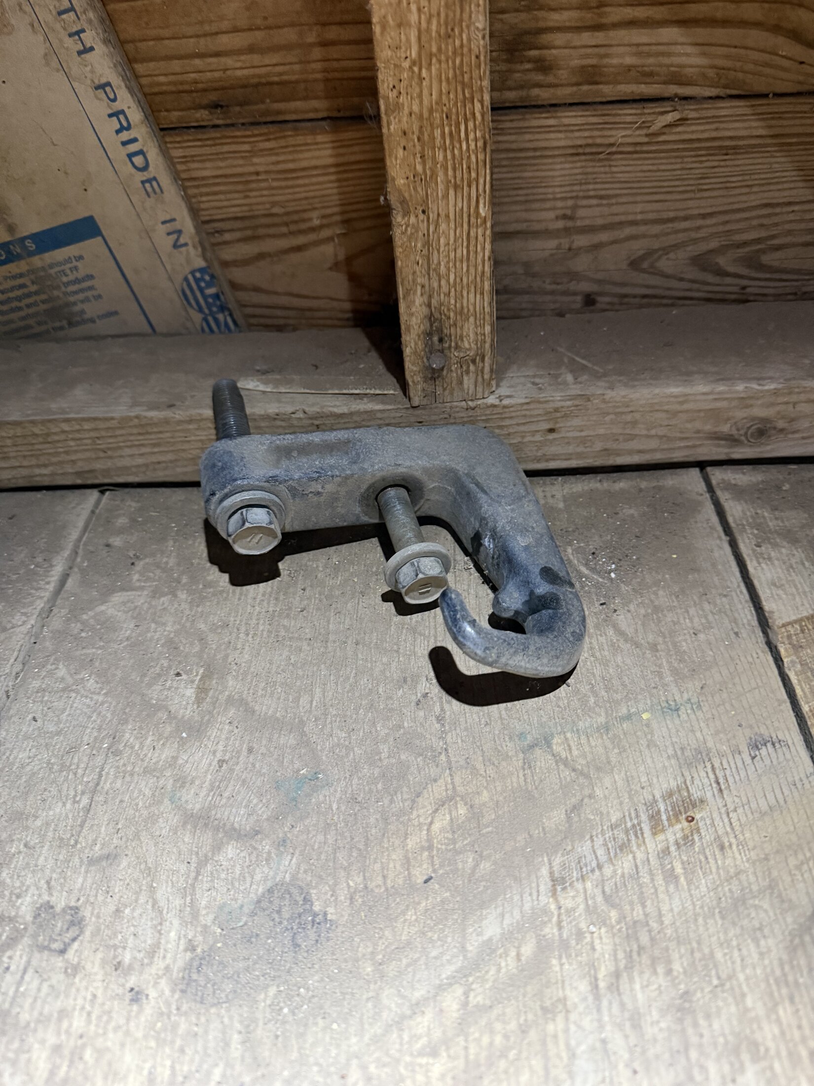

There should have been one of these on the front.
It’s OEM, and would help in a pinch, but not quite the same as the other recovery points shared.
Yeah, that hook looks light it MIGHT extend down just low enough to peek out from under the bumper but mine does not have it. 😕

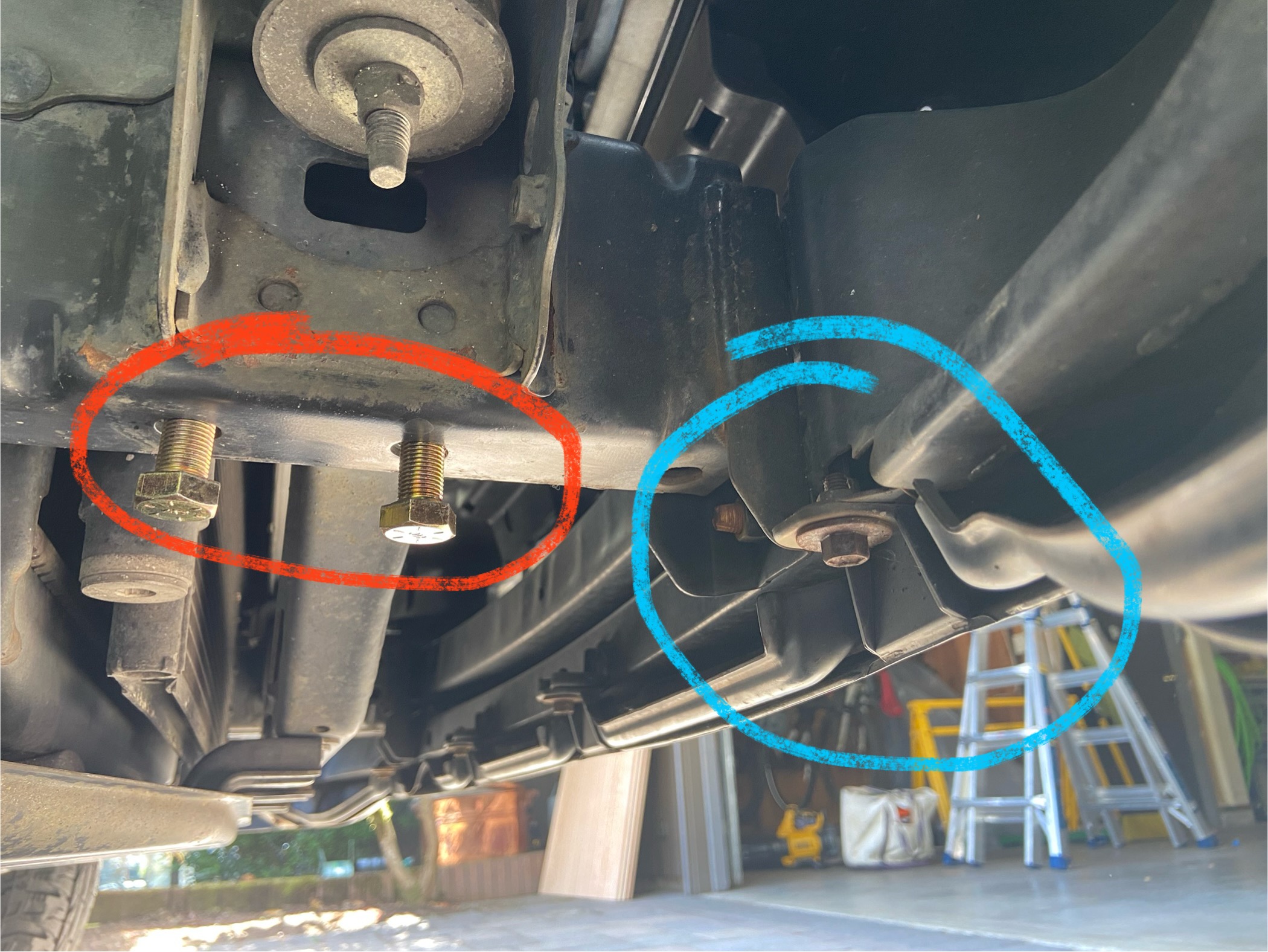

Incorrect. Here’s proof:
Recovery mount point in red, bumper mount in blue. It’s a 3” drop from the bottom of the frame rail to the bottom edge of the bumper, and there is nothing flexible in that area.

That OEM tow hook is just OK for careful, on-road towing. It could get dangerous in case of a recovery.
(Although, I used it once when the truck was new, after getting stuck in snow, and it held. Stronger than it looks. Two wheels outside the road because the plow-tractor had made a nice flat surface well outside the road surface, with only a deep ditch under. Same plow-man was decent enough to pull me up again. Could have gone OK if the hook broke as the direction of the rope was well below the driver)

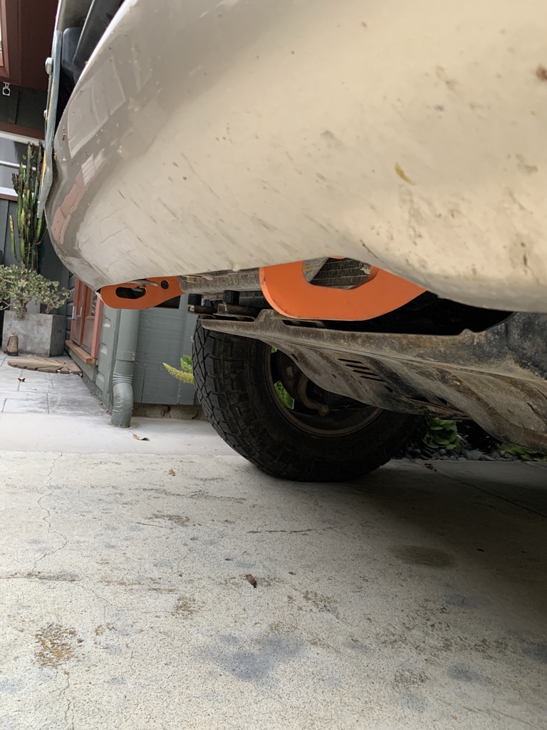

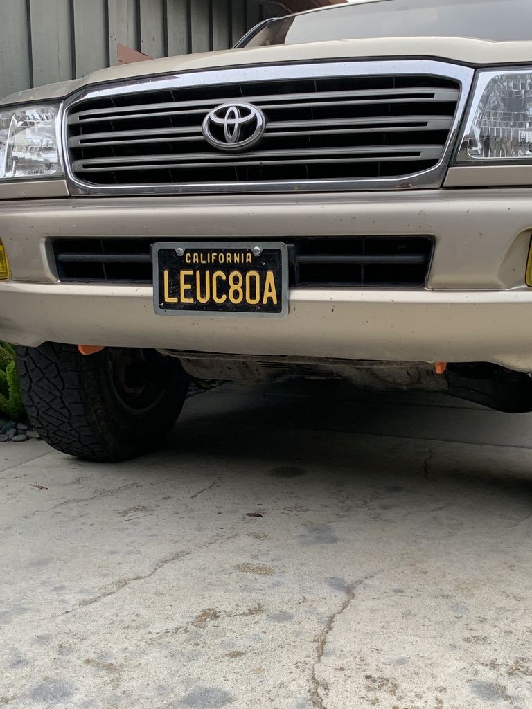

I ended up with a pair of the “recovery points” to deal with the stock bumper as well.
With the .25” thickness of the hidden winch mount, and some custom .5” spacers I cut and drilled, it lowered the recovery points .75”, so they just Peek below the stock bumper.
I’m hopeful this will work for recovery being done carefully with the stock bumper.
