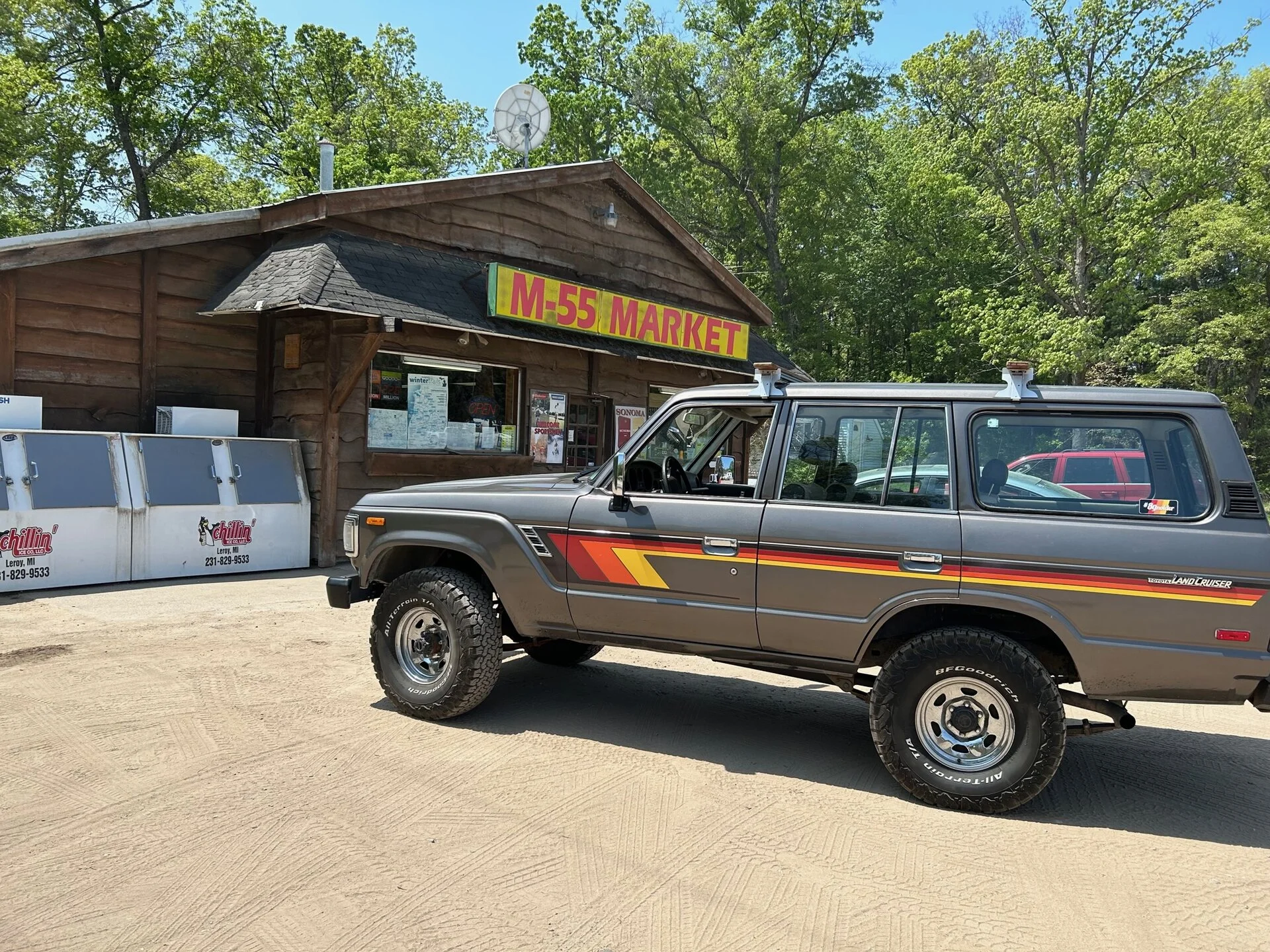

TAMCO is great and has incredible customer service. I purchased all the supplies from them, including cleaning supplies, primer, paint and clear. Super happy and not terribly expensive. Think it cost around $1k for everything. Painted in my driveway.
