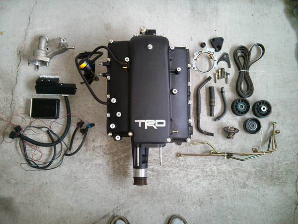

I really love my hundy soo much that I started looking for excuses to spend money on her. I found a TRD super charger on craigslist so I had to put her on (even though power wasn't too bad stock):
Today we are in the middle of installing at my shop, still need a few more parts (it took an extra week to get a second refurb starter delivered, first one was missing plastic piece):

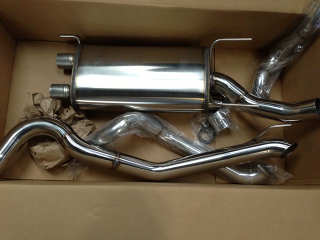

I have the EMS Catback with silencer installed:

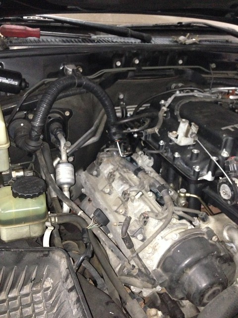

So today we are finishing up the install and we call Gadget and he suggests not even to bother connecting the solenoid in the back here. I recognize he knows what he is doing but just curious. My mechanic says if we dont need this he doesn't need to put the 3.25" silicone hose coupler connector.
We are having two issues left with putting this together:
1.) Below super charger pulley is not lined up perfectly with ac compressor. Should we move pulley out to line it up perfectly with AC compressor? It starts slipping currently since the SC is a bit more inward.
2.) Having issues with getting the MAP3ECU programmed. Hiring someone to come out to program it.

Does the supercharger pulley have shim options to move it in and out?
So after weeks of tinkering we figured out that Gadget miswired the ECU harness from URD. We shipped it back to him and he sent it back wired properly (loaded with the Tundra 4.7 SC map as well).
Right now the last problem I am having is that we have tried 10 different pulleys and all of them seem to be slightly off. Anyone have any insight on this? When we give full throttle the pully comes loose a bit off the tensioner.
