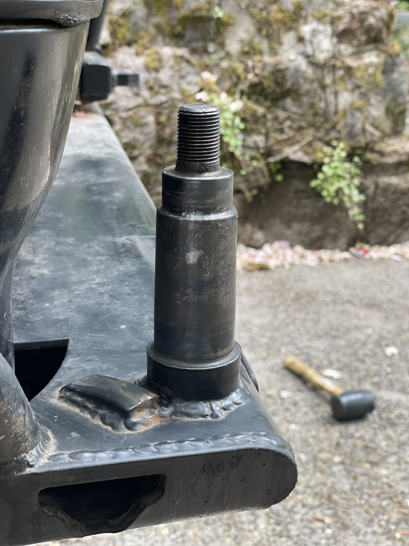

Victory is mine.
If anyone else runs across this thread with the same issue - here is what worked for me.
Constant pressure from the hi-lift didn't do much in my case - what did work was I put a block of wood under the swing arm as close to the spindle as possible and applied violence with a 3lb persuading stick from below after having heated the top bearing with the MAPP torch.
Felt like it really needed the shock load to break it free.
