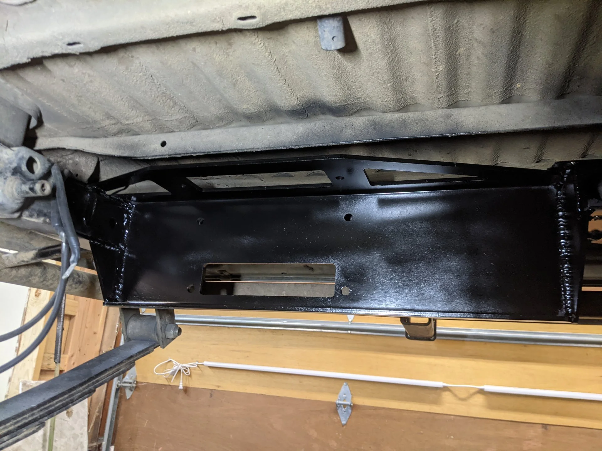

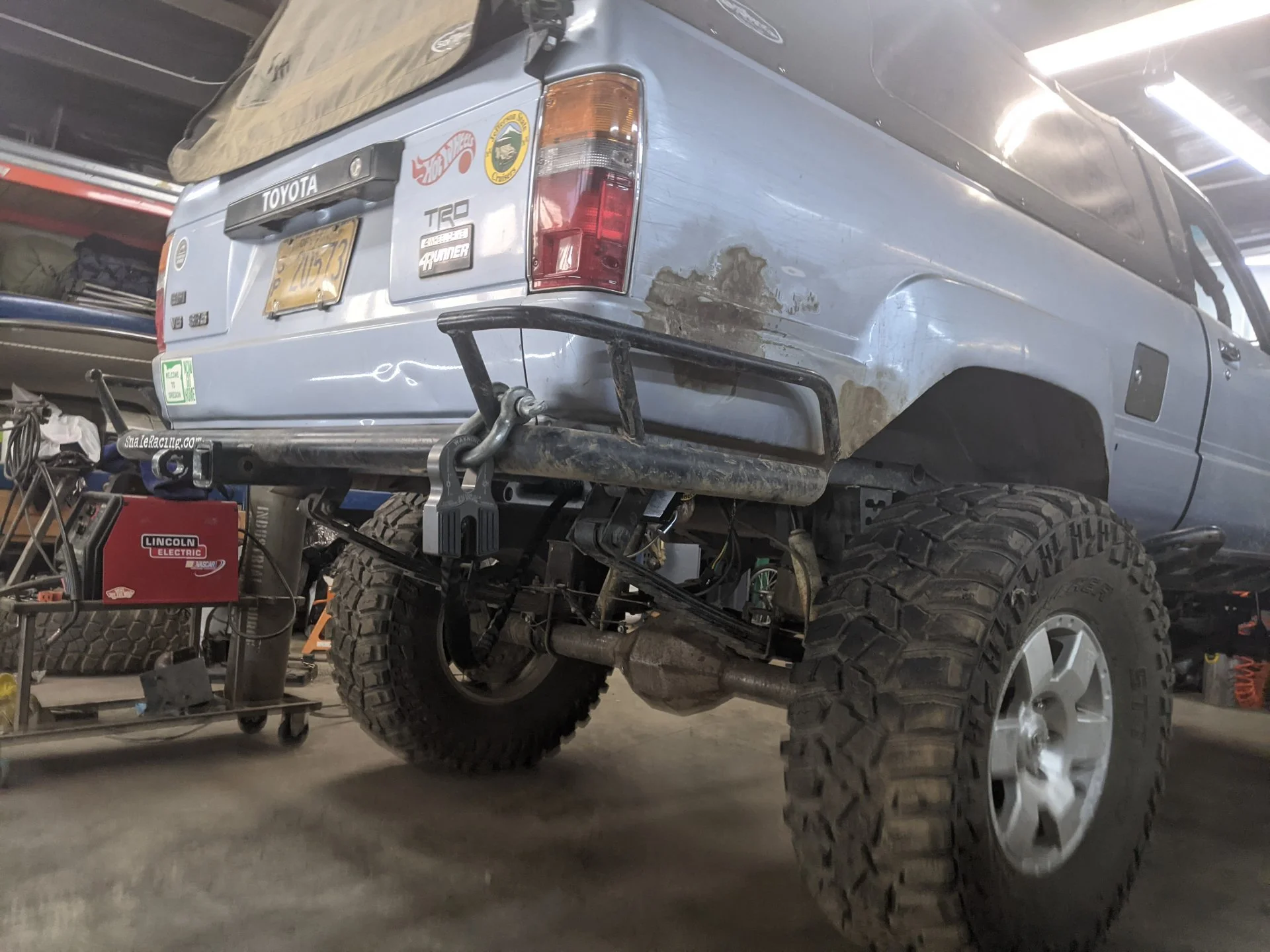

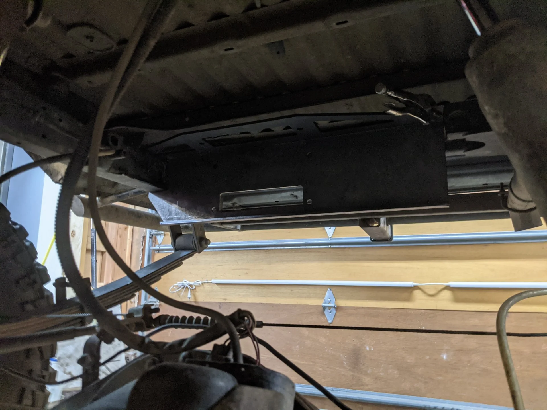

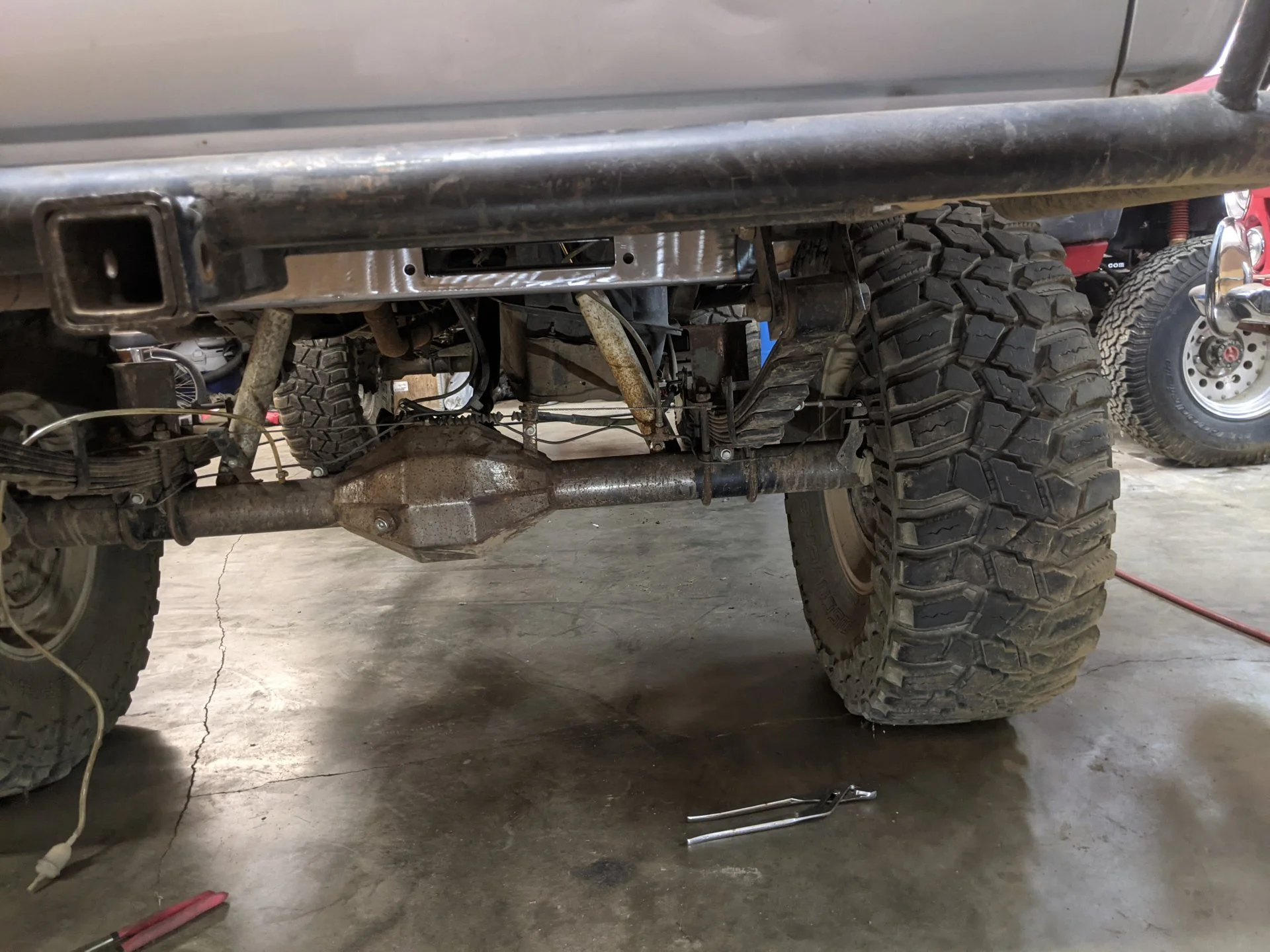

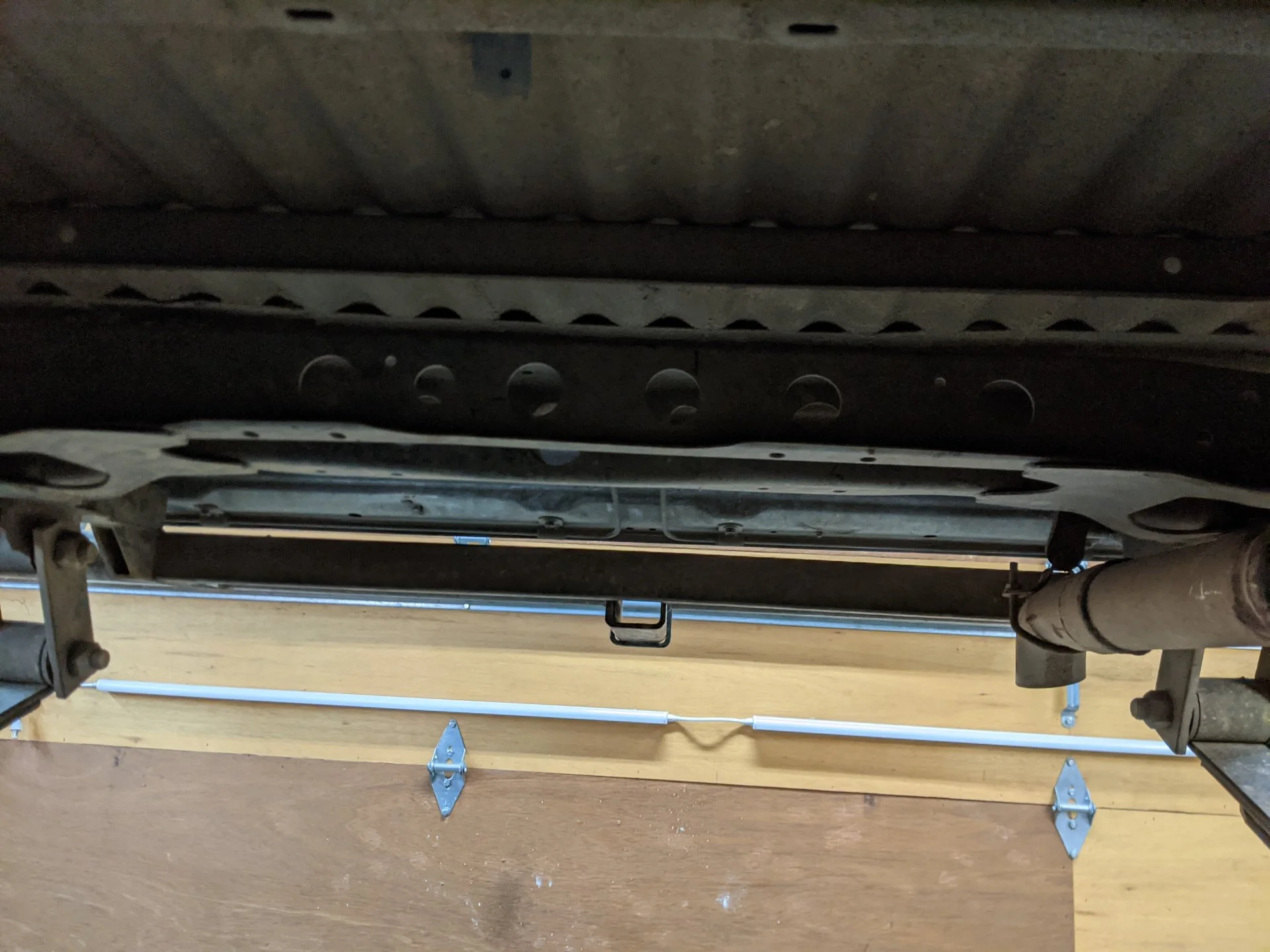

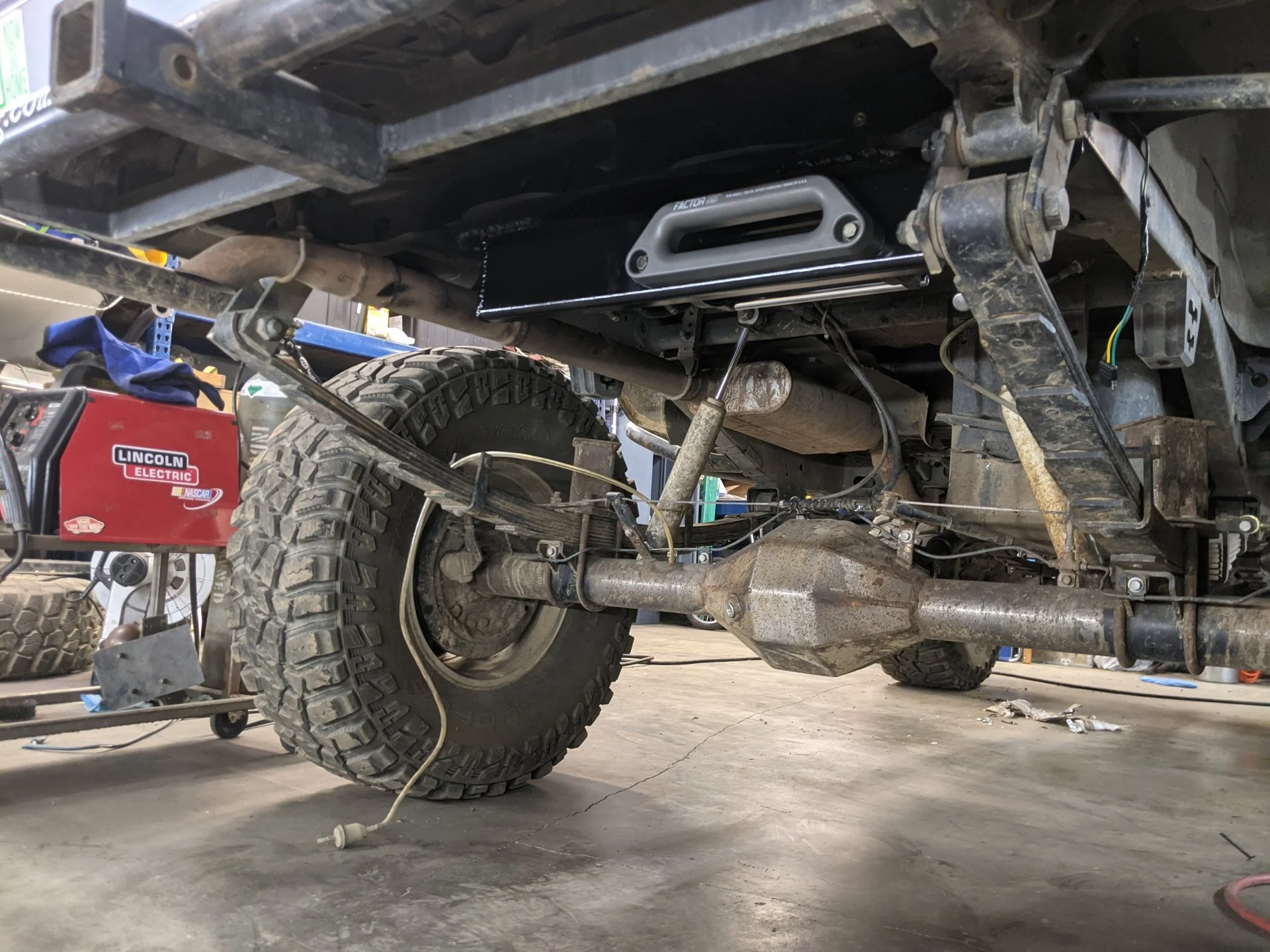

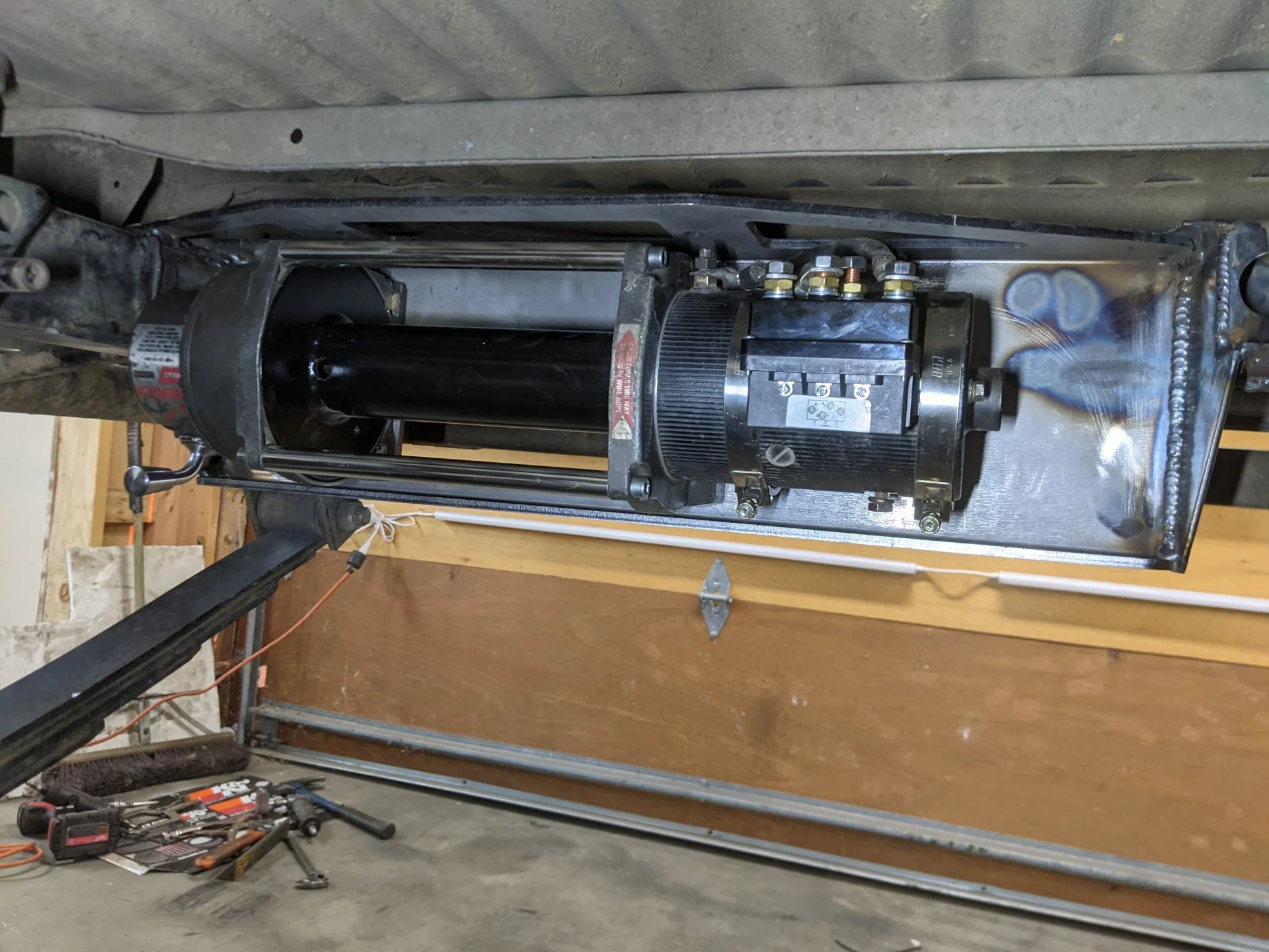

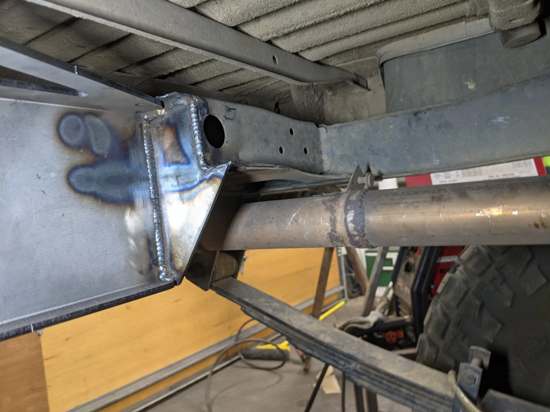

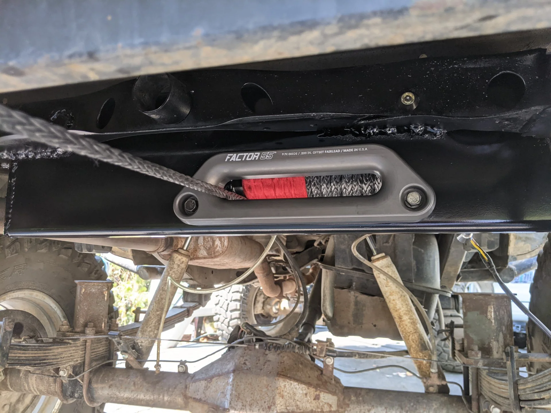

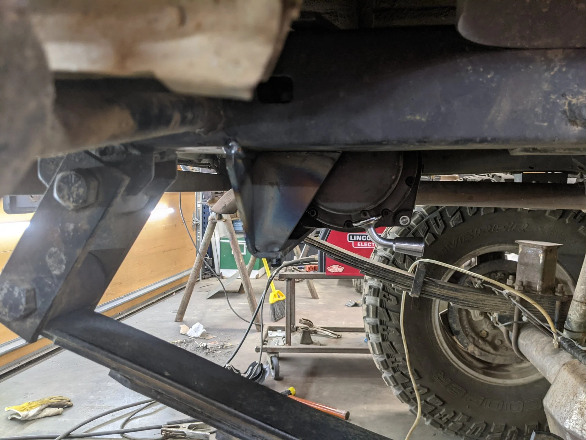

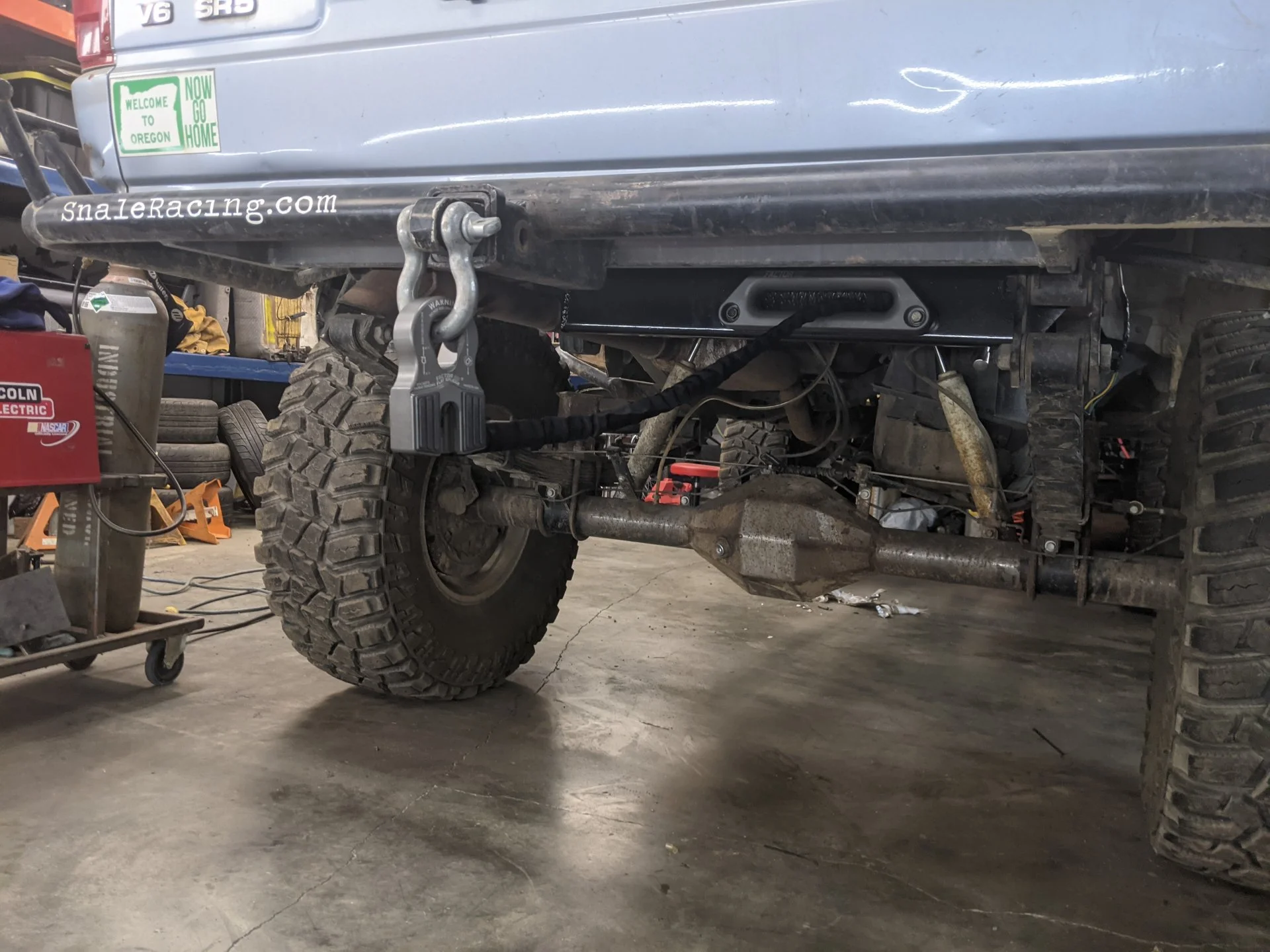

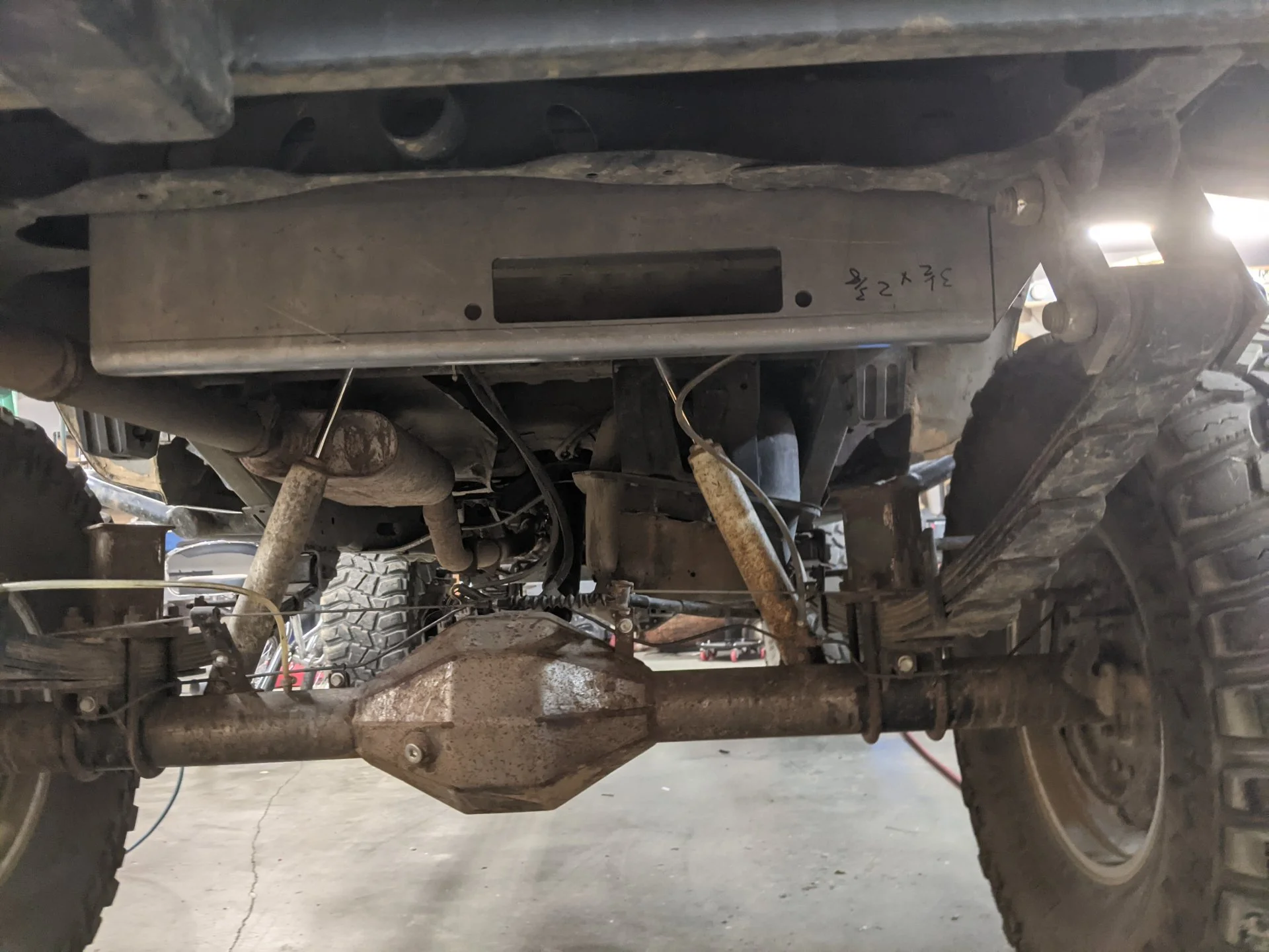

Decided to build a rear winch setup. I started with an M8000. Wanting to mount the winch foot forward creates a little issue. Okay not too big thanks to Barnes 4wd. Picked up their dual pull plate.
Dual Pull Winch Plate 33 Inch Wide - https://www.barnes4wd.com/Dual-Pull-Winch-Plate-33-Inch-Wide_p_915.html
Then i started fitting.
I'm glad you posted this. I've been thinking of a rear winch. Too many times I had to turn around in some precarious spots to winch the truck behind me.
Have you used it yet?

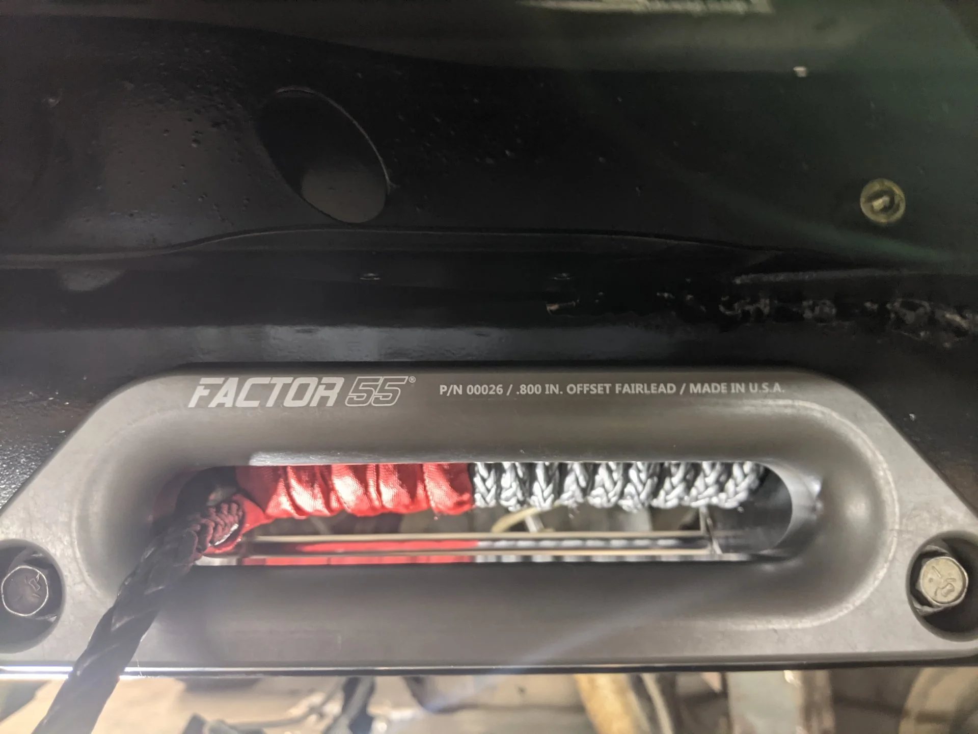

Have not used it yet. I gave a weak attempt to tension the rope this weekend.
I've been wanting to do this for a while now.
Like you said, there's not always going to be an opportunity to turn around. Or the others youre with dont have winch etc.
Also the potential for stupid side hilling. Lol

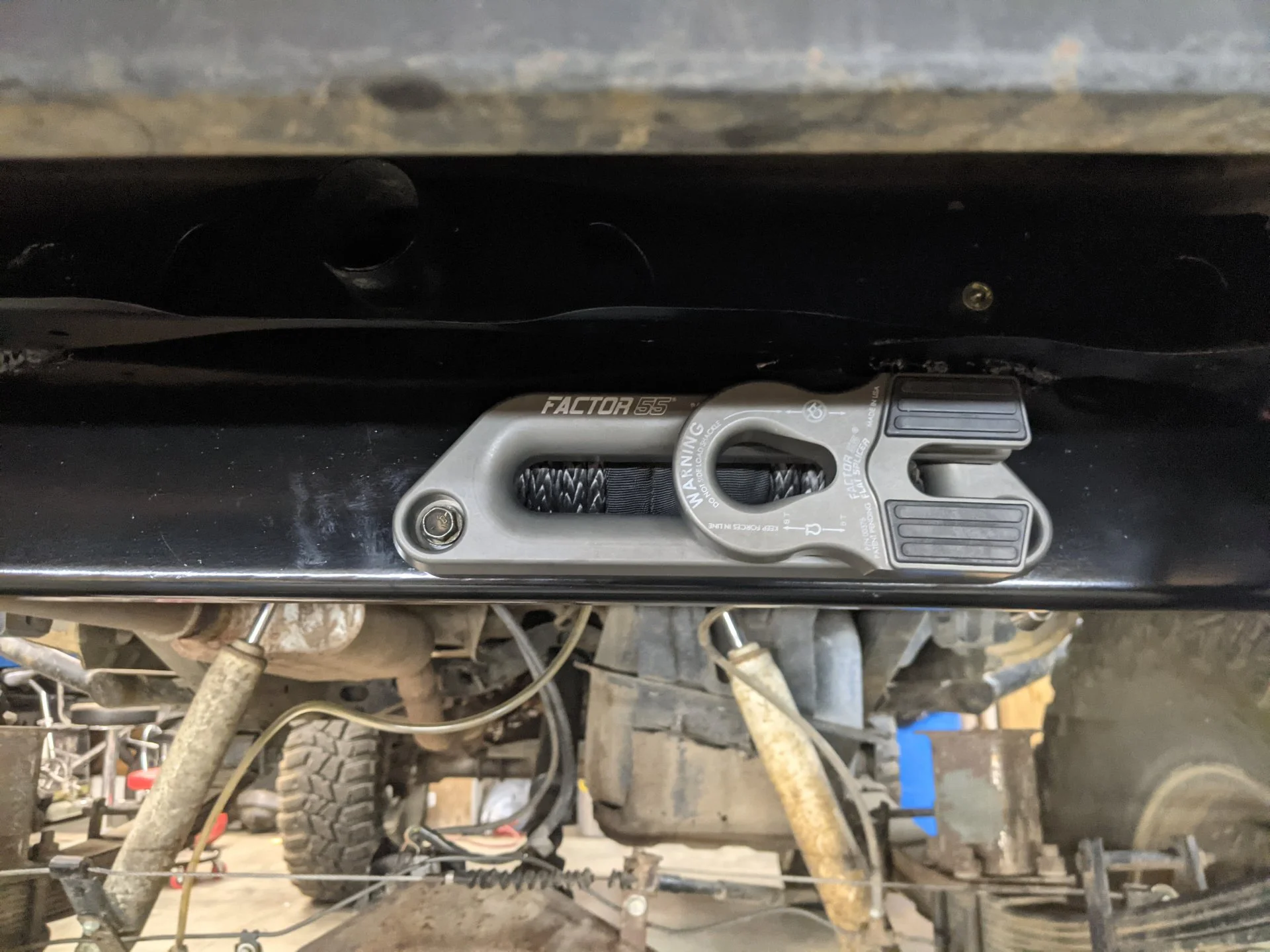

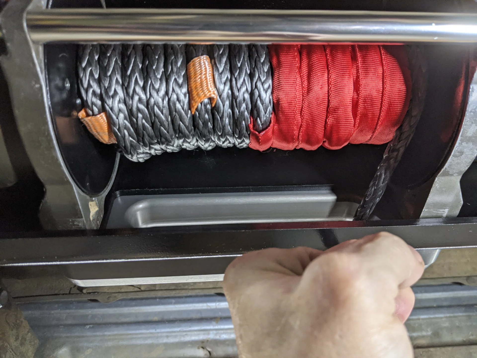

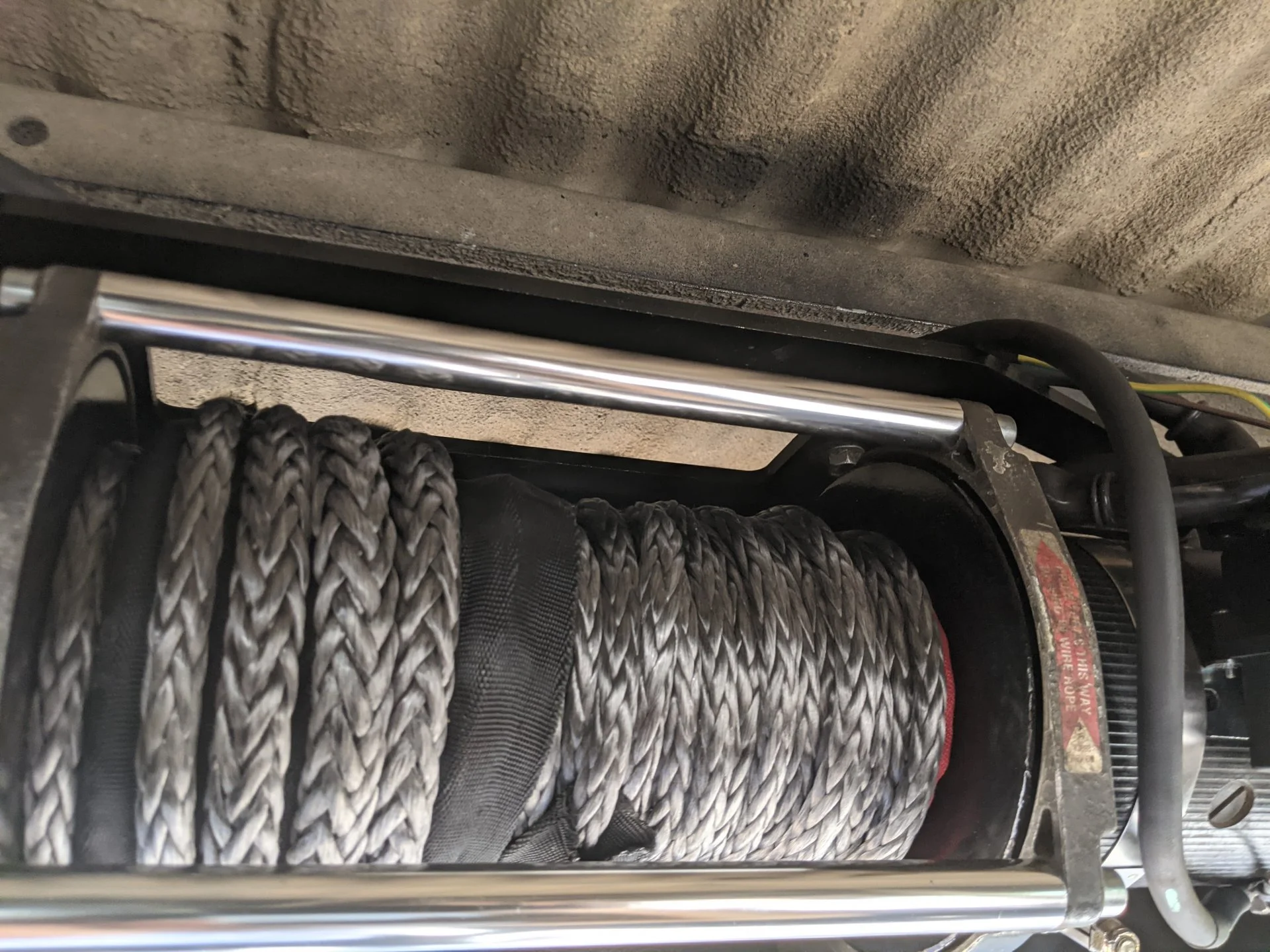

Ok. I actually used it to tension spool the rope. ;)
I cut down a (3/8") 95' rope. I have about 60' usable. I used the drop to build a 25' extension.
