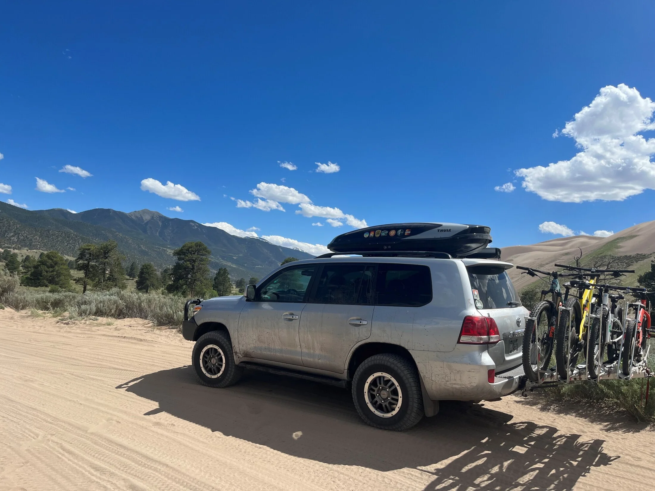

I run the Bilstein springs in the front with OME 2721s on the rear and they sag to about level with the rear full of gear and a 4 bike rack on the back. My fronts are on the lowest perch. They sit with a little rake unloaded.
Should be about perfect for you. In this pic I have a week's worth of gear for 4, plus about 250lbs of bikes/rack hanging off the back.
Swapping rear springs takes about 1-2 hours max with a floor jack, so I'd throw them in and see what you think.

Thats exactly what i was looking for! Thank you sir!

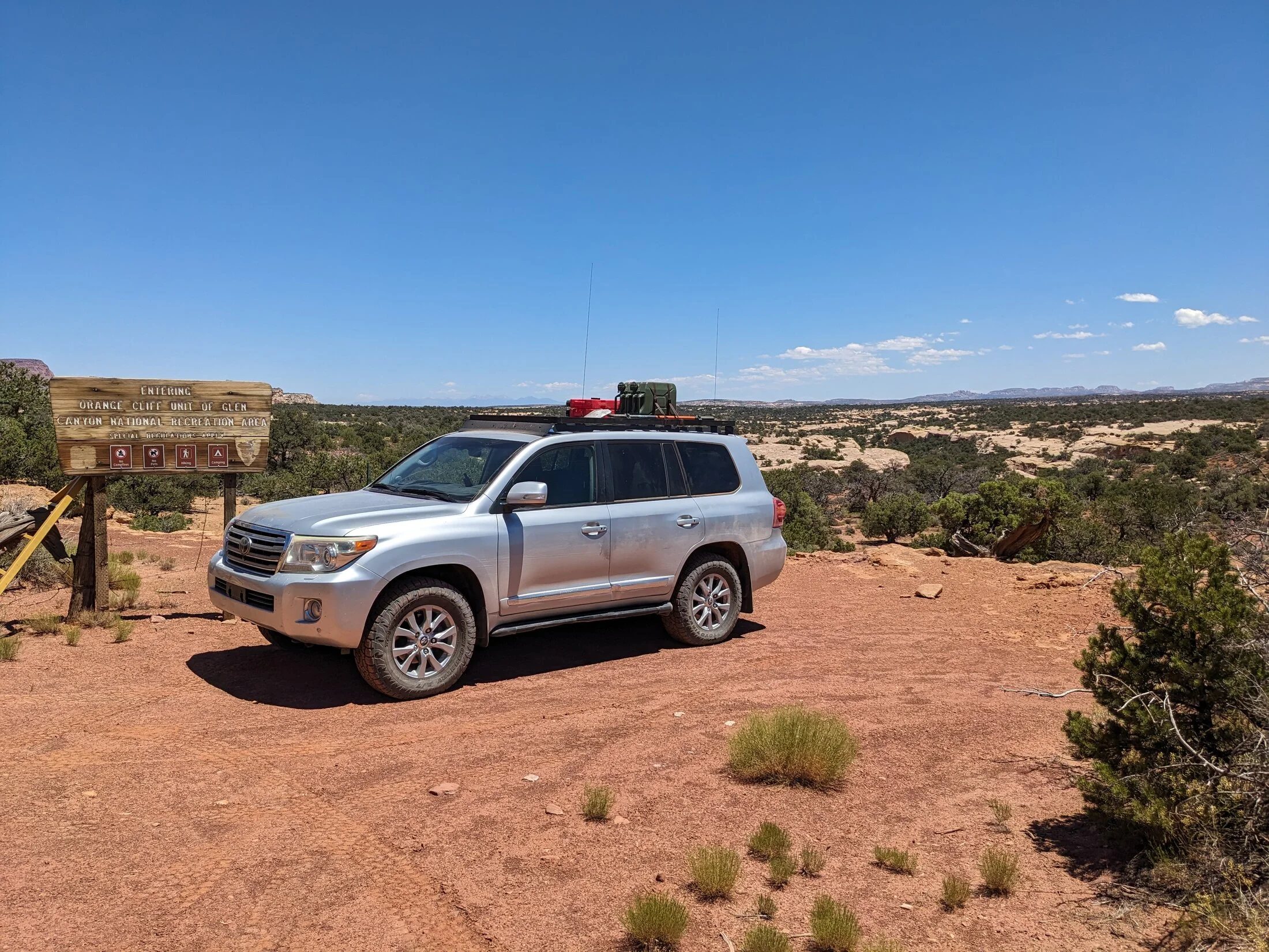

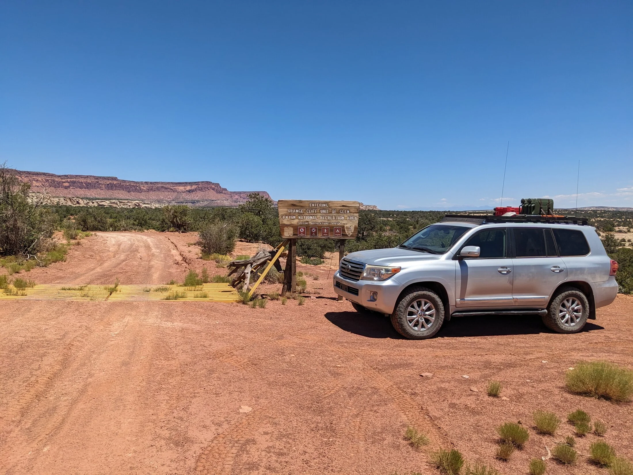

Yes that is my setup. I can't remember if I ever had the Bilstein rear springs or not. But I had the OME 2720 initially but needed more lift in the back so swapped with 2721.
These pics are with the truck loaded with camping gear, minus about 250lbs of water/fuel. I think the lowest perch up front, and 2721 in the back.
this post has some pics/data with the OME 2720
