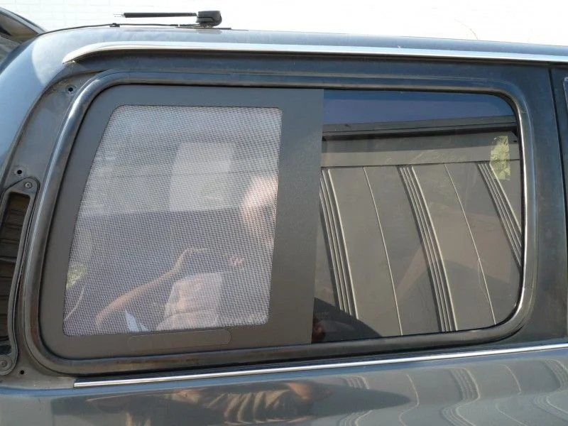

I've just done the swap from the fixed/solid windows to the sliding ones. :hillbilly:
Well, that's not exactly true.... I had a friend who runs a bodyshop do the swap for me. :D
I snapped some pics of what's involved, but not all of it! :doh: (I had to hold the glass with both hands so it wouldn't fall!)
The sheet metal looked clean, with no sigh of rust, but I'm a bit worried as the (used) sliding windows that I had replaced the fixed ones with had rusty screws and stuff at the bottom. If I can I will see if I can inject some silicone so I can minimize the chance of water getting in there.
This is a mod that I had been wanting for a LONG time because I wanted to have the 3rd-row window screens made. The shop I've been dealing with with the 2nd-row screens wanted a sample 80 with the sliding windows. Anyway, I've made an appointment to have the measurements done this afternoon for them.
Anyway, here are some pics of the windows, including those with the OEM screens.
My kids are excited that they can get better ventilation. ;)
BTW, I decided to keep the factory bars across the window so I can eliminate the chance of my kids falling out of there! :hillbilly:
If you've been contemplating this mod, I would not hesitate in getting it done!

Oh yeah, a small note... the ventilation louvers that I used to have won't fit (Different PN's). :doh: So I'll have to look for used ones.
I guess the sliding windows make it "thicker" than the single/fixed windows.
BTW, did the US-spec sliding window (RH) slide both front and back?
On mine only the back one slides forward, I guess because the front would be hard to access with the rear ac duct that came out from the quarter panel, etc...
