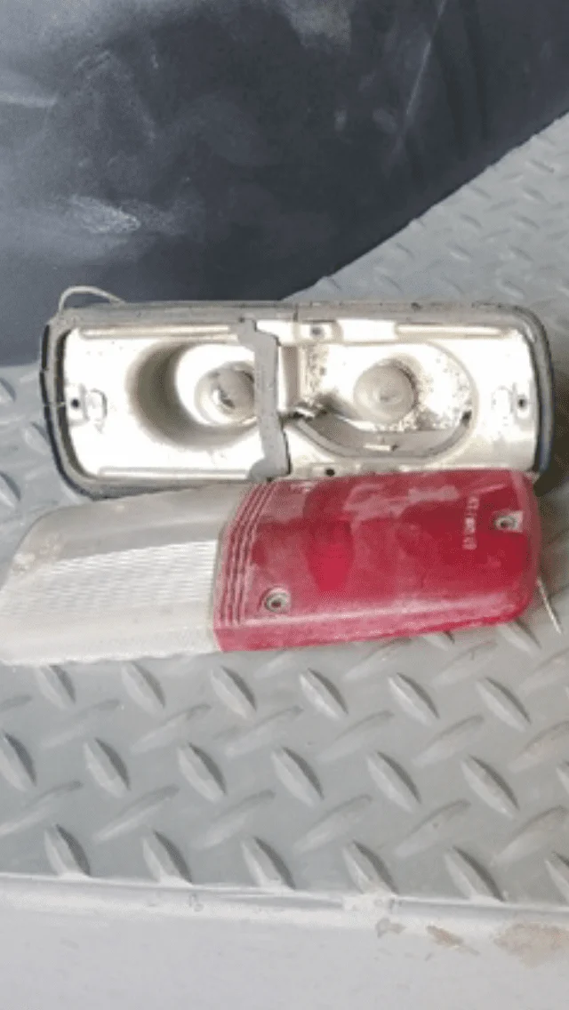

My current one on the drivers side bleeds power back through when the brakes are applied and sets off the left turn signal. Never had that problem before this latest build...?????
Any advice is appreciated.
No such thing as a silly question friend, no we didn’t try that, but we will now ! 👍
And...?
We tried 4 different bulbs, the wires are shorting against one another inside the fixture....
If you push on the wire , no bulb in place, there is an insert that can come out. Seems like an easy fix.
Hey...that appears to be exactly what I need ! Thanks...I’m on it !
