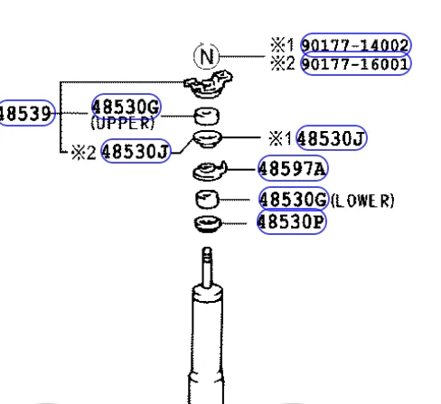

I'm not sure I follow you. Are you referring to these parts?
I've never heard of having to cut a hole in the body to replace these bushings; or any other replaceable parts on the truck, for that matter. Do you have the service manual? There are copies for free download in the Resources forum section.
FWIW, even if there were no bushings on the shocks, they would still work; they would just rattle themselves to death. Eventually. But that would take time. It would make driving annoying, but not unsafe.
Of course, I'm a redneck who grew up driving tractors and other farm equipment, not limousines, so my opinion is a bit colored.
Yeah that's the ones!
Apparently it's common practice to cut a small hole in the boot floor to access the rear shock top nut to aid in removal (and replacement of shock and/or bushes).
Thanks! I can't say I've noticed any noise going over bumps etc like I've had when top mounts have gone on front shocks in the past, so I'm hopeful it's not an issue yet anyway. Apologies for the confusing terminology!
