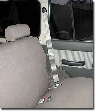

Burger, I just finished posting on another thread for shoulder belts. I did this "conversion" on my Venezuelan-spec FJ62, which came with NO seatbelts in the back seat. Mine had the threaded hole, so I retrofitted the US-spec FJ62 retractable ones. Minor mods to the rear cargo side covers was needed, but it was very straightforward. I'll take pics this afternoon and post them.
