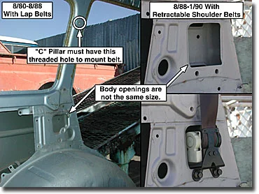

check Sor cruiser parts, I got retracting seat belts to install in my bj60, they are a bit of fabrication. I had to cut the hole bigger where the retractor would sit. I welded a think plate in there and I will bolt it in there.
but the pictures SOR shows on their web site may help ya.

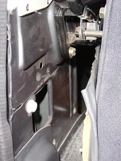

no cut out? post a pic of behind your panel, I would like to see what yours looks like.

here ya go... I didn't want to take out the camping kit or the car seat to remove the panel fully, so it's just a peek view from the seat side on the right hand side...
ok, wow that is much different. fn yota!
so IMOP I would go to the non retracting shoulder harness. The ones sor sells. basically you use only the threaded hole uptop and your only retracting part is the new lap belt, the shoulder harness part you manually adjust. like the first stlye shoulder belts in many 70's cars or older.
other option buy fj62 retracting rear belts. and make a cut out for the mechanism. then the structural integrity has to be installed(big doubler, thick steel all the way around) weld in a couple high grade nuts and your set.
I am doing the later. I cut the whole bigger much like seen in the upper pic. I welded a plate all around. and I will use a large piece of angle iron in behind. I am making it waay beefier than the front seatbelt mounts.
