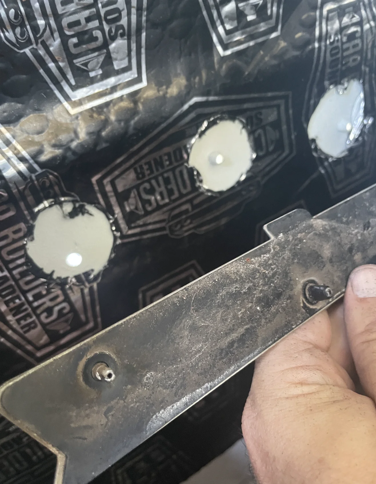

Any tips on how to fit these.
- I have badges with pins in tact.
- Some of the pins had a small black-surround on them, but not all
- The panel has both plain holes OR hole with a little plug on them
- Badges have some kind of thin black gasket.
- I put some holes in the sound-proofing to ensure I could access it.
This pic shows these items? So any tips on how to connect the badges? Do they clip in, or have something on the inside to keep them in place? Or do people just stick them on.
You will need to get some new emblem clips (your black surrounds) place those on the pins and push the emblem in place. SOR has the clips and I'm certain other places as well. If you have a new paint job, it may be necessary to clean the hole out some for the clip to fit properly.
Right there by your thumb is a black tin clip in that Center post. Slide it off or not. But each
post should have a black tin clip around it. That keeps them in place. once you are all painted up
from the outside just push the posts through the hole. If you have three tin clips off, then slid them
into the body panel hole first. They shouldn’t push through. Then push the plastic posts of the
emblem into the clips in the holes.
BTW, nice job soundproofing.
