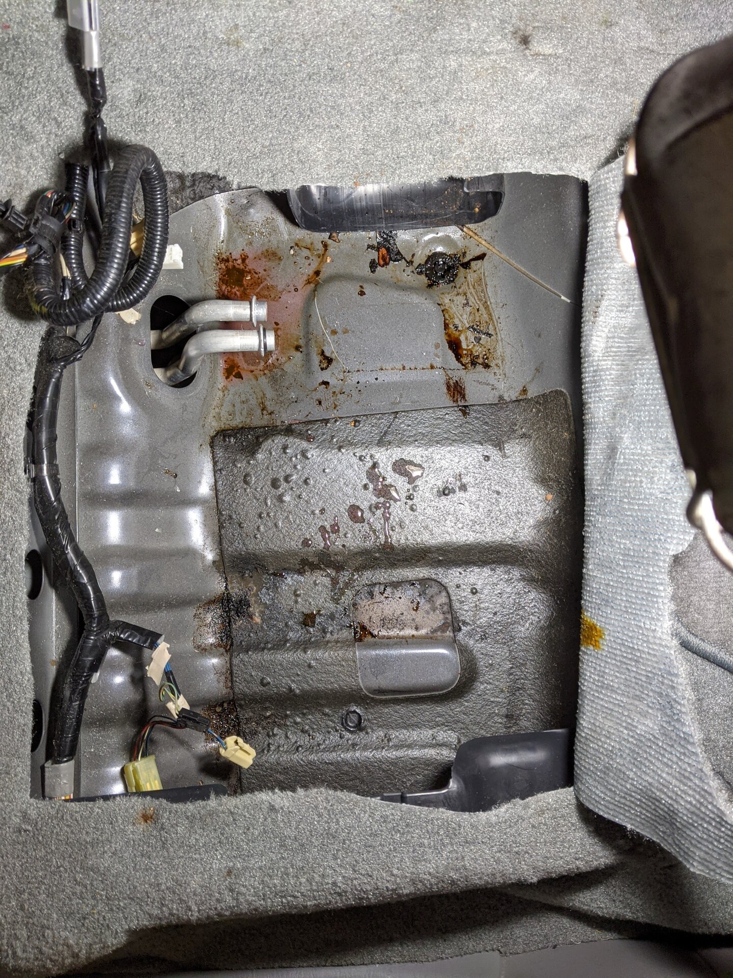

I'm getting some seeping from the hoses at the t connection, t's aren't very old and seem fine but I'm assuming hoses/clamps need replaced. Instead of ordering all the hoses, clamps and t's I'd like to bypass as I have not and probably will never use rear heat. Feel like I've seen this done on here but the only thing I'm finding in search is for 80s. Assuming it's the same concept, just wondering if anyone has any suggestions on what u shaped hoses to use.
Some 100’s were optioned without a rear heater. Here’s a pic of the hose configuration on mine. I’ll post the hose part#’s
Bypass that sucker, and all those connections just waiting to leave you stranded somewhere;)
87245-6A070 and 87245-6A060.
You can also remove the T where the rear heater lines connect to the main heater lines at the back of the engine and replace the T with a straight connection. 5/8" brass hose repair coupling fits. Fix box stores also carry 5/8" plastic hose repair couplings but I'm not sure how they would stand up to the heat of the coolant. This is the easy fix if your rear heater lines of heater starts leaking and you don't have access to the OE heater lines designed for vehicles without the rear heater.
