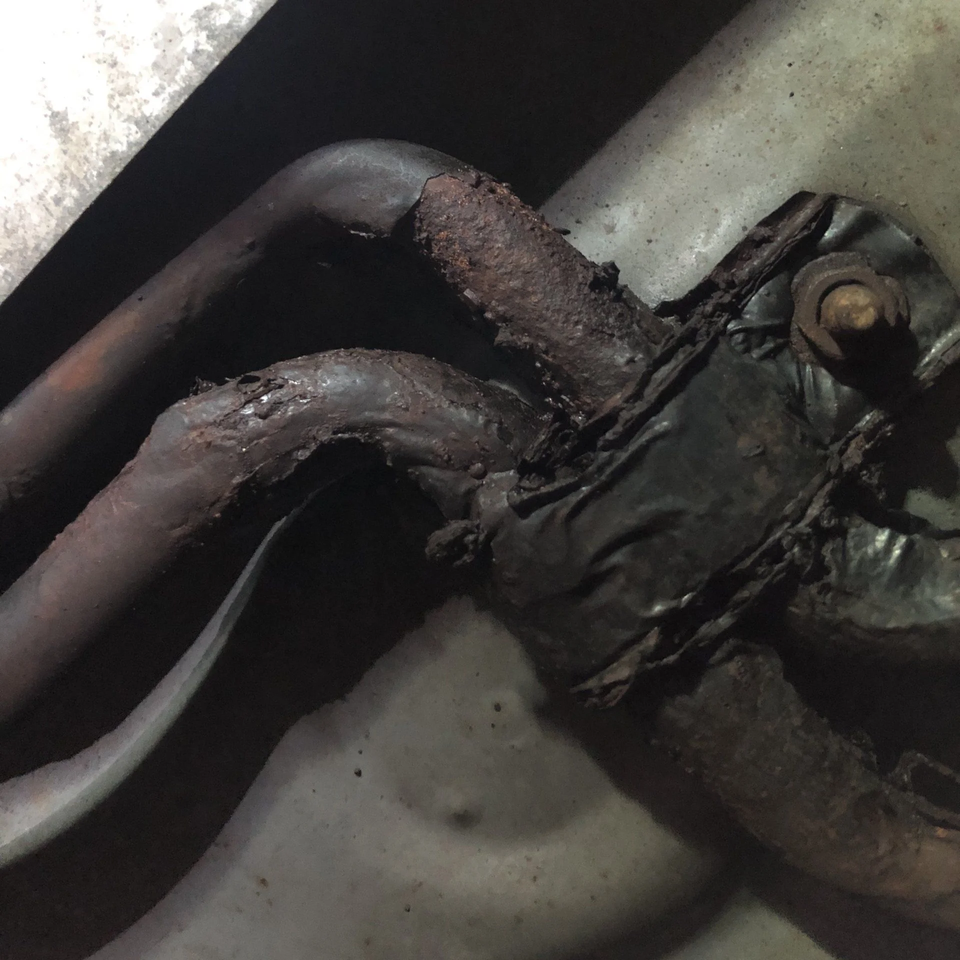

I needed to tackle some deferred maintenance before a lengthy fly fishing road trip, and I found this mess under the truck. It's part of the rear heater lines and just one section that was completely deteriorating.

Anyway, this obviously looked like it was ready to fail any day now. And I don’t have time to hassle with the full rear heater line replacement so I ran the bypass. I picked up the molded bypass hose from a place called Land Cruiser Products - LCP. They sold a simple solution and thats what I was in the market for. :)
Started with this:

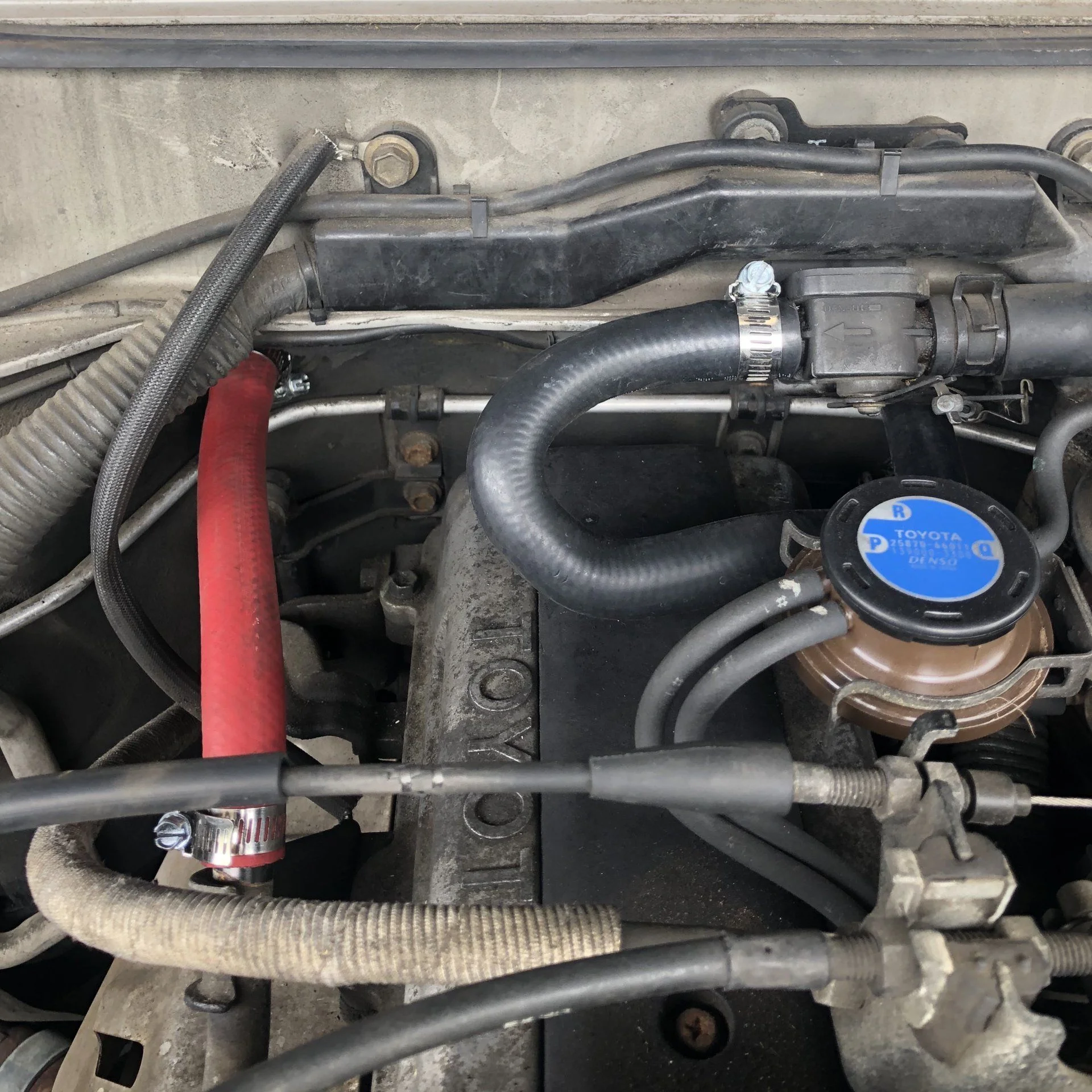

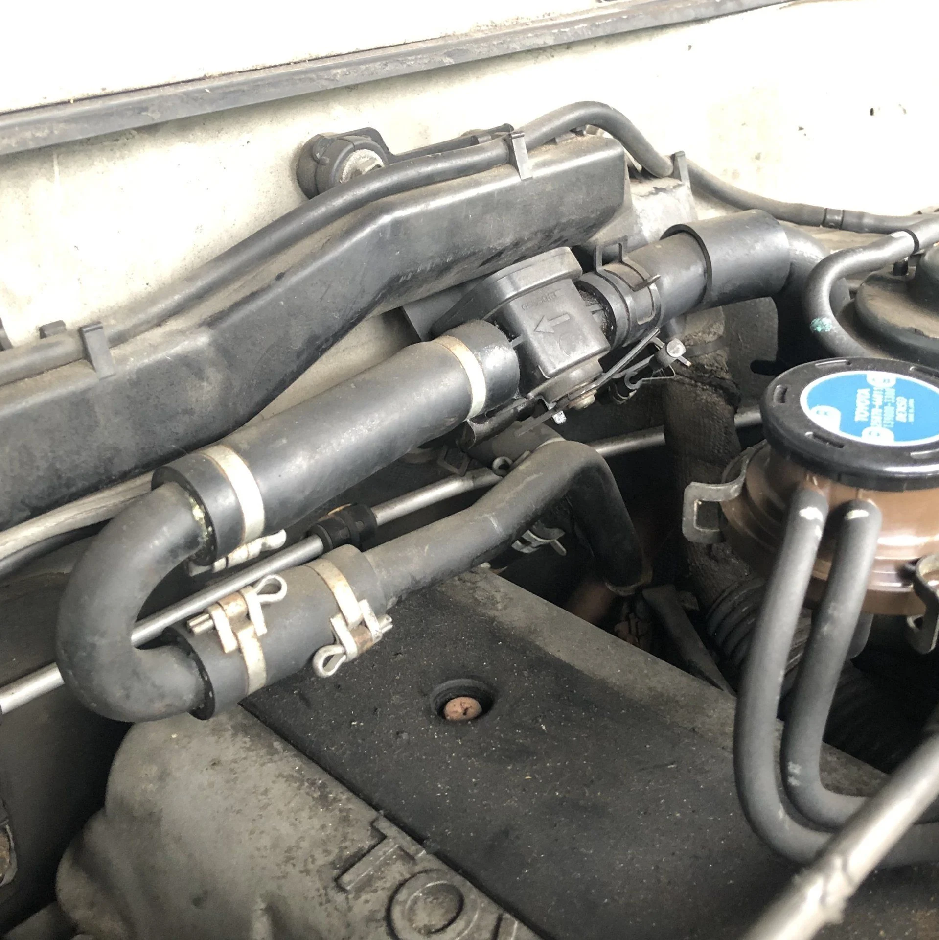

Ended with this:
1987490
Admittedly, it took way longer than I’d planned to get the old hoses out but the new hoses went in really easily.

  • Regarding my red Napa auto parts hose...is this stuff junk? It was super cheap and also one of the only hoses I could find around town. I googled it but can’t find any info.

If you're going to leave the rear heater in the truck, There is a connector on the floor near it that you can disconnect, or disconnect the dash switch so no one could turn it on, or pull its fuse (if it is on its own, and will not kill anything else obviously). I would try and get the coolant out of it (maybe a necked down shop vac)? you could shoot compressed air into the end of a line, but that will get messy.
To get the hardlines out in one piece and install new ones, there is affair bit of stuff that has to get pulled. They are 1 piece molded lines that hug the floor pan and firewall.
No idea on the red napa hose.
Even though the rear heater won’t blow warm air while I’ve got the bypass in...and until I find time to do the full rear heater piping replacement, I like the idea of using it as a fan/blower.
Any harm running it while the coolant lines are bypassed?
I honestly have no idea. I think it should be fine as a "blower" only, but not sure.
You can run the blower. It is just a tiny radiator with a fan on it.
You could flush it with distilled water, then use compressed air to blow it out to dry it, then cap the line if you intend to use it again some day. However, leaving antifreeze in it will inhibit corrosion. It just won't be under pressure or risk you blowing line and overheating your engine.
The more I think about it, flush it with CLEAN antifreeze and cap the lines. That will inhibit corrosion and it will remove debris to make it better while it sits.

All hoses should be oem or Gates Green Stripe.
