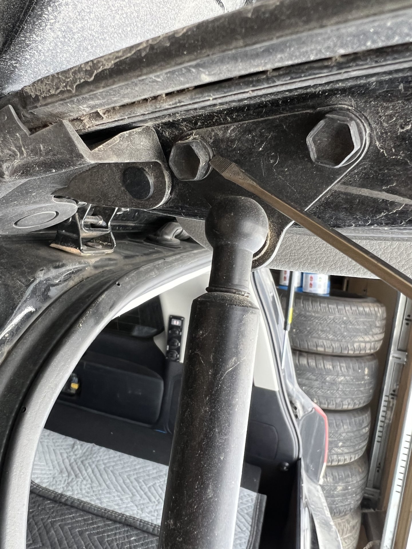

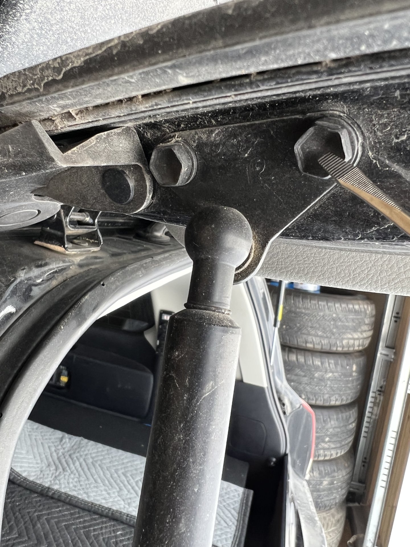

My rear struts are failing as well. Bought a set off ebay, and tried to replace it 1-2 years ago, could loosen the bolts. Tight as heck, so I gave up! I still have the "new struts" in its packaging. Also can't exactly remember, but I recall there was a piece of trim getting in the way. Maybe I was taking off the wrong bolts?
Any one take pics by chance for which bolts to loosen?
I think there are two options, auto open/close and manual. I've only done the manual.
I'd have something handy to prop up the upper lift gate since once you remove one end of either side, the upper gate is likely to want to come down. Your noggin works in a pinch, but a length of scrap wood, broomstick, curtain rod, etc. might be more elegant.
Note, I changed them on my '13, the ones above on my '16 are original.
LX's or LC's with the auto lift gate will have the safety trim around the outside that blocks access to the upper bolts. I haven't seen one up close to look at how to displace the trim.

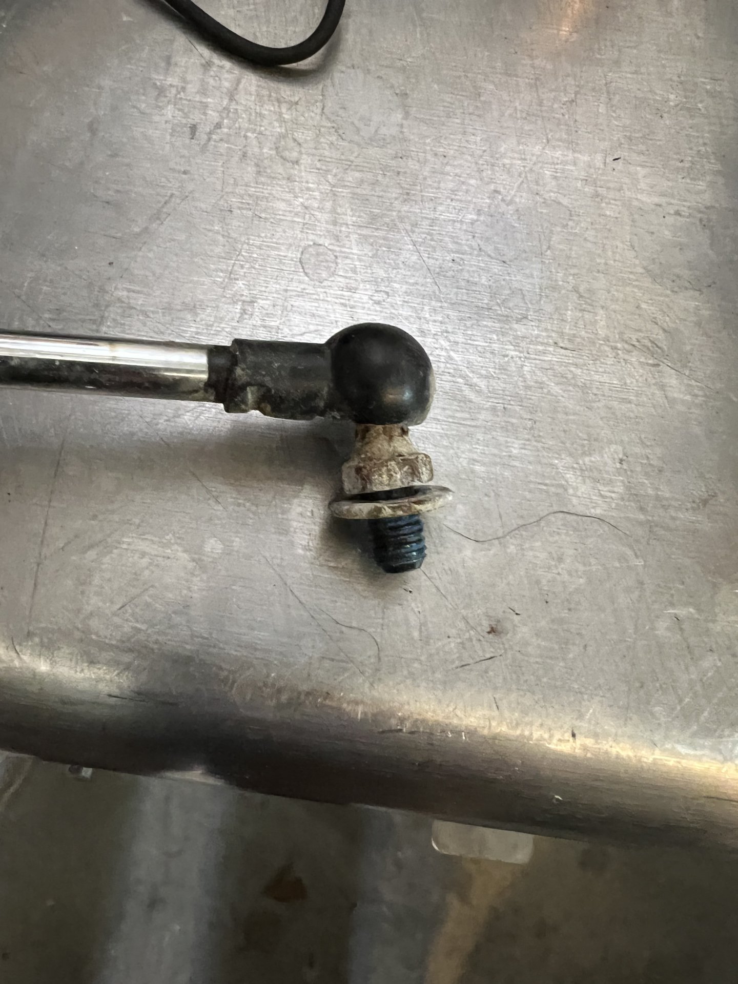

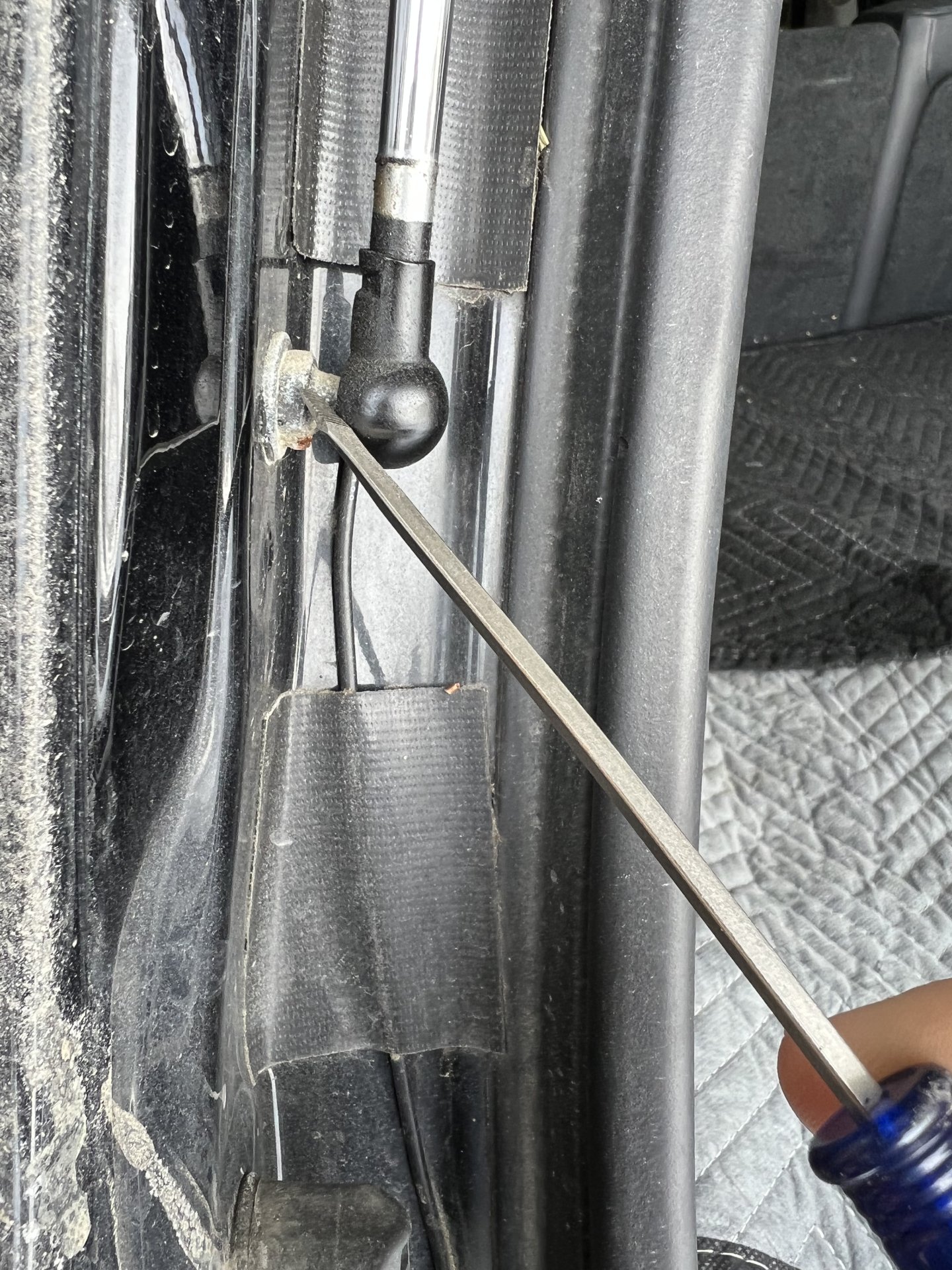

View attachment 2924845View attachment 2924848View attachment 2924849View attachment 2924850
Super helpful, thanks!
Were your bolts difficult to remove? Did you soak them in WD40 by chance? Did you use a 12mm open wrench as @airforce1 stated a few posts above?
The LX570 trim piece that interferes with removing the two upper bolts can be loosened with a torx bit (T-25) and will move just enough to attach a socket.
