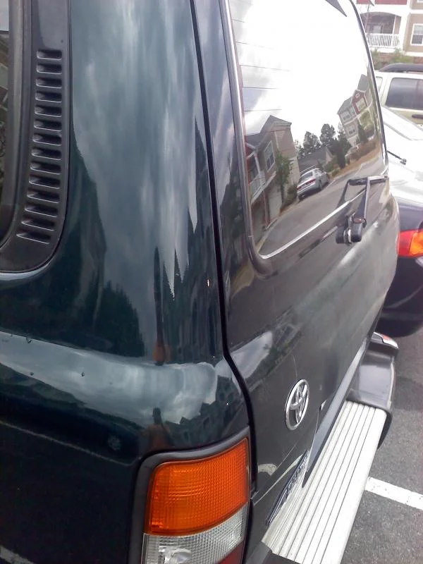

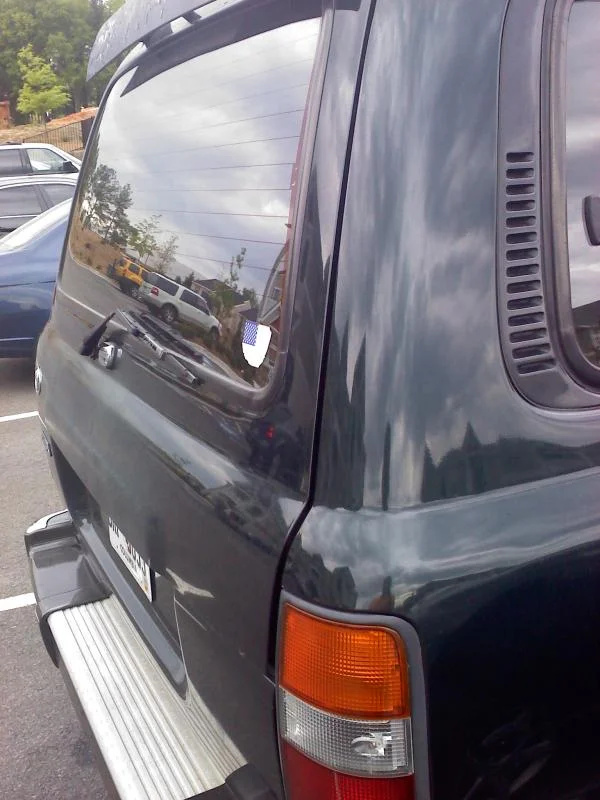

Is anyone else having this issue? Any ideas? I am also dealing with a rattling noise from the lower lift gate. I don't know why this bothers me so much...Thank you guys!
It looks like your lower tail gate is bent in the middle. It is a common problem on the 80 from kneeling on the open gate. Some people have bent it back and reinforced it with a thick aluminum plate. Mine looks the same as yours. This has been on my to do list for a while now.
My '97 has the same problem, same color too.:D I've loosened and adjusted the mounting points and it's a little bit better but I'm not satisfied yet. My next move is to replace the bolts on the latch/striker plate which will allow the hatch to close tighter.
It's the weirdest thing you know? I can't seem to figure out where it's getting caught. I think it IS the lower tail gate since that is the only place that I can't really see whether or not contact is being made.
How can you tell that the lower gate is bent? I don't see it... :confused:
Pretty sure that fit is just an 80 thing. My gate is straight and my old hatch was just like yours. Put a new hatch on and same thing. Tried adjusting and all that did was make the hatch harder to close.

Mine looks the same, I wouldn't worry about it.

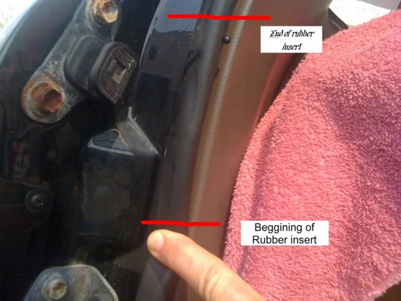

I just discovered it few months ago. The gasket around the door is hollow. Except that there is a piece inside about 5" that suppose to be where the upper tail gate is closing to cushion the the upper door. It seats ABOVE the lower tail gate.
It is held by glue and with age it may have loosen up. The 5" thick material then slide down inside the gasket. It makes the lower gate not close all the way and the upper tail gate not closing correctly. Once I discovered it, I worked that 5" piece back into position and it is held by a pin right now. Mine did it only on one side.
I hope what I wrote makes sense.... I can't really take a picture of what inside the gasket, you need to feel it.

Attached is the length of the rubber insert. If you look at the shape of the tail gate, you can see how if this strip slides down, it interfere with the tail gate closing.
It is pinned in place now so it will not slide down again. this is a temp solution and the pin started to rust. I have to figure something more permanent. It drove me crazy for 3.5 years until Kevin from Wagongear figure it out while working on my tail gate.
I think both rubber pieces need to be where my picture shows. It is there to cushion the closing of the upper tail gate and has to be above a certain level as to not interfere with the lower tailgate.
When both pieces are positioning correctly, you get a nice positive, not harsh, feeling of closing the upper tail gate. If you don't have both, closing the upper with a thunk does not cushion by both sides and it does not feel as good/right.
